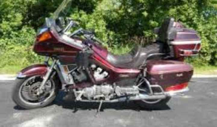

  1. That guy was pretty squirrely and when I talked to him on the phone he kept saying it was a '90 but the listing showed '89. Good catch, @cimmer!!! I think ur right, @luvmy40. It's a crap shoot and integrity is harder to come by any more. I think the engine might have been solid & looks aren't everything, @larrydr but after pouring so much time & effort into my '83 I just don't have it in me. Plus the degree of damage to all the plastics I'd probably have to buy a parts bike as my skills on that kind of plastic repair are wanting. Ironically enough, he relisted it for the same asking price but included a Sprinter car with the deal! Sadly, he's just desperate for money. BTW, he DID say he'd transport it for anyone who's in the area (it's about 15-20 min from Terre Haute).

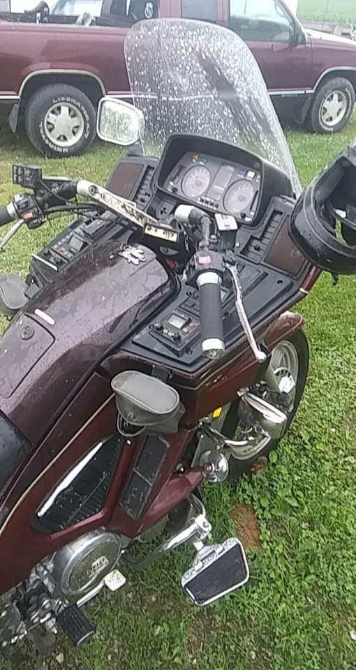

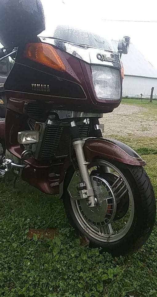

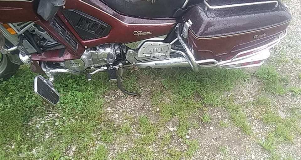

  2. Well... the trailer is empty. Drove over an hour and had a good time with the missus but I just couldn't pull the trigger. While I would have loved to have used @skydoc_17 checklist, (thx BTW!!!) but cosmetically it was in pretty rough shape and as difficult as it was to get up and running "decently", it just wasn't what I thought I was getting into. The images he sent were apparently from when he first obtained the bike years ago which soured me right off the bat. While most of the plastics were present, they were pretty mistreated, especially the black plastic around the CB (nearly destroyed) and multiple areas of chunks missing from them. Left rear saddlebag with large crack through almost the entire top, crappy repair on trunk with water inside. It had been left outside for some time and multiple areas of rust on the chrome. Numerous items missing (parts not on my '83) and even more numerous oversized screws in areas that had wallowed out the holes (including the airbox). Dash was in rough shape and discolored and oil light error (I believe) was on. Clutch lever missing and for some reason the clutch line was transferred to the front brake (somehow to "diagnose" the m/c issue). Seat was completely trashed and multiple tears on the passenger "armrests". Engine looked remarkably clean and no apparent leaks (except clutch fluid from m/c he had already pointed out). Required heavy choke to start and still some to keep running even after warming up. Couple faint backfires when revved up until warm. I question the carb rebuild & if someone actually did it and a carb sync (said he paid $400 for carb work) I would have expected it to run much, much smoother. By comparison, I think this '89 with 39k on the odometer vs my '83 with 69k on it would have been a step backwards. I'm not saying it couldn't be brought back to life but I poured many an hour into my '83 and was essentially an absent father for almost 2 months getting her to where she is now and I just can't justify doing that again. Now if someone needs a bike with a good motor (I would LOVE to ride a bike with 2nd gear!) and has the time and patience I can connect you with him. He posted it for $1200 but even before showing up said he'd take $800 but I know he'd accept a little less. He even offered to meet someone a reasonable distance for the price of gas. Obviously he's pretty desperate! Thx to all who responded to my request for input and still thankful for the "adventure". Looks like it's time to put that new clutch in the '83!

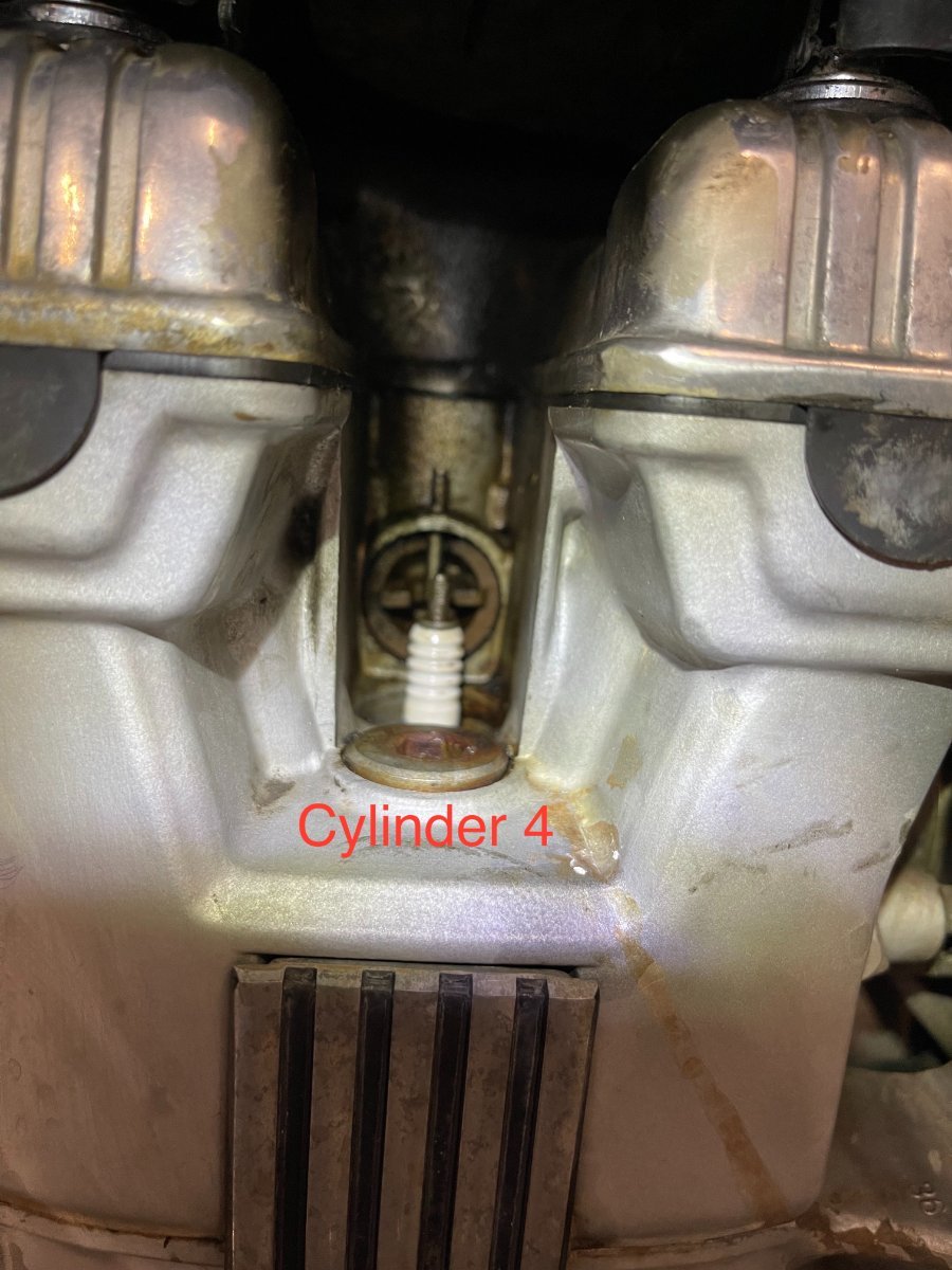

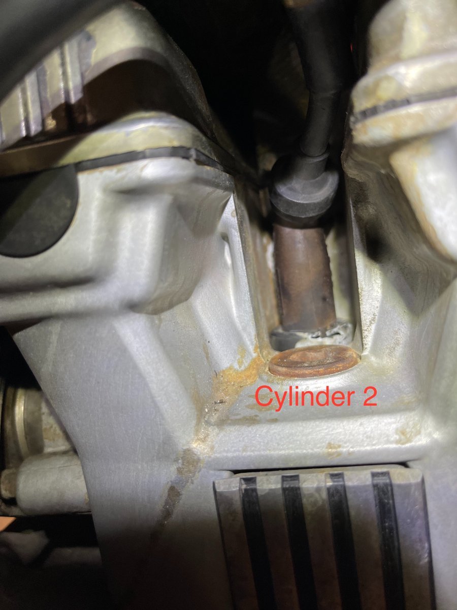

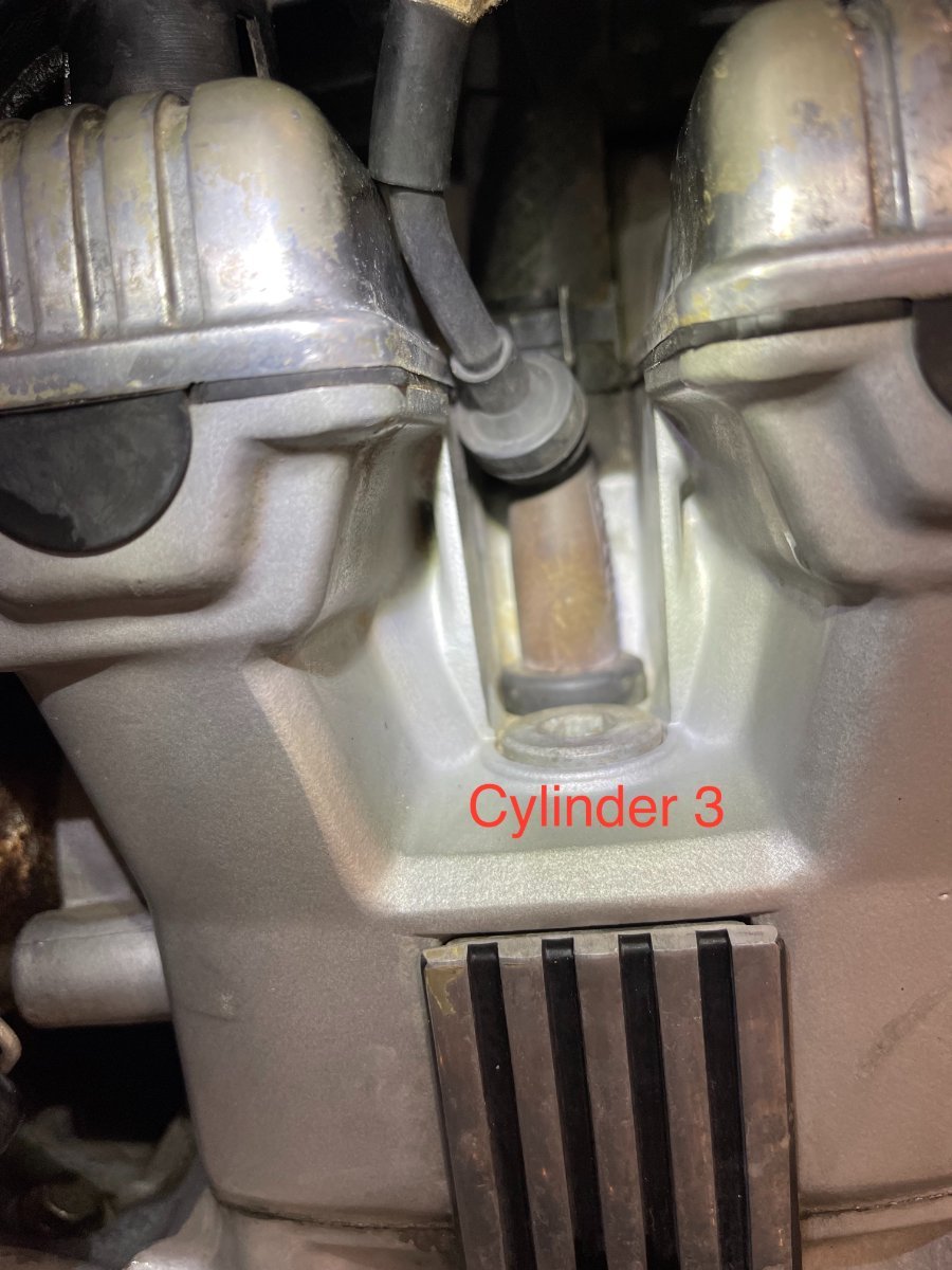

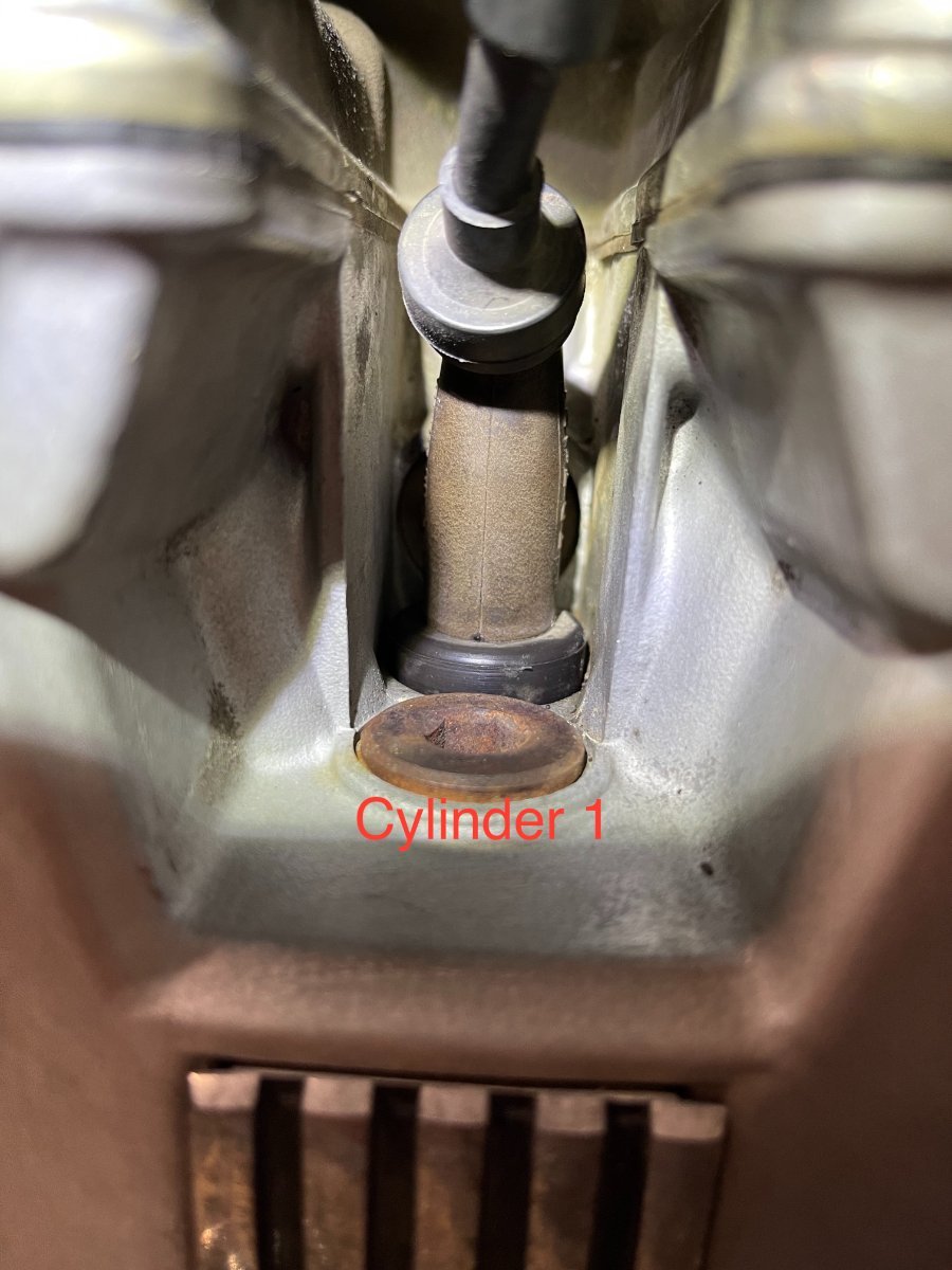

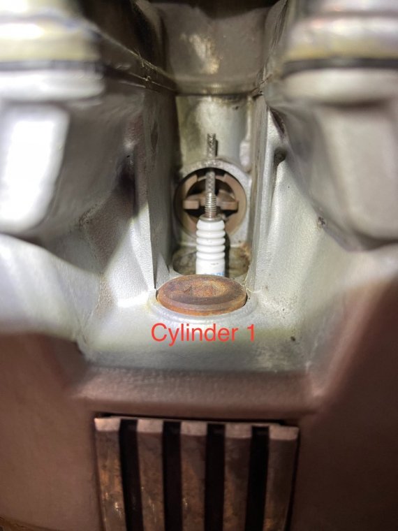

  5. Well, GOOD NEWS! While researching where in tarnation this TCI unit is and thinking I'd clean its contacts I stumbled on THIS thread from 2016. Specifically saw Yamagirl's post #7 where she encouraged inspecting the connector on the left side under the seat that goes to the pick up coils. There were 3 plugs there and all three were severely corroded however the plug going to the pick up coils also had a connector that had been pushed part way out of the plug probably making poor contact as well. After cleaning all 3 and applying dielectric grease I held my breath and BAM! Started up almost immediately and with NO CHOKE! Knowing my luck, I wasn't ready to stop especially with all the issues I've heard about the connections going to the TCI unit so I dove into that as well. Definitely not the easiest thing to get to but since I had just cleaned the carbs on Friday I was comfortable pulling the airbox off and the battery box wasn't too difficult. Of course I pulled all connectors and cleaned and greased all the connections that I encountered. Sure enough, horrible corrosion on both of the TCI plugs and one of the contacts had apparently arced at one point with very slight burn on the connector. For some reason there was water on the connectors so I'm not sure where that came from. Took it for a quick spin up the street & I know there's the "I fixed something so it runs so much better" mentality but I seriously don't think it's run this well since I got it. I've started it 3 times now cold with no choke and starts immediately. I know that doesn't solve the burned #2 cap and the wet #4 cap but at least she runs!!! The only bad news is I also did the master cylinder rebuild tonight as my first post in this thread indicated a locking up of the brakes (possibly overfilled MC?) but also the propensity for the rear brake pedal to not return upwards (I've cleared the return hole twice already). I purged the lines by "back bleeding" as the fluid was replaced less than a couple of months ago. Filled the reservoir and bled the rear and then the front until no bubbles (probably upwards of 20+ bleeds each). Unfortunately the pedal still doesn't want to return to the full upwards position. I know CowPuc has a video of bleeding the metering valve at the stem but despite hitting it with PB Blaster on more than one occasion I can't crack that fitting to save my life. I might give it a try again although last time I torqued it so much the metering valve started to rotate so I'm worried I'm going to damage it or one of the lines. Either way, I'll bleed them again tomorrow as it's nearly 6am here and I'm apparently rambling more than I usually do! A special thanks to all who have chimed in giving me directions and especially @Patch for his expertise, patience and guidance. One thing's for certain, I wouldn't have a bike still if it wasn't for this forum and all of your guy's support!
  6. @Patch, shouldn't you be out partying it up? Of course here it's only just 11:30 here so the night might be young where you are! So the orange and red/white stripe wires are on the coil side of the plug. The 4 different colored wires were on the sides leading TO the coils. Sorry if I didn't clearly indicate that. You didn't say to unplug the coil but I just assumed and since I was cleaning the contacts and applying dielectric grease it just made sense to me. The spark on all 4 cylinders were similar ("20" on my tester which looks less than 20mm but definitely greater than the 6mm minimum) so yes, it appears all the coils are firing and if I'm testing correctly the ohm test confirms the primaries functioning as well. I've not tried to "baby" it to life since I parked it a little over a week ago. Like I said, it'll start but definitely struggles and seems like it's only firing on a couple of cylinders (to my ignorant mind!). Everything has therefore been done on a cold engine. I can try to get it running but not sure how to test if it is "charging". I've not had to put it on a battery charger except after I tried to start it after cleaning the carbs therefore if you're talking battery charging from the alternator, yes it appears to be charging the battery. With the multimeter set on 20k, I've placed one lead on both the orange and the red/white stripe wire from the back and the front of the plug with the other lead on the spark plug cap terminal. As you indicated I'm sure they're not open but again feel like a boob that I can't test them appropriately. While I didn't ask him specifically and neither did he share, the previous owner most likely didn't rejet it himself and he purchased it from his brother-in-law so at least he knew the history going back to the first owner. Again, that doesn't mean it WASN'T rejetted but it didn't sound like that was the case. I was already looking at a borescope/endoscope which might enable me to look within the cylinder but as this seemed to be a sudden onset I'm not sure if investigating in this manner would benefit me (other than having a "cool" toy!). While I can check with a local bike shop, we've only got one in our small town & he acted like they were slammed and will likely be disinclined to allow me to borrow a compression tester (unless I can "borrow" one from O'Reilly's, AutoZone or Advance Auto). Attached are the pics of the cylinders with boots on & off. #2 is the burned one & #4 is the "oily" or dirty one. #1 & #3 look "old" or worn but nothing outstanding (to my untrained eye). Should I go ahead & pull the plugs to investigate further? As I mentioned I have new plugs on hand and new wires & caps/boots that should be here before week's end. I can install the plugs now & add the wires and caps when they arrive. If I'm getting ahead of myself I will hold off. Thx!!!
  7. Spark testing revealed “20” on all 4 cylinders. While my tester has markings for 10, 20, 30 & 40, the distance between the 20 and 30 appears twice the distance between 10-20 and 30-40 however when I split the distance none bridged the gap. On the same page in the service manual (yes, I missed it!), it appears they indicate the minimum spark gap is 6mm so I guess that's a good sign. On the primary coil test I got 3.3, 3.6, 3.5 & 3.4 respectively on 1-4. I tested #1 twice and got 3.6 on second test. The manual indicates 2.7 ohms +/- 10% so I'm above the 2.97. Admittedly I may have not done specifically what you've asked, @Patch so let me know if I need to redo the testing. I unplugged each coil and inserted the leads into the back of the coil side plug which were all orange wires and red/white stripe wires. I assumed the colored wires wouldn't test the coils unless I was to leave the plugs intact. I'm trying to test the secondaries but must be doing it wrong. I'm placing 1 lead on the orange wire at the plug and the second lead in the plug cap (also tried the red/white stripe wire). I'm not getting any reading whatsoever (I've tested 3 of the 4 with no reading). I set the multimeter at 200 ohms for the primary and set it at 20k for the secondary testing. Sorry to be the pest with such basic testing but again, thx for your help.

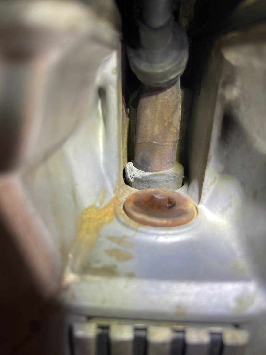

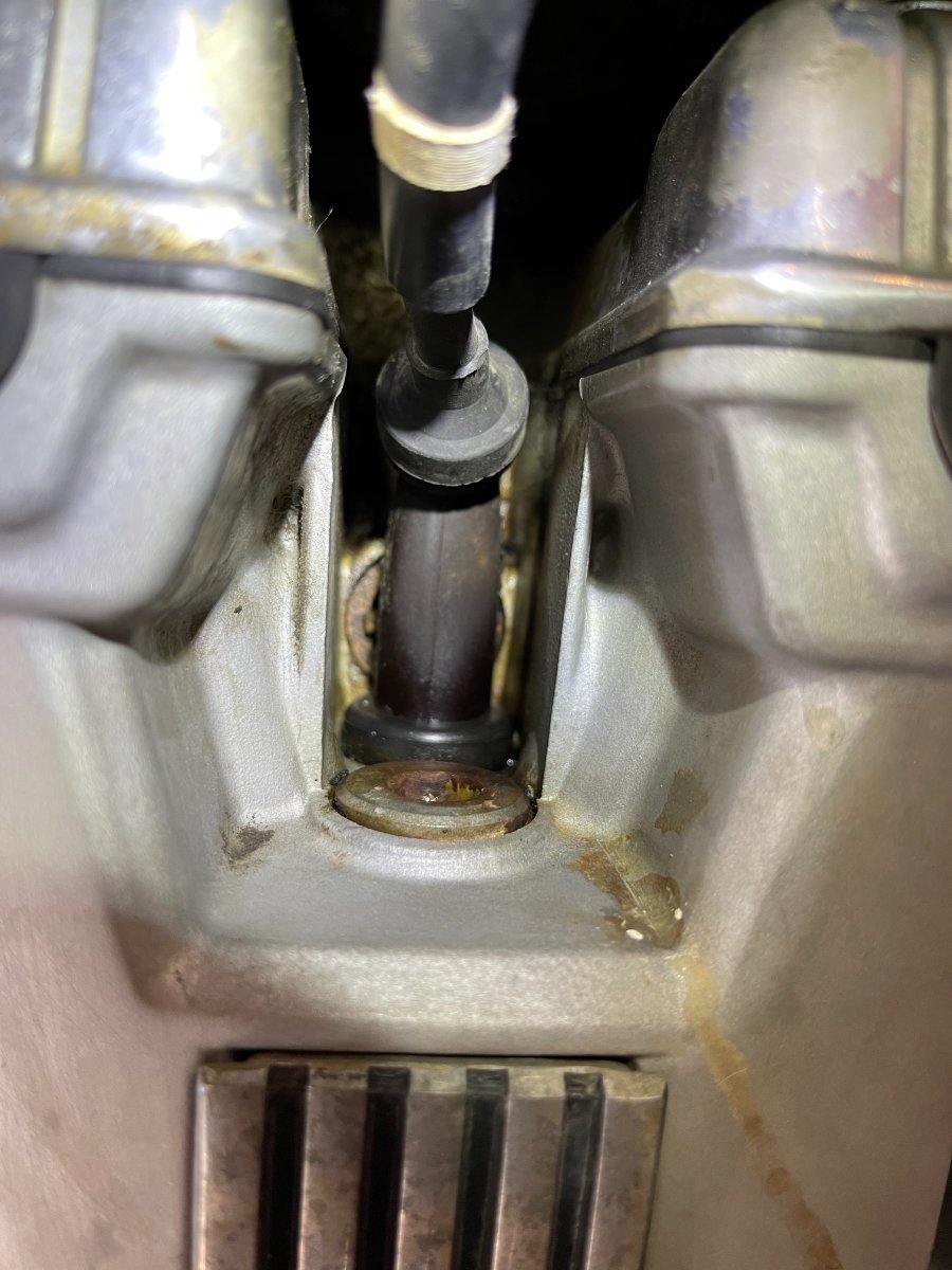

  10. Thx so much for the thorough explanation, @Patch. I think it's readily apparent you've probably forgotten more than I've ever know about engines! After reading it a couple of times my peabrain is starting to conceptualize. I guess I had always assumed backfire was the "gunshot" sound from the exhaust and this was distinctly different. Nonetheless I'm thankful we're working towards the goal of just getting her running. I know you're not looking for praise, Patch but you sound like a heck of a guy. Not just for what you've done for me but your obvious willingness to help others expecting nothing in return. Just started inspecting again. You weren't kidding when you said the coils "will take a bit of work to get to"! I'm hoping I don't need to do a teardown to get to them but man, that's tight (coils AND wires!)! Before I went any further and since they were easy to get to I looked at the plugs. The #2 plug (front, left side while sitting on the bike, right?) and saw what looked like a burn mark angling across the plug and the "gasket" at the base appears melted (see pics). The termination of the wire within the plug doesn't appear charred and the spark plug looks fine. I DID replace the plugs a little over a month ago & while I can't guarantee it, I don't remember seeing this burn. I also saw that #4 (front, right?) and noticed the base of the plug and the cavity around it appeared wet and dirty by comparison to the others. I'm not sure if either of these observances indicate anything but thought I'd throw it out there as we all know I'll have a bunch more to ramble on about when I actually pull out the multimeter!
