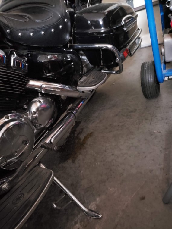

So my local dealership won’t work on my bike because they say it’s too old 2004. But they referred me to a guy they said did their overflow and had been in business 18 years. Bonus points for being even closer than the dealership. So here’s where everything goes sideways. I wanted a new front tire and all fluids changed. I also had a problem with the shifter where it had a broken bolt. So I drop my bike off and he calls me in about a week and says bike is done 600.00 he tells me he had to remove the exhaust and some other things to get to where the bolt broke off and then drill it out and retap the hole, thus the extra labor. So ok I don’t care I just wanted my bike so I could ride. I rode it home and parked it in garage. That night my wife sends me a picture of the bike with a puddle of new oil underneath. Next day I call the mechanic and he says it needs a gasket that he will order and put it on while I wait no problem. 2 weeks of telling me the gasket hasn’t come in yet. I ordered it myself and be here in 3 to 5 days. Now he tells me I don’t need gasket, he says the case cover was damaged maybe by a thrown chain at some point? And I’m like dude you been telling me for 2 weeks I need a gasket. I say I just want it fixed and now he won’t Respond so WTF I guess I’m gonna have to figure it out. What the hell is wrong with people providing good service these days?

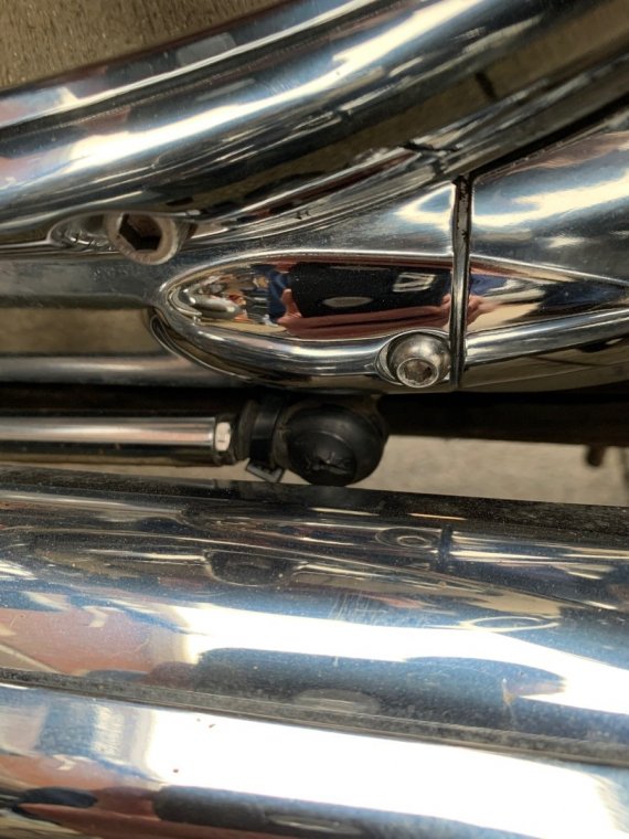

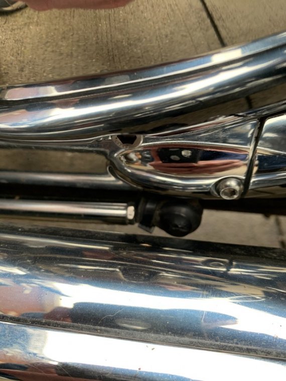

Well it’s not stripped out but it is broken off of course just enough where I can’t get to it to get it out. The zip ties were holding the broken screw in the shaft so it would shift . -

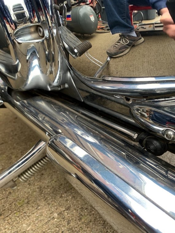

I thought he said the screw had maybe vibrated out . But looking at the pic I took it looks like there’s one in there. It does look as if the boot is not in line with the linkage on the front side. It was shifting as I rode it home that day but it doesn’t look like anything I want to leave like that. -
I’m posting some pictures and maybe someone can tell me what I’m looking at and how big a job is it to fix. So when I purchased the bike the previous owner said he had rigged the linkage one day after going for a ride it had stopped shifting. He used a zip tie from what I can tell. So did it loose a screw or what actually holds it in place I can’t tell from looking, but it doesn’t look like I would trust it for long. So I’m gonna post these pics and say it’s at the end of a long rod connected to the shifter linkage in between the frame and exhaust.
