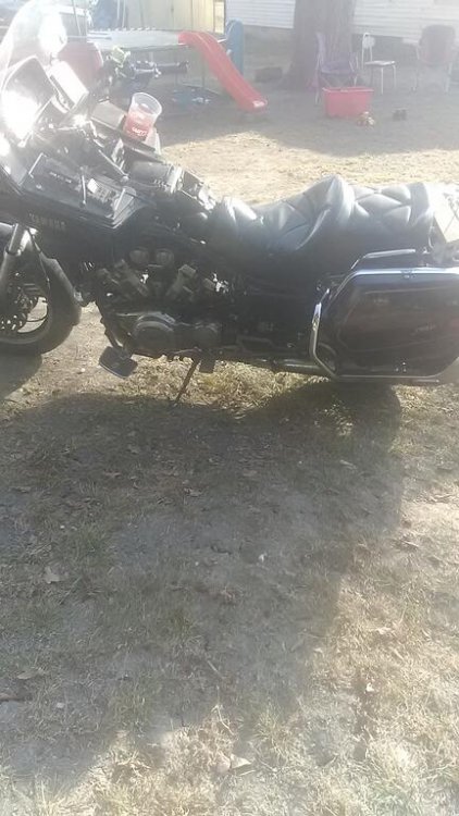

  5. Seen the bike on Craigslist really cheap. We were looking for at goldwings. Like how it looked but no #2 gear. Looking up how hard it was to repair. Seen some of Puc Puc youtube post he talked about VR forum. Anyway I asked about repairing and the price kept dropping. Was getting a scared. Told buy it and skip 2 gear. 3/10/2020. We love the bike. Put over 6k miles on her. Now she is on the stand with a milkshake. But we will definitely fix her.
  6. Got the pressure tester. Got her parked in the backyard so she can see the road. Got to spray her off. Drain the last of the oil & water. Let y'all know what I find.

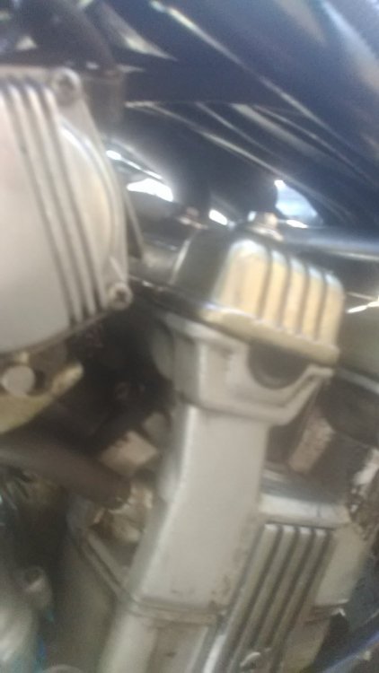

  8. Thank you puc. That may be the problem. Posted a picture of the area that is greasy. First oil change no water in oil. But the air cleaner had a milkshake in it. So I cleaned the twinky box. Thought that was the problem Had a small drip. Added gasket sealer waited a hour then I torked it down. Replaced fluids. That when I got the full milkshake . There's a water jacket there. It goes thru The cam chain . So I hope it's the o-rings. I carry that many tools with me too. Been up watching videos all night.
  9. top picture that is the only place that is greasy.
  10. It's water for sure. Left rear plug area wet and oily. valve cover discolored from others

  13. Been trying to load pictures . left rear of motor is where oil and grim is. Valve cover area is like a gold color. Other 3 silver color. Stopping now before I break something. Getting frustrated w/ phone/ pictures thing.
  14. So here's is what I got so far. Pulled the plugs. Left rear has water on it . Lot of oil and moisture around carb,boot and valve cover area only.( left rear).
