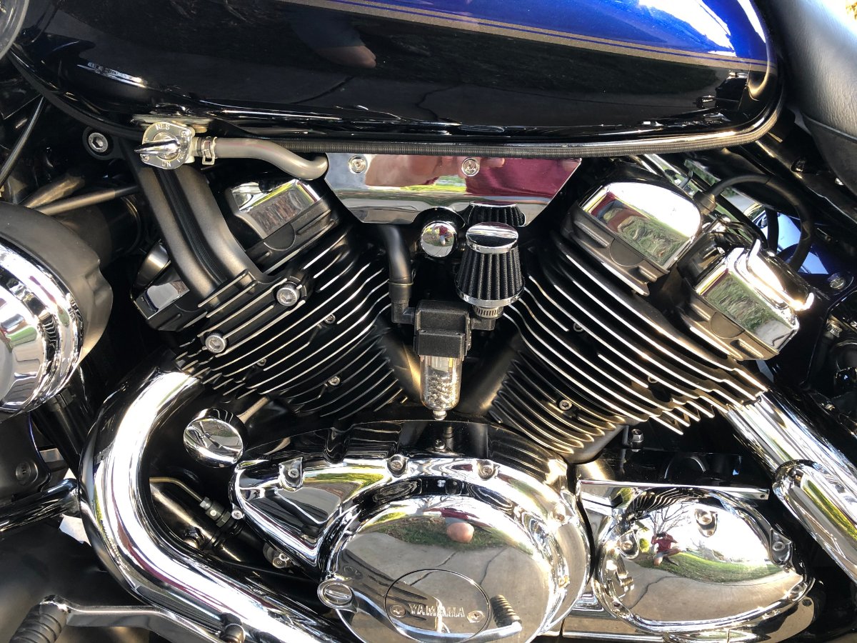

Positive Crankcase Ventilation
circa1968 replied to Monsta's topic in Royal Star Venture Tech Talk ('99 - '13)
Hope its ok to revive this old thread! Pic attached of what I just installed to capture oil and vent the crank case. The intake port @ the airbox, where the hose was attached, has been capped. This is on the left side of the bike, so aesthetically, my girl now has a good side and a less good side.... This was sorta proof of concept and now plan to see if it can somehow be at least partially hidden but still accessible enough to eventually drain any collected gunk. I think I will also paint the collector bottle black, save for a small window to watch the level of what's collected. That might make it disappear a little better. And yes, subjectively, she runs super, IMHO. (Note: I also just had the carbs rebuilt and this was done at the same time I re-installed the carbs so can't really give a good before/after take on it). Biggest goal for me was not to turn my beautiful new carbs into another gunked up mess. Now, here's the interesting part: I also just changed the oil and filled to the max line! (I know, a sin here) Yes, a bit of oil blows out & is caught in the collector bottle but guess what? Oddly with the oil at the max level, to my ears the clutch whine is much less noticeable (again subjective, I know). Does that make sense? I read an older post here about a guy doing some anecdotal testing and he found that lack of oil in the clutch box contributed to the whine so he ran an extra oil line to the clutch box and swore it significantly reduced the whine. Would that extra little bit of oil fill in the crankcase, from 1/2 way between the lines to top of the line, make enough difference in oil pressure or splash around, or whatever voodoo oil magic happens inside of there, to reduce the whine? -

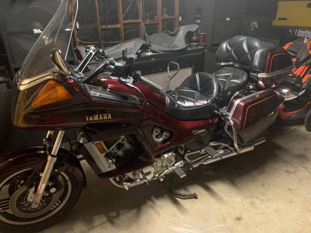

	So, spent the last hour, or so, reading about 2nd gear and cracked frames on '83. 2nd gear thing kinda sucks but can live with that when it goes (if not already). Is that more or less a sure thing & just a matter of time? Any lucky '83 venture lottery winners out there who have not lost 2nd gear? I'm guessing not, based on the nature of it. Now, for the cracked frames. That doesn't just kinda suck. Don't think I could live with that. How big of a problem was this? I would not be looking at taking this bike on as a project. @cowpuc I know you're the guru of guru's on this bike and would love your take on the cracked frame issue. I suppose that if it came down to it and the frame cracked on me at some point, I've got a parts bike and could probably recover a good portion of my original purchase price, given the very good condition of the rest of the bike.
	My wife hasn't exactly said no, she just asked how she's going to fit her car in the garage with two motorcycles.... Oh, I'll find a way. Just talked to the seller, came his way via a will. It had been sitting since ~2007. He took it to a local shop for the carb rebuild and new tires. He did the brakes himself. He said the battery light stays on, so needs the resistor mod (no big deal) and says the temp gauge runs right up to red before the fan kicks on. I've read on other threads that is normal for an '83, yes? He said the body plastics are in like new condition, no cracks. Another picture showing the seat, etc in very good condition.
	Thanks. Yes, I've learned the hard way to leave the carbs to the pros! (haha, no more carb work for me!). The ad pics aren't the greatest, so hard to tell condition of plastics. I see one area that has either scratches, cracks or just a light reflection. I've reached out to the seller to get more info on the bike.

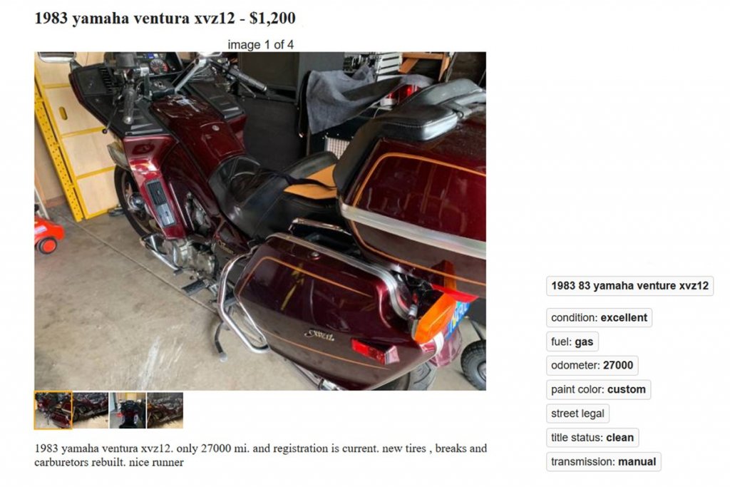

	Still waiting to get my '07 running right, just waiting on the rebuilt carbs. Of course, that gives me time to be looking at things I probably shouldn't be looking at, like this! For $1200, seems like a fair enough deal to try out the 1st gen for comparison. Any thoughts on what to look or watch out for? Of course, it looks too good to be true, so there's that....
