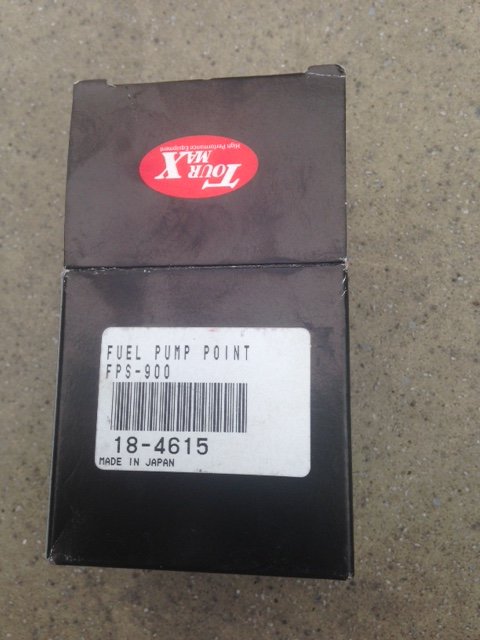

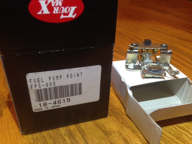

Amazon https://www.amazon.com/Supply-Universal-Point-Switch-18-4615/dp/B0034ZMVKU/ref=sr_1_1?keywords=K-L-Supply-Universal-Fuel-Pump-Point-Switch-Kit-18-4615&qid=1554654586&s=gateway&sr=8-1 Or Ebay https: https://www.ebay.com/itm/K-L-Universal-Fuel-Pump-Point-Switch-Kit-18-4615-Kawasaki-Yamaha-Honda/392240662545?epid=171162134&hash=item5b535d8811:g:LNwAAOSwGelcaD3P Minor Solder job needed. Suggest you use your phone to photo before and after close up of old and new point as I goofed the spring,,,, I think. But this is likely the problem. Mike G in SC -
Mark Shields has replaced points in several failed pumps. I tried once, it failed. I don't know if I sprung the points spring (easy to do) or if another component in the pump was bad. If I did it again, would take a pic of the old and new before swapping. But it's worth a try to get yourself a good spare (not a China knockoff). Here is same points part but from Amazon. A little cheaper. https://www.amazon.com/Supply-Universal-Point-Switch-18-4615/dp/B0034ZMVKU/ref=sr_1_1?ie=UTF8&qid=1547071182&sr=8-1&keywords=Point+Switch+Kit+-+18-4615

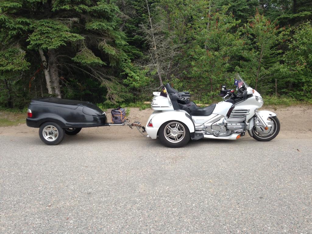

Actually,,, I got one of those big fiberglass trailers that looks like a Goldwing rear. I pull it behind my Goldwing (trike) rear. But good offer,, if someone else is looking. Actually GREAT offer.
