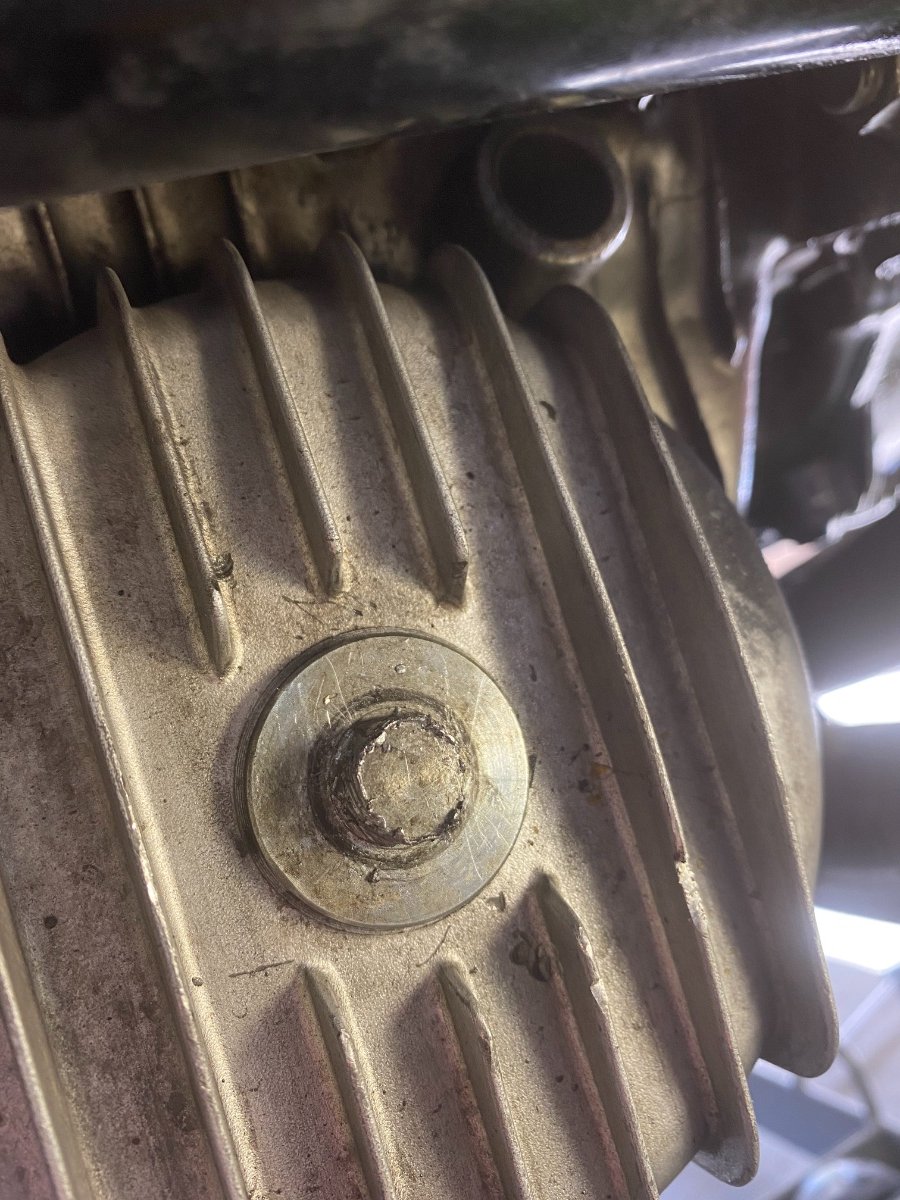

  2. It was for sure over tightened as I could barely get a socket on it to begin with. Figuring I was going to replace the bolt anyway the cost of the adapter is a wash. My local Yamaha dealer selling the bolt for $65, adapter to my door $70 plus the filter being half the price I came out even. Bolt is maybe salvageable so I’ll keep it with the cover in case someday myself or another member needs it.

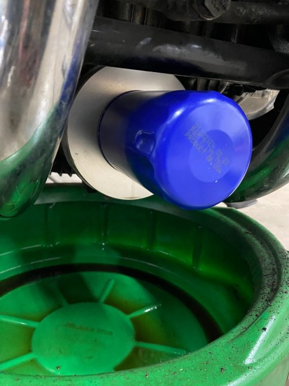

  6. Spin on adapter came in just a couple days and seems to be working perfectly with no leaks. To get the old bolt and cover off I bought an extractor set like @Midicat posted from Harbor freight https://www.harborfreight.com/38-in-drive-metric-bolt-extractor-socket-set-9-pc-67894.html the 12mm didn't grip but tapping the 11mm on it grabbed with the GI Joe Kung Fu Grip, used a 3/8 to 1/2 adapter and breaker bar and made short work of the whole process. I remember when I used one of those extractor sockets now, I know I used it on a lug nut on my Wrangler and I’d put money in I had rented it from my local auto store way back in the day. thanks all for the help.
  7. Well the USPS did me well I ordered a spin on oil filter adapter for my 87 just on Sunday night and it already showed up.

  17. Sounds like the right investment considering I’d be replacing it anyway. That bolt extractor kit looks wicked familiar to me but I can’t for the life or me place where I’ve used one. I didn’t find it in my Arsenal so maybe I borrowed one sometime. I have a kit for stripped screw heads but not hex.

  20. Probably because I don’t want to mess with time and time again. The spin on adapter looks like a fine alternative. Anybody else have good luck?

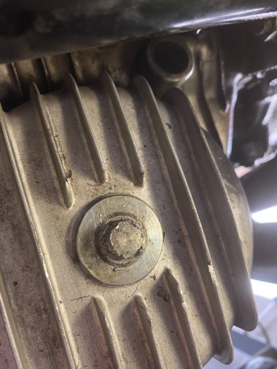

  21. The problem with vice grips or a pipe wrench is the fins on the cover. The bolt head is flush to below the plane of the fins. You can see on the right side I chewed some up not even knowing it till I saw the metal on the floor. I’m afraid if the cover is that soft I’ll break it.

  23. Thanks all! These are great suggestions. And holy crap that bolt is at lease $50.!! I’m going to get a replacement bolt in hand before I go any further, that way I can still ride albeit with a dirty filter. For today I’m gonna move onto the progressive spring swap that was the goal of yesterday before getting derailed.

  25. I posted in the tech forum but may as well ask here too cause it’s relevant and not bike specific. The filter cover bolt is stripped and using vice grips I started to damage the cover fins. Any tips?
