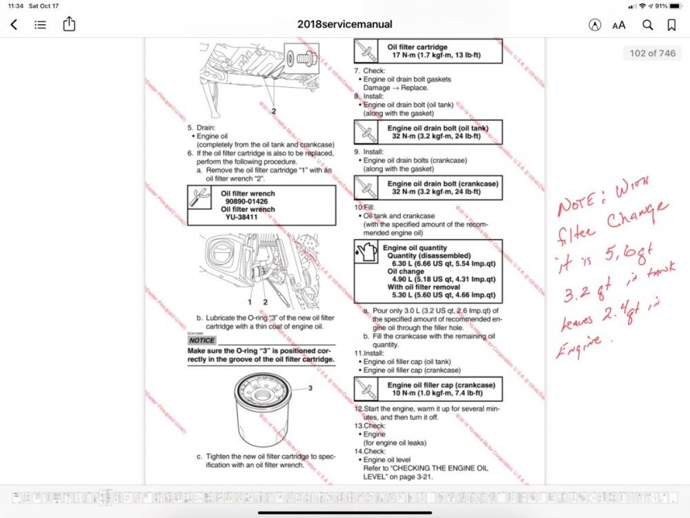

Star Venture Torque Specifications
ecbaatz replied to ecbaatz's topic in Star Venture and Eluder Tech Talk ( '18 - Present)
I understand the manual is on line, ( I have downloaded the copy to my computer, phone and iPad) but can be a pain to find the info. I also have the hard copy of the manual. I look at this two ways: 1) it is a cheat sheet. Quick reference. 2) it is like when I was RPPO (repair parts petty officer) any time I spent more then 30 minutes looking up a part I put it in my little green memorandum book so I didn’t waste time the next time I had to order the part. Granted you will learn new information as you look up the info you need but sometimes you don’t have the time to look it up. So whether it is used by anyone else, it is a quick reference for me (and a work in progress) that I thought someone might like. and no offense is taken, it is not for everyone. Eric -

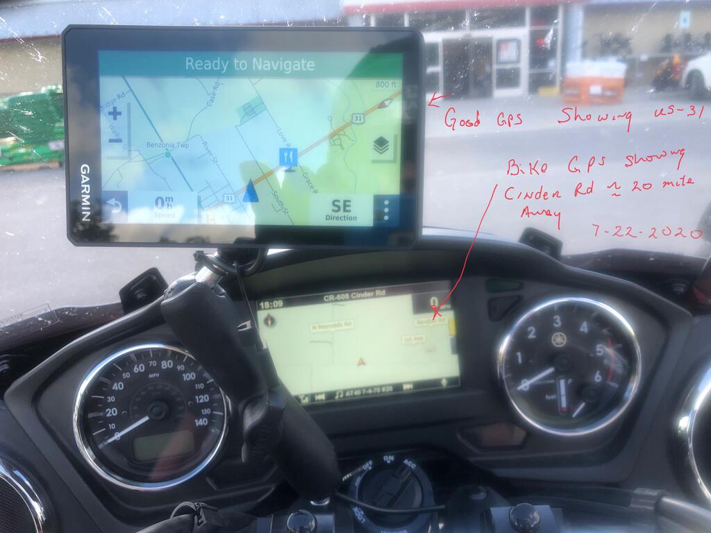

Talked with the dealer, he is trying to find an opening to get me in to at least look at it with the computer. Haven't heard further yet. I did order. new antenna from Rockymountainatvmc.com for $53.95. Figure if I have it when I go in and they don't I can save some time and they can replace it. Or maybe just do it myself. However, the prodigal GPS has returned. I went for a ride this morning and it was still lost. When for a ride this evening and when I booted up the bike it was home. Not sure if he will stay home or not but..

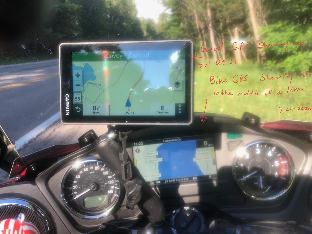

Well, the GPS is totally messed up. It got lost last night 07-21-2020 on a ride and still tells me I am about 210 miles from where I am at. Battery connections are tight, deleting personal info, riding in circles did not help. Went for a ride today 07-22-2020 and the GPS stayed lost, even after totally shutting down at 3 different stops. Guess I will be calling a couple of dealers tomorrow. I have installed the new map updates and the latest software update. To say I am disappointed is an understatement!

An unusual occurrence occurred to me today for the second time. I stopped at a rest area to use the facilities. Turned the bike off while I was away. When I started the bike back up and the GPS booted up saying it was ready to go. It showed a map, but not a map of where I was located. I continued on down the road to see if it would get its bearings but it did not. So after a while, I stopped and shut the bike off, waited about 5 minutes and started the bike again to see if it reset. It did not. I tried two more times at different locations with no results. The last time I stopped was to fill up the tank. After I got done and started the bike the GPS was reading correctly. The only difference on this stop is that I opened the tank cover and removed the gas cap. Has anyone else seen this problem and if so, what did you do to correct it? I am definitely thinking of just getting the Garmin Zumo XT and let the onboard GPS do whatever it wants to do.
