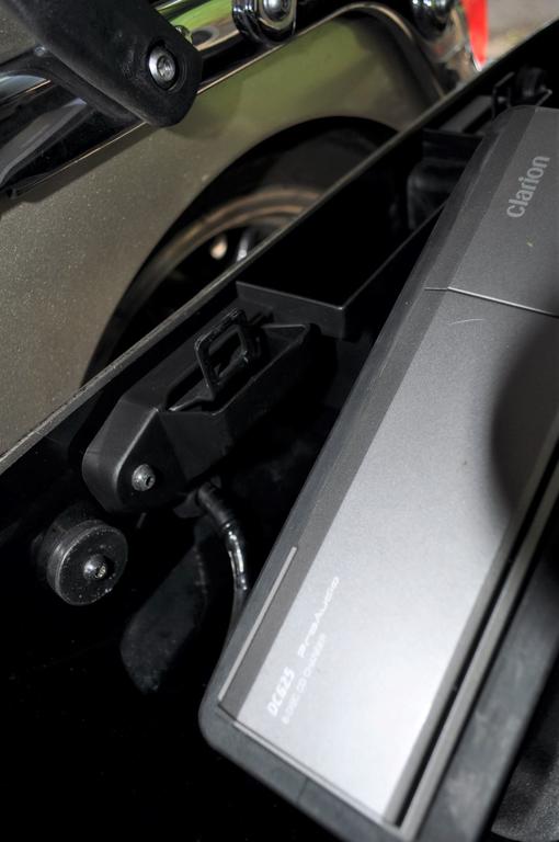

Mounting the CD player on my 09' Venture
Tennessee replied to Tennessee's topic in Royal Star Venture Tech Talk ('99 - '13)
I don't think the motors in the CD player would suffer any overheating, and there is just not enough amperage going through it to overheat any board inside. I can remember having one of these in one of my cars, and in the summer the car would do the usual, get up to about 120' in the summer. Never had any problems. -

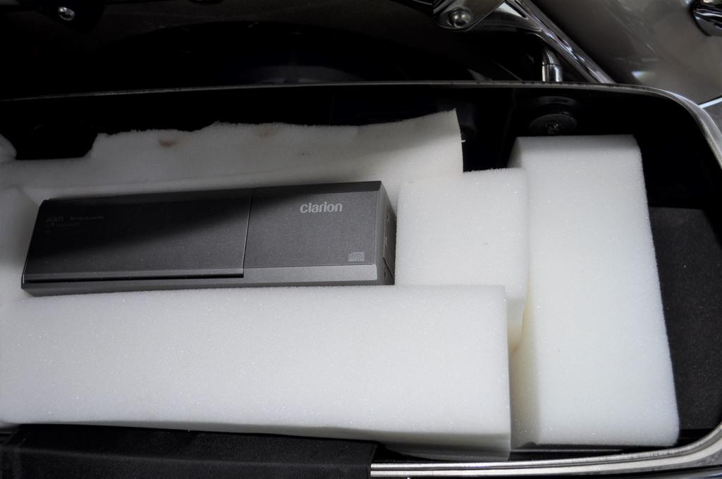

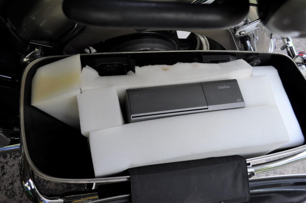

Well, it might be ugly, but the foam surround seems to work great. The unit is sitting on about two inches of foam, and as in the second set of pics, surrounded by foam. I took it out yesterday morning, purposely on a road that has a fair amount of little bumps, some sharp bumps, and even took it on the rumble strips on the side once or twice. Had one slight jump in the music, not even a skip when I hit what actually was a small bump. Ran it through the gears, let it lug, did about everything I could think of (within reason) to make it skip. Didn't go looking for potholes, but we don't have many of those down here anyway. Really could not make it skip. So ugly it is, but I am happy. I just used up about 70% of one bag, but I don't do overnight trips anymore anyway, so I'm good. -

I didn't really like the first time around, so cleaned up the foam a bit. So now the front and rear of the bag have some room for something, should I need it. I have an iPod, Fifth Gen that I pulled out of pawn shop, put a library of about 700 classic rock songs on it and plugged it into my Aux on my 02' Midnight. Also have the iPod charger cable going to a 12V USB plug I put into the 12V outlet on the bottom of the dash. OK, but not keen on the wires, and of course having that iPod hanging off the dash with velcro. I like the CD's better, since it is all hidden. There is a procedure available to put a USB port on any slightly out of date electronic radio, and a lot of people do it for car radios. I see no reason why this one couldn't have it done. Then you just plug in a thumb drive with your tunes, and have it set up to activate with the Aux function on the controller. I see the boards on eBay now and then. I've never been keen on using my phone and the Bluetooth function. -

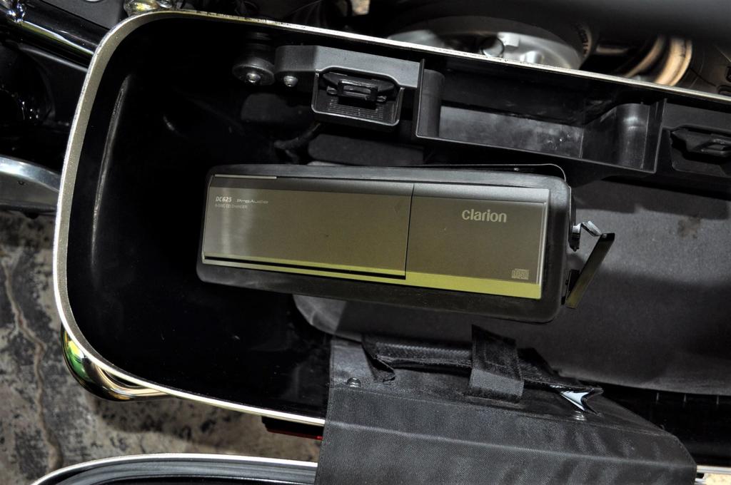

Well, here is the result. The foam came from Hobby Lobby, on sale at 30% off it came to about $14. Surround the CD player with the foam, keeping it from taking all the hits from the roads when riding. We'll see, I have it mounted and working, but have not taken it for a ride yet. The CD player sits almost two inches above the bottom of the bag, supported by the foam. Basically I sacrificed the left saddle bag, but now have a CD player that should be protected from the bumps from the road. Hooked up, it works fine sitting still. Have to put it on the road to see if I am successful. At least I am not trying to break off a tray wall inside the bag with a single bolt mount, as in the original setup. On the other hand, I have sacrificed a saddlebag for a CD player. We'll see how it all goes. -
Excuse my rambling, but I think more information is better, and people can learn from my mistakes! I know they are dated, but I still have a fairly large collection of CD's which I play mostly in my woodshop. But to be honest, I never thought I'd see a CD player on a motorcycle. (As a sidenote - I worked for Time Warner Music Duplication in NE Pennsylvania for eleven years, (CD's, cassettes, and vinyl), we all used to say "When they figure out how to put music on a chip, we're all out of a job.") How true that turned out to be...Came on board in 86', laid off in 97'. At least I got a decent pension out of it, which helps these days nicely! In any case, my 09' came with a CD player, which was put back in the original box. It had been installed before, in the left saddle bag. I'm OK with the spot, I don't use those bags that often anyway, but the mount on this thing is an abomination. The unit itself is surrounded by a thick rubber sleeve, about 1/2" thick, and harder than a car tire. I don't see how that will dampen anything. Then there is a folding simple cage that is supposed to go around the rubber sleeve, and has one factory mounting hole in it that upon inspection, I found the hole it bolts to in the sidewall of the plastic tray that is molded into the bag inbetween the lid locks. As best as I can tell, the bolt holds it to the thin plastic wall of the tray, and the weight is allowed to swivel down until the bottom left is on the bottom of the saddle bag? I tried putting it on end, but the hole doesn't line up. Ironically, the original car floor brackets are still in the box. I might put those in use before this is done. And all the instructions are there, in Spanish...The English ones are gone, probably put in the trash by the mechanic who installed it at the Yamaha dealer ten years ago! Take a look at the pics of it installed... Either way, there is a very clean hole in the back wall of the bag where the cable comes through, and it has a professional looking rubber grommet holding the cable as it comes through the hole. It looks factory. The hole in the wall of the little plastic tray also looks molded in, or one of the cleanest holes ever drilled into plastic. I have a couple problems with this setup. First, the metal bracket does not wrap itself properly around the rubber sleeve. I know the metal didn't get any smaller over the years, so I have to assume that somehow the rubber expanded a bit and now the bracket will not wrap properly and latch. You can see it in the pics. Second, the bolt that goes into the tray wall, that is just too thin of a plastic wall and I think in the very near future the CD player will break away and I'll have a broken tray inside the bag. The third and last thing is the ability to eject the cartridge even if the ignition is off. It is a feature of the unit. I had one of these exact same units in a car years ago, and the same glitch still exists - if the cartridge is empty, it keeps hunting, looking for a CD, even though there isn't one to be found. I always had to keep at least one in the player in my car unit, and this seems to be the same. Once it finds one, it stops at it, is happy, and stops using up your battery. No CD, keeps hunting in some sort of odd calibration setup or something. This may be why the previous owner, (two owners back actually, the one I bought it from never put it back in), took it out, or maybe for luggage space, or maybe he just didn't use CD's anymore. Ironically, the player plays exactly as advertised, and to be honest, it puts out a fairly high quality sound. I'd love to leave it in but not with that mounting system. I know a lot of you that have these have put them in the trunk, but since I tend to put helmets in the trunk, I think I'd like to leave it in the bag. And I already have the one hole in my saddle bag, I am not inclined to put another in the back of the trunk. I think I am going to look for a block of furniture cushion foam, (not cheap, by the way), that is a little thicker than the width of the inside of the bag. I'll take off the silly rubber sleeve off the CD player, and cut a block out of the foam, insert the CD player into the hole in the foam, and sit it on the floor of the bag with about two inches of foam below, and of course the foam all around the player, slightly tight to the inside walls of the bag. Should kind of float within the confines of the cushion foam, and help it from the bumps on the road. Keep it lower than the bag lid and all should be well. I certainly don't think it hurts the value of the bike, as long as it works. We'll see how it goes.

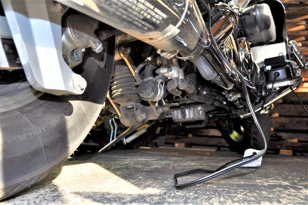

Seems like it would, doesn't it? But the wheelbase length stays the same. I should have mentioned that in my other post. The rear lowering is almost always a vertical drop of the rear tire. As long as the contact patch of the rear tire stays the same length away from contact patch of the front tire, the rake stays the same. What does change is the COG, center of gravity. With that dropping closer to the ground, and in some cases even moving somewhat backwards due to the vertical drop of the rear wheel, the bike now can corner easier and handle quicker. It becomes easier to swing that weight left or right when it is lower, and especially bring it back to center coming out of the turns. Here's a good example: If you have ever ridden on a twistie road, (who hasn't), did you ever raise your body in the turns, or did you have a tendency to lower your body in an effort to lower your weight? Nobody ever gets themselves higher, or up on the pegs into a turn - that is a good way to end up on your side. Even when you watch dirt track racing, you see the riders try to get their butts back into the seat when they go into turns after doing jumps or moguls where they might be up on the pegs. Gotta get that COG as low as possible getting into the turns so you can do them easier. You never see anyone raise their body going into a turn, they instead tend to hunker down into a turn, lowering the COG. Same effect when you lower the rear end of the bike permanently. Get the COG as low as possible, easier to turn. -

Grubsie: No, I have no desire to raise it back up. I'm a fan of lowered bikes, actually. This lowered Venture, when I brought it home, I noticed it immediately, the handling was just better than my Midnight. I thought at that time that maybe Yamaha had done some geometry homework, but now I know thanks to a company called Barrons, I have a lowered Venture. It will improve the handling in my mind, for a couple reasons. First off, shorter riders, (not really me, I'm about 5'11"), they can get a much better grip on the ground with their feet. Second, it lowers the center of gravity and pushes it backwards a bit. This helps with rolling the bike into turns. And for sure, I noticed it immediately that this bike can roll into a steep turn a bit easier than my Midnight, although not as easy as my Indian Roadmaster. The Indian handles better in turns due to the rake angle, which on the Indian Roadmaster is only 25 degrees, with a trail of 5.9" As another example, Harley Electra Glides have a rake of 26', with a nice large trail of 6.7" For those who don't know, Rake is the angle of the front forks as dictated by the head bearing/steering assembly welded to the main frame. Trail is the first point where the front tire contacts the ground, and ends at a vertical line drawn from the bottom point of the front fork straight to the ground. Anything from 4" to 6" is considered OK, but a slightly larger one is even a bit better, within reason. On the Yamaha Royal Venture and Midnight Venture, the rake angle is a strong 29.2 degrees, which is starting to get out there a bit. Trail is still good, at 6.1", but that more acute rake makes the stock bike just a bit harder to roll into a turn. (Think of those choppers we all used to love, with the 40-45 degree rakes that made the front forks extra long and the bike almost impossible to turn.) The lowering kit makes it all a bit easier, moving the COG back and helping the rider use their weight to get it into a turn. Won't make it turn any sharper, but a bit easier. Now that I've ridden both, I can honestly say that maneuvering and slow speed hard turns are a bit easier on the Venture that has been lowered. Seat height also plays a part. I believe the standard seat height on a stock Venture is 29.5", which is actually high by today's standards for a touring bike. My lowered one, compressing the pillow top, it goes down to about 28", much more tolerable. My Indian Roadmaster, the stock seat height is 26.5", and with the lowering kit I had installed, it is now 25.75", which is very low. Obviously I can throw the bike into turns rather easily, even though it has a wet weight of 930 lbs. I also can scrape the fishtail pipes if I'm not careful. Fortunately, the Roadmaster comes with a Fox rear air shock, capable of 0-120 lbs., so one up I keep it around 60 lbs., and two up I jack it up to around 75-80 lbs. Ironically, the Venture has a wet weight of 869 lbs., about 60 lbs. lighter than the Indian, and yet the Indian is easier in the twisties. As a third example, a 2019 HD Ultra comes in wet at 910 lbs. But it also has the rider a bit more forward on the frame, which changes a lot and in my mind, makes it harder to handle. My 2015 Ultra Limited Low was awkward to me. I only owned it for about 9 months. Of course, other things are in play, like wheel base, tire size, how high the engine is mounted in the frame, etc., but above are the basics. For instance, my Triumph Rocket III was one of the hardest bikes I ever owned to throw into a turn, mainly due to the 240MM rear tire which only wanted to go straight. Hard to get it off that large flat contact patch and onto the rounded part of the tire. In any case, it's all good, and I plan on changing the oil in my new lowered Venture today, as well as change the final oil. Brake pads are on the way... And I still plan on letting my Yamaha dealer balance the carbs and do a plug change, since I believe the plugs must be original and I'm pretty sure the carbs are now out of balance just a hair. Like I said in an earlier post, "Lower mileage, lower maintenance..." People think too much in terms of miles, and not enough in terms of time. -
