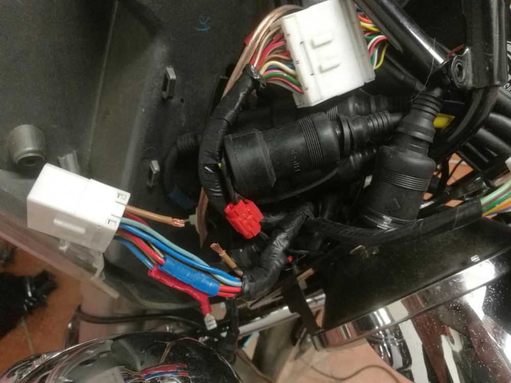

  1. There was a plastic protector on the brown wire (like the other two) - that looks originally... but the wire was ripped out, I connected the wires together by tin. What is different from the original state of the bike is that someone has added a radio amplifier.
  2. Hello, you were right... when the motorcycle is completely dismantled, then a man knows a lot about his bike The problem was only in one wire and everything was off (speedometer, fuel gauge, odometer, cruise control, neutral light, 5. gear light). So back to the road... thx guys..
