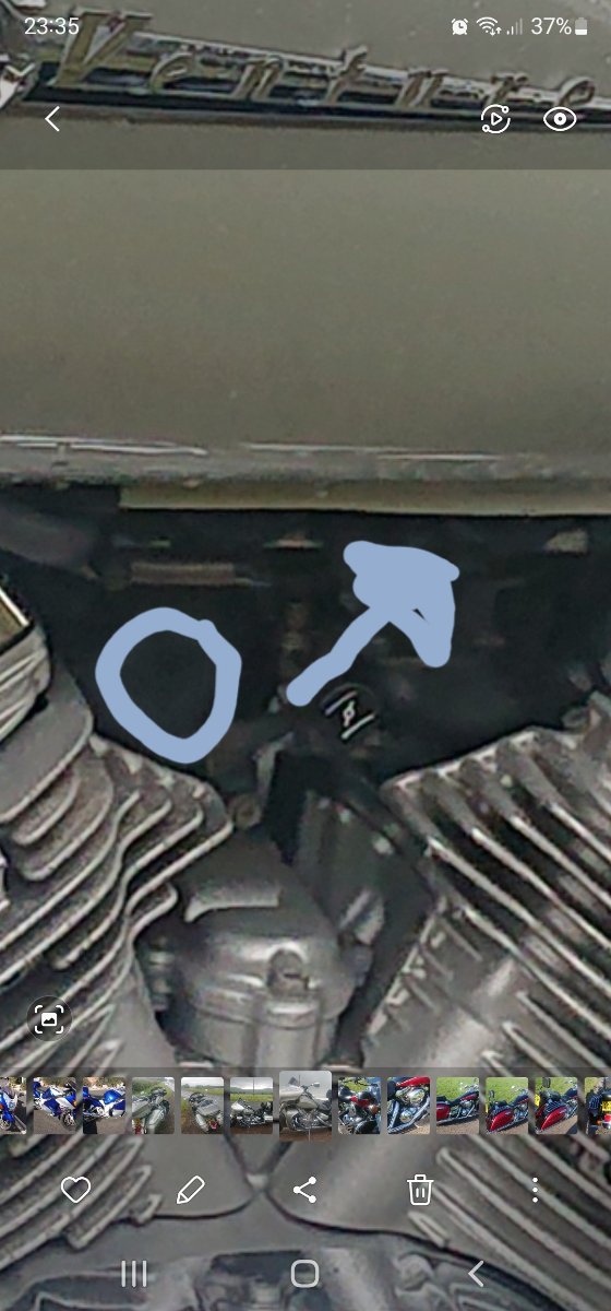

Well this just got fun, went to look at all the above. Bike wouldn't turn on, no lights, no dash, nothing. Replaced the battery with one I knew was working, still nothing. Fuse time, removed the main fuse and it disintegrated. White powder everywhere, snapped fuse. I will attempt to clean out the existing 'fuse holder' but I'm not holding any hope it'll be of any use. Does anybody know what I replace it with (a part number would be great)? My knowledge of the electrical side is next to none, so be gentle 😂 ***Edit... I've found what I need (starter relay) ... for £14 (about $18) I'm not going to bother trying to clean out the old one

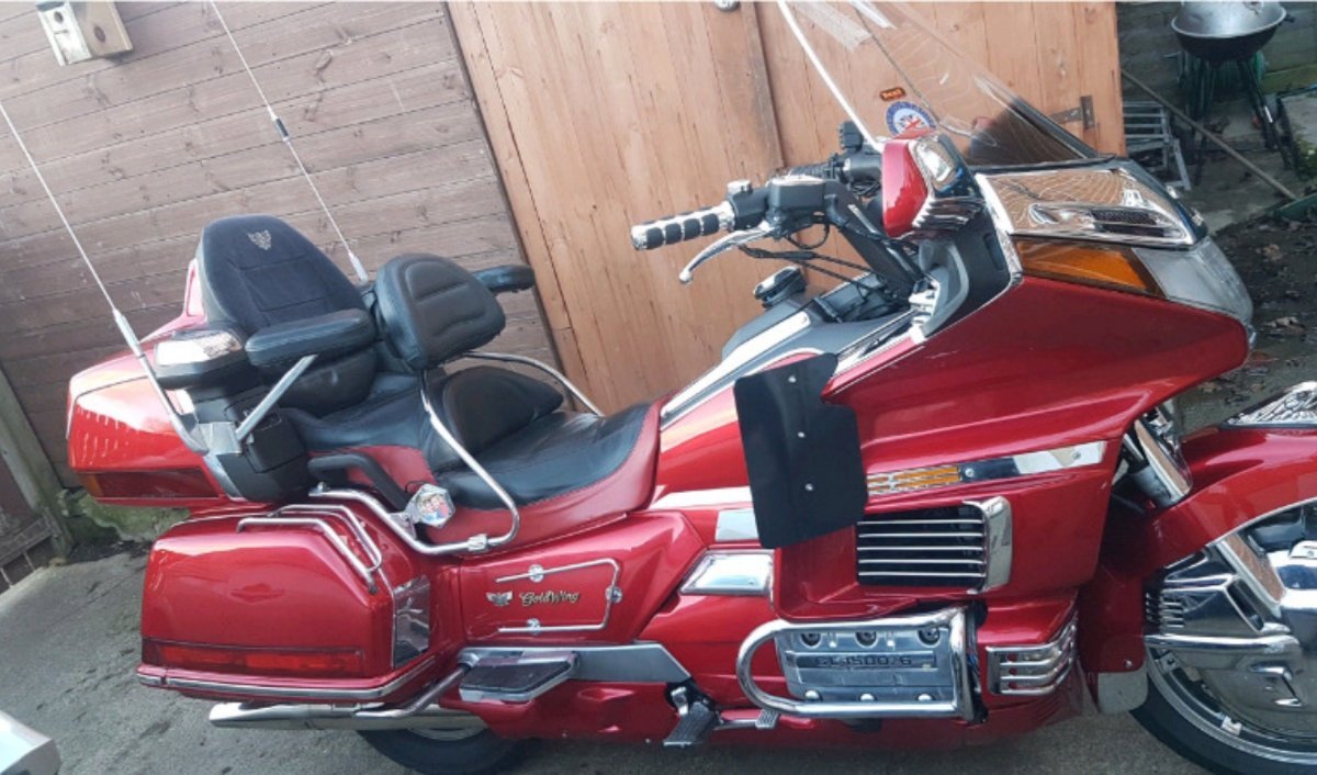

Hello everybody I hope you're all OK, long story short I bought a GL1500, asked a local paint guy to repair and paint some parts so I could sell the RSV ... that was a year ago! Anyway, the parts came back, all fitted. Charged battery, she starts up 3rd time! To say I was happy was an understatement. That was till I saw fuel leaking out around the carbs on the left hand side. I've attached a pic of roughly where the leak is. It leaks as soon as the fuel pump turns on (so the bike doesn't need to be started for the fuel to start coming out) and stops after 10/15 mins or so. Any 'quick fix' ideas before I start tearing into the carbs? Im guessing sitting a while has perished something.
I grew up around Goldwings and have one myself 16 (😯) years ago for a little while... so when this came up (about 5 miles away) I couldn't resist! It has a few daft problems... nothing to serious or difficult to fix... but I love it!
