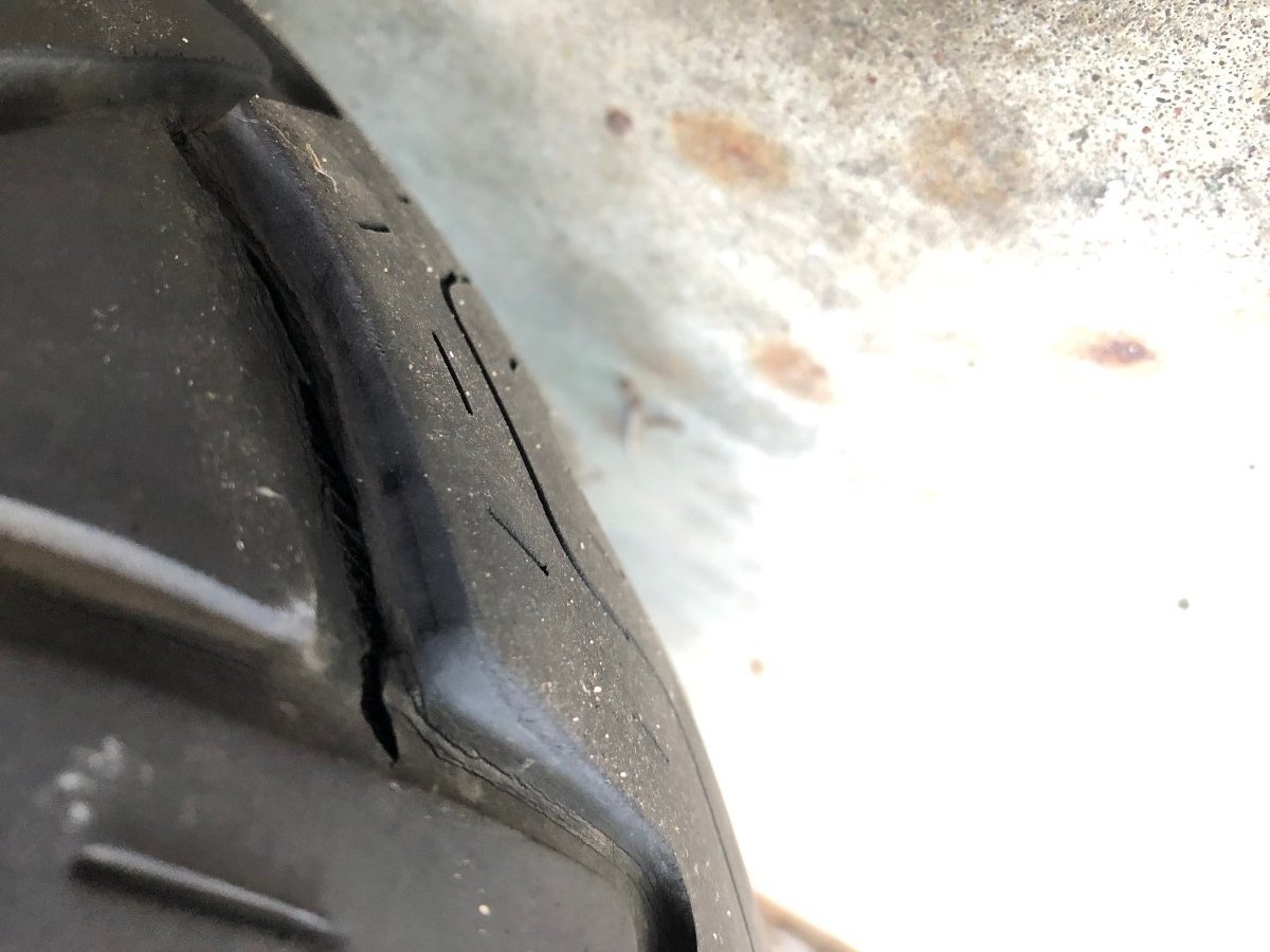

I happened to look at my rear tire this morning while getting the size off it. Luckily I had stopped where I did. The tire tread is cracking and I could pull down a little on it and see the cord under it. This is a 6 year old Kenda Kruz K673 with about 10K miles. The last one of these I had about 7K miles and a big chunk of center tread came off while me and my wife were out riding. Didn't notice it until we got home and happened to stop with that missing patch showing from the rear. We had ridden about 200 miles. I always park it in my carport with the tires sitting on carpet. I'm not sure I want to try another one of these. I like the ride and tread pattern better than many others that don't seem to have enough tread.

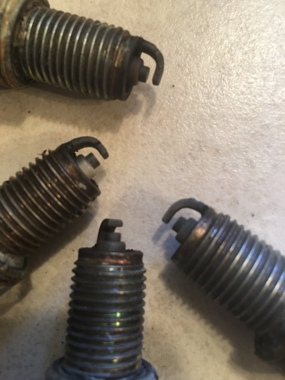

The new plugs got rid of the ignition noise in my headset. I haven’t gotten to ride further than 5 miles yet. Prob tomorrow. I used ngk 4929 resistor plugs. Old plugs had about 20k miles on them. -

Top plug in pic was dirtiest and came from RH rear cylinder. I pulled the cover off carb diaphram for that cylinder and it had a little oil in it. Enough to wet finger.
