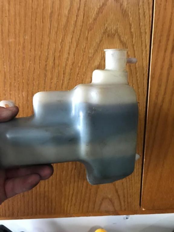

  2. Steve, the oil leak is from the coolant reservoir. It’s the hose connected to the small nipple on the reservoir opening.

  5. So the repair shop told me to just run the bike to see if there is still a problem. I think they thought that I poured oil in the water reservoir. Well, the problem still exists. The water reservoir is full of oil Has anyone here had this problem?
  6. Just an update. I took the bike in for a service and they found that the oil leak was not a leak at all. I had a small amount of oil floating in the cooling reservoir. The hose that I thought was a vent hose is actually the overflow hose for the reservoir. I have read articles here that say that the cause could be in my water pump, head gasket, or the twinkie (still trying to figure out what that is). I have done the oil change and did not see any signs of water in the oil (the white foam). So, now I have to come up with a plan of action. Have the cooling system inspected. Inspect the twinkie and replace gaskets as needed. If necessary, have the compression checked. The bike has always ran very well so I'm not sure if the head gasket is the cause though I'm not ruling it out.

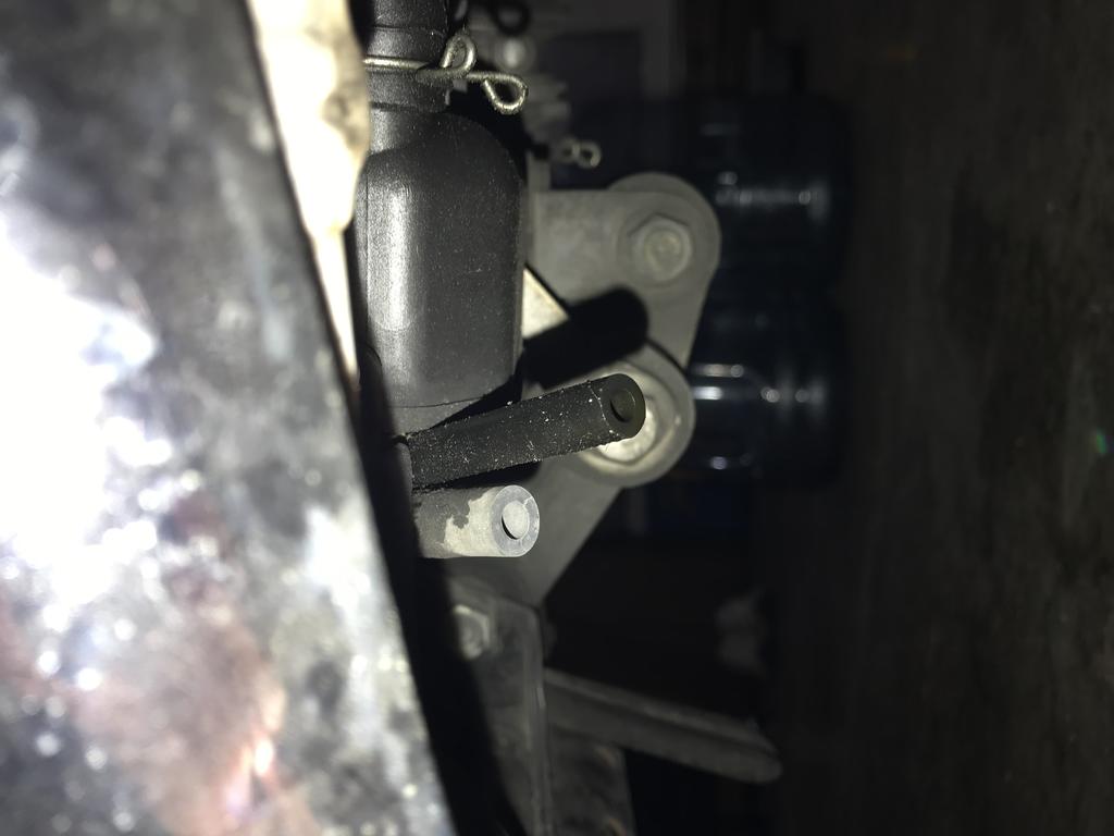

  7. Thank you for this information! This area on my bike looks pristine. I will pull the hoses and check to see if they are plugged

  10. It’s the vent hose that is close to the kickstand when it is up. The dark longer one. Posting with an I-phone is a pain! Lol

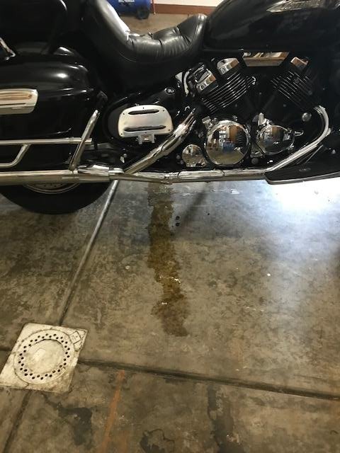

  11. Yes, it was on the side stand last winter but not while waiting for the train. Of course it was on the side stand in the garage when it leaked.
  12. The strange thing is it seems to be heat related. The first time I noticed a puddle under the bike is when I backed it out of the garage last winter to run the engine and forgot about it for an hour or so. This week I was stuck waiting for a long and slow train on a hot day. Rode it into the garage and noticed it later on.

  15. So, I have owned my bike since new. (2007 Venture) this year I’ve noticed a leak after the bike is parked. The oil is coming out of a vent hose. Everyone will say it is because I have overfilled the crankcase but it is not the fact. I have always filled it halfway in the window and the last time I filled it a quarter way up. This only happens when the engine is hot. I pulled the tank and sure enough there is oil residue in and below the air box above the carbs on the drivers side. Any ideas? I’m at a loss.
