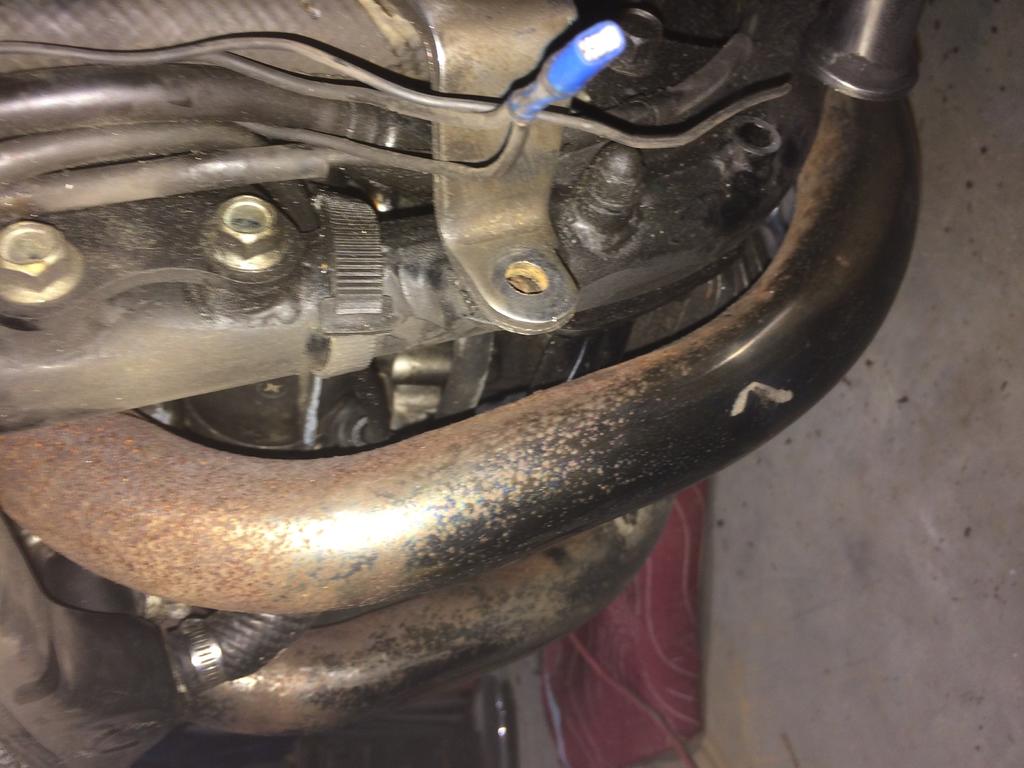

Very nice pipes there, Marcarl. Here's what I have, after a half hour trying to clean them up.... I also spent a half hour trying to get the pic rotated, to no effect. They are solid, but rusty and burned. Yours, even with the dings, are nicer. So you're in Washington ? Tacoma ? You're right, the shipping would suck. I'm going to look locally, but right now, your pipes will be hard to beat around here. -

I usually don't have much trouble finding things on the net. This time, however... I've covered all the bases and I believe the restoration of my Blonde '83 VR should be straight forward but I've hit the wall on new front header pipes. Mine are in good shape aside from some corrosion, but I'd like to have them really nice. E-bay, Craigslist, Google, Bing, etc. have not provided productive leads. Anyone have a source for NOS pipes ? Alternatively, a place that will chrome older pipes ? Chrome shops usually will not do parts that have been exposed to oil at high temperatures as the oil has been baked into the metal and messes up the chrome solution tanks. As you folks have been doing this for some time, perhaps you have an angle on this. Lastly, will the 1300 cc. pipes fit on the 1200cc. engine ? This would double the pool of salvage pipes I'm probably going to have to "paw" through. I'd hate to do a classy restoration only to do the front pipes with barbecue flat black... that is so wrong...
