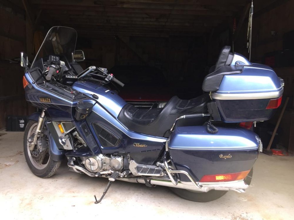

  2. I have to post pics of my new toy. I love this bike!! I pulled next to a 94 Voyager last weekend. IMHO the Venture, if nothing else, looks way more stylish!! My 89 VR:
