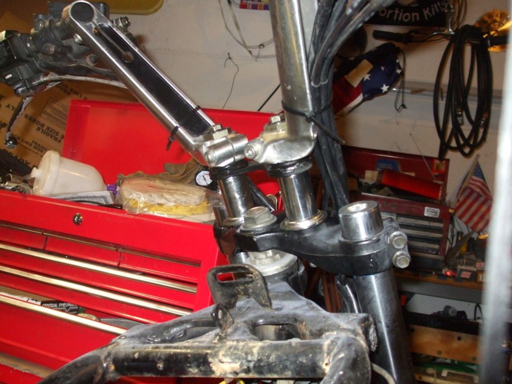

  1. Yeah, those studs are the devils in question. I was really hoping that someone might have a trick to getting them out. I may just grab a spare and go at it with a mallet and some map gas, see if I can't pop em out somehow or something.
  2. There we are, it looks like I got videoarizona on the right page, and I think we are talking about the same thing cowpuc. there is a nut and lockwasher on the underside of the tree, with a cotter pin through the end of the bolt as a just-in-case. but there is definitely a gap between the flat part of the perch and the bolts there, and liquid comes through it from the inside of the knobbly bits. And yeah, it shows in the fiche as part #10 . But I've seen a few different bikes where they have slid barrel risers in there and placed a longer bolt through the Triple tree (a-la the picture up there in my first post); so either they come apart, or people go so far as to grind off, cut bolts, and weld on new length bolts to add risers on their rat-bobbers. I'm hoping cowpuc or prariehammer come up with a trick here, or I'm gonna be breaking out the grinder and welder
  3. Not quite. Im talking about the actual bolts on the assembly that go through the triple tree. the big black bolts that are screwed into the part you clamp the handlebars to: They are obviously threaded in, but I cant get them un-stuck for the life of me. Penetrating oil left sitting for two days (it flowed out through the gap in the bracket) and they still won't budge with two pairs of channel locks. Are they tacked in or something, or are mine just fused with rust?
  4. Hey there! got a question about the lower handlebar holders. how in the name of the flying spaghetti monster do you get the bolts out of them to replace them with longer ones? I know it is possible: The part you actually clamp to is threaded in the interior as well. But I can't for the life of me get the durn bolt to loosen up, I can't seem to get a grip on it. anyone done this round these parts and have some tips? I'm about to drill a big hole through the bolt and stick a rod through it to get some leverage, but would rather not have to destroy it if at all possible.
