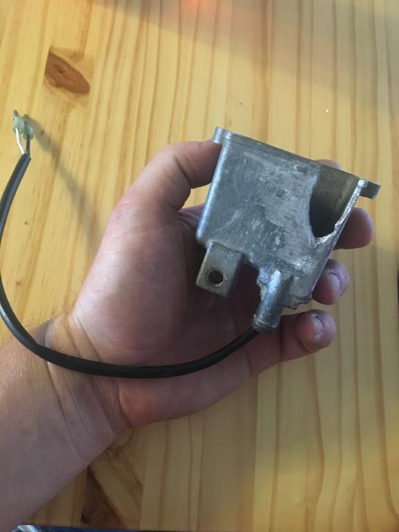

  2. And this is what I just found in my goodie bag from the PO. I guess I know now why I have a nice shiny replacement.

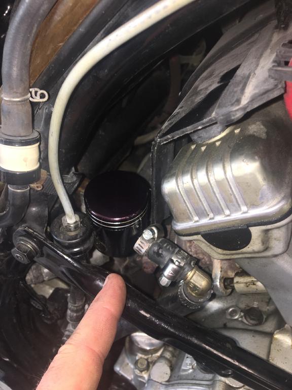

  3. I take it that this is an aftermarket rear (split) brake master cylinder put on by the previous owner? Newby here. I bought this 83 standard last Month. My brakes work, so should I assume that this is a good thing? Any comments?

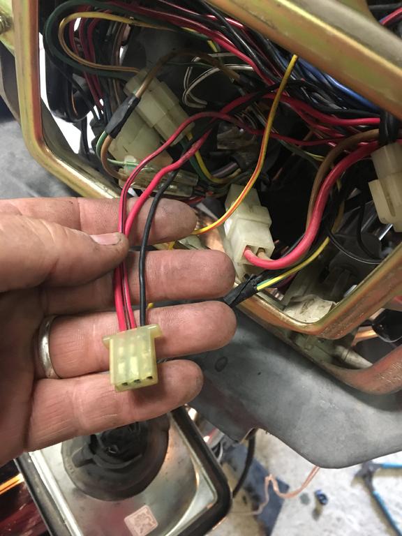

  6. Hazard switch connector is in place. Still no turn signals. I didn't realize that the front turn signals operate as running lights. Thanks, glad you pointed that out. CMS does not go through its test mode. It simply acts as if its dead. I am contemplating removing my jumpers I performed just to see if that makes a difference. Would a faulty CMS unit cause these problems? In other words, does the CMS even play a part in the operation of lighting or does it just act as a monitor? If the PO ran a secondary wire from the headlight connector to the CMS as described in my original post, then this would indicate that the CMS has power over the operation of devices, correct? Perhaps I just blew my CMS... As for the temperature sending unit, I checked it and there is a blade connector (male) that has nothing connected to it, but I'm 90% sure there wasn't anything removed from it last week. There is indeed a connector that's properly fastened that sits behind it. Here's the only connector I can't find a mate for. It sits just behind the headlight bucket area. I'm pretty sure it didnt' have a mate when I started my disassembly. Any thoughts on what this is designed to go to?
