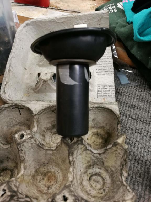

  6. yea the one i repaired (bottom right) is hanging up or not performing the same as the others. I'm glad they are easy to swap out. I do have to sync the carbs. I'm sure that is a big problem.
  7. The bike was running when I bought it. Obviously it wasn't running well with two stuck carb slides. Everyone on this form was saying how snappy the bike is and I wasn't getting that feeling so pulled it apart. I have changes the oil and oil filter, air filter is clean enough and new plugs. I have not done a compression test. I have been busy with fixing the cruise control and other minor things.
  8. "Frankenslide" works! Can you tell which one it is?
  9. Not celebrating yet.... but I believe it will work. But I am purchasing two from a fellow member.
  10. Still have a little bit of tweaking to do but looks like it might work.
  11. I am not giving up! I have done crazier things. Its a product similar to JB weld. I don't have a ton of hope but its worth a shot.
  12. Good information. I will re-evaluate the intake boots once I get a replacement slide.
  13. But I'm still scratching my head over why they were tight. I don't really know how they were when pulling them apart but sure noticed it putting them back together. Any of you guys ever had this problem?
