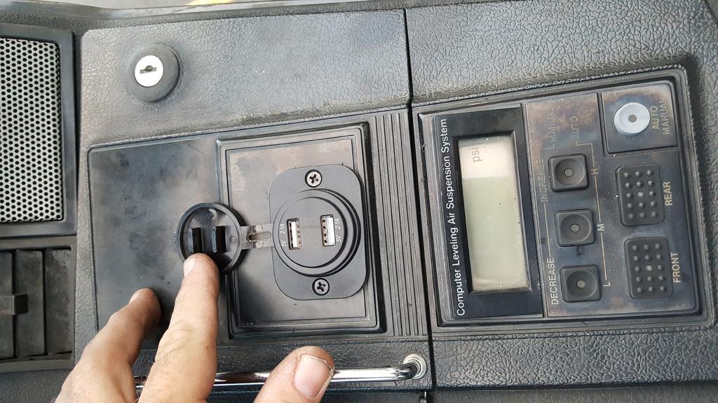

  14. Got the dual usb and voltmeter installed. According to my readings on my dm i read .5-1volt low from actual reading at the wire that charges battery. I think it my be because where I hooked it up. Here are some pics. This is the only modern upgrade we plan to make until radio goes out.
