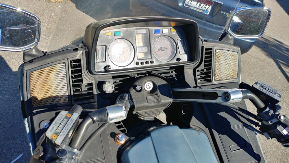

  1. It's fixed. I'm happy it's fixed but I'm unhappy because I don't understand why it's fixed. I went over the grounds with sandpaper and made sure all the connections were tight and that didn't seem to do anything. I figured I would give my old brake master cylinder one more shot and was pleasantly surprised to have it building pressure again. Bled the brakes and now the front brake is working (as well as the crappy stock brakes ever did) and now the dash doesn't shut off when squeezing the brake lever... Like I said, I'm happy it's working again but super confused to what the problem actually was. Since I don't know exactly what caused the issue, I'm worried that I will be updating this thread in a few months saying the problem came back.
  2. Well, I've struck out with the grounds. I'm not sure what would make the switch itself cause the issue since it should just make it be on or off, but the stupid switch doesn't even make the taillight come on, so it probably needs replacing anyway. I think my next step is to pull apart the fairing and thoroughly check each wire to find a short. 35 year old bike with 77k miles and I'm sure there's bound to be plenty of insulation that's rubbed a bit thin. In a perfect world, I would like to redo the harness, but that would take a ton of effort and $$. Something that started at the same time is my front brake master cylinder developed a leak out the inspection window. I noticed when I first got the bike that someone had done a repair on the clutch inspection window by epoxying a dime in it. When that thing died, it went out in a blaze of glory. Of course I had picked my wife up for lunch and on the way back had a torrent of brake fluid dump out and the clutch wouldn't budge. Some time in a parking lot and some new fluid didn't help since the seals were pretty much dust. But I managed to get the 6 miles home by starting in neutral, revving a bit and stomping into 1st. Rev matching allowed for shifts on the way, but I had to try and time traffic lights perfectly... Luckily my transmission was fine. Tried to rebuild the master but it was so pitted that it barely worked so ended up getting a clutch master cylinder from an 04 fjr1300 and it works like a champ. All this rambling is heading somewhere. I promise! So, since my brake master cylinder is also not working (shaved dime and jb weld fixed the inspection window leak but it's not building pressure) I'm looking into options to upgrade/fix that problem. Ive been reading up on folks using brake rotors from r1/r6 bikes and I'm sure that I can make a master cylinder and lever work no problem. This would be a great time to upgrade and what better master cylinder to use than the one that matches the calipers, right? The concern I have is this: does it matter what year of r6 to use as a donor? Do they all bolt up the same? I read somewhere that the xvz1300 forks are the ones to use so it bolts up and I already have a set of those ready to go on. There's a guy near me selling a set of 03-09 r6 rotors, lines, master cylinder and lever and I really hope that will fit. Plus I will have a new brake switch and get to de-link my brakes at the same time. What are your thoughts? Should I be looking for different years? Just get another fjr1300 master and worry about calipers later? Do I need specific brake rotors to go along with all of this? Any links to threads that I may have missed when searching the site would be appreciated! Thanks, everyone!
  3. Hey, folks! A few days ago, I noticed whenever I used my front brake, the gauges would cut out. Everything, except for the speedometer (having just replaced that, I know it is cable driven or else it would have crapped out too, I'm sure!). Even the LED indicators like for the fuel and clock turn off. The second I release the brake, it all comes back to life. You can do it several times in a row until it just stays off and you have to turn off the key before it will work again. This is crazy weird to me. I don't have any other electrical issues and my bike is just the base model so there's less to go wrong. I started following wires and making sure that connections were clean and tight and was keeping an eye out for any insulation that may have rubbed off and causing a short but haven't had any luck so far. I've even removed the front brake master cylinder from the handlebar to make sure that I wasn't just jiggling a loose connection in the starter switch and I can't replicate the problem when I fiddle with the starter switch, just the brake lever. Any thoughts? I've tried digging through old posts and haven't seen this problem so I'm hoping someone can help point me in the right direction! Thanks! Forgot to say this is for my 84 xvz1200

  6. Checking the oil after hitting the starter was a good idea. The oil level dropped from above the sight glass (that's why I thought it was filthy, now it's the normal yellowish tint). So there is too much oil in it but the air filter looks fine. I'm waiting on the oil filter to arrive and will change it all out and put the correct amount in. Can someone explain to me how the vents are supposed to work? I can't find a switch or anything to open or close them (besides pushing them with my finger) but I can't feel any air flow. Same with the legs, but I can just put my legs out to the sides and cool them down. It gets real toasty hugging the tank! I read about that before but thought it was nice when it was cold. Riding in 70* weather gets unpleasant but not as bad as the upper vents providing 0 air flow. If there isn't something obstructing the vents, I would be tempted to believe that someone removed the ducting. I keep coming up with plenty of reasons to take the fairing apart, guess I can't avoid it for much longer. Another question. The choke won't stay on unless I hold it. Is there an easy way to fix it? I assume that it's worn out in the handlebar control and friction isn't keeping it in place. I know some bikes you can get away with tightening the controls to increase the friction and that would be nice, I don't look forward to trying to source a new one. What a pain when you start the bike, go and lock up the house and come back to find instead of warming up, it died and I can't let it warm up while I put on my gear

  9. I have been sick and not wanting to do much but got real tired of the gross looking speaker covers. It probably would have been easy to remove them but I just taped up the bike and sprayed them with primer and silver paint. I wanted gold or glittery purple, you know... and obnoxious color! But my wife talked sense into me. I didnt want black because I would have to paint everything to match the shade. Here are some before and after pics. It made a big difference, the old covers were just so ugly!
