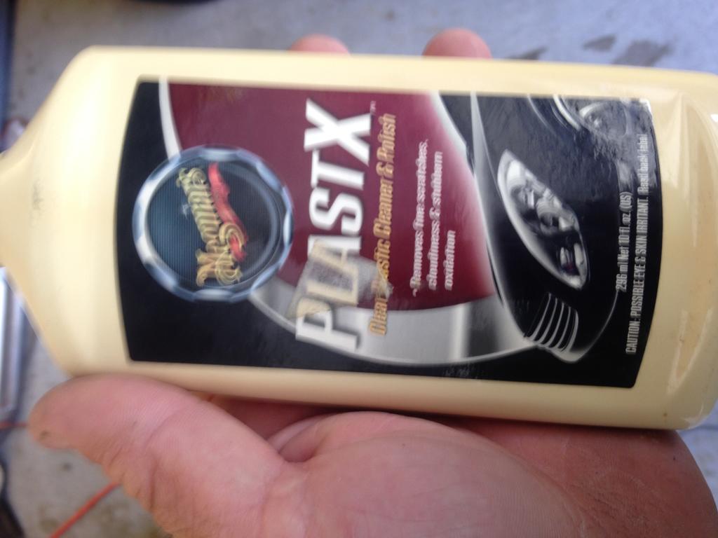

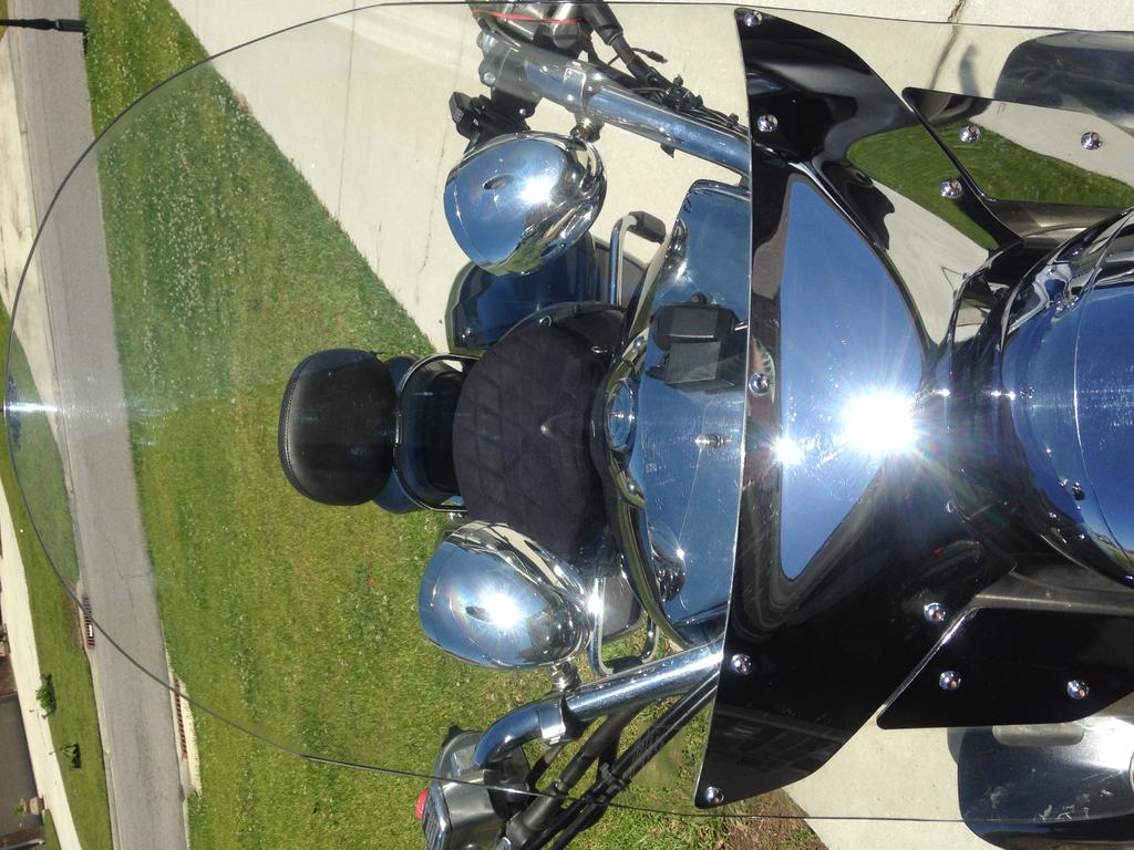

  3. May have been covered already, but, worked on my windshield today. Turned out AWESOME !!!!!![ATTACH=CONFIG]109173[/ATTACH] Sorry for the pics being sideways !!!

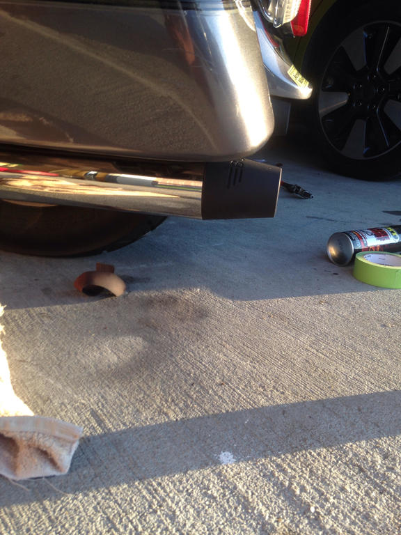

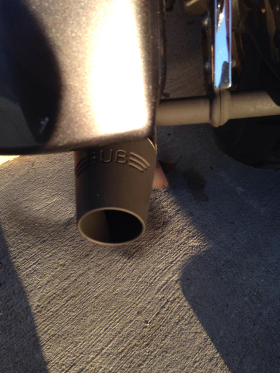

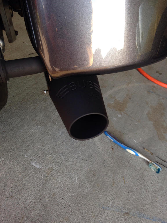

  4. I got the paint at AutoZone. It is VHT (Think thats the name) ceramic header paint. I have 3 light coats, and one medium coat. If you have your tips off when you do them, the can gives you instructions for curing them, in the oven. I rode about an hour and a half the day after I painted them, ( I painted mine on the bike) , no smell of paint, no bubbling, not tacky to the touch. I THINK, they also make a gloss black, but not in the header coating, however, the regular high temp VHT is good for 600 degrees I believe. I wouldn't think the tips get any hotter than that !

  6. ​So , like a lot of BUBS owners, my tips were starting to flake the chrome plating off really badly, and I got sick of looking at it. Here are the finished product. With a little good old fashion elbow grease, and some high temp header coating, they look much better.
  7. I like my bubs as well, but, my tips are flaking, I may try some high temp flat black spray paint

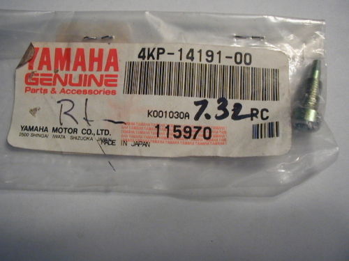

  12. Unfortunately , there is no O-ring on the part, the conical end is what seals, and mine were pitted with rust.

  15. I have been told by the mechanic at the shop, that on the carbs, there is no O-ring. Is this correct ? I sent the picture from an earlier reply to the mechanic, and was told the ones on the royal star carbs, have no O-ring?
