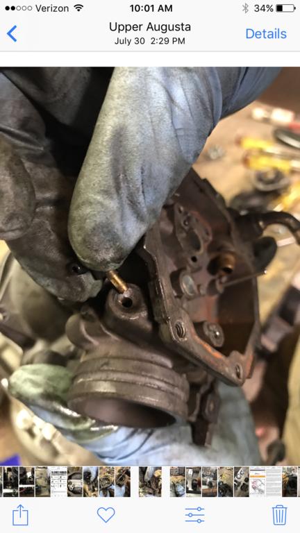

  1. does anyone have any spare carbs for parts? My 90 degree elbow on my carb's end broke and I could use a replacement or two.
  2. That hat was the issue!!!! I took the hose off and it didn't do it anymore. I blew into the tube and it was clogged up. Wow.
  3. No I didn't use the clear tubing yet because I damaged one of the ninety degree nipples coming out of the carbs 😫

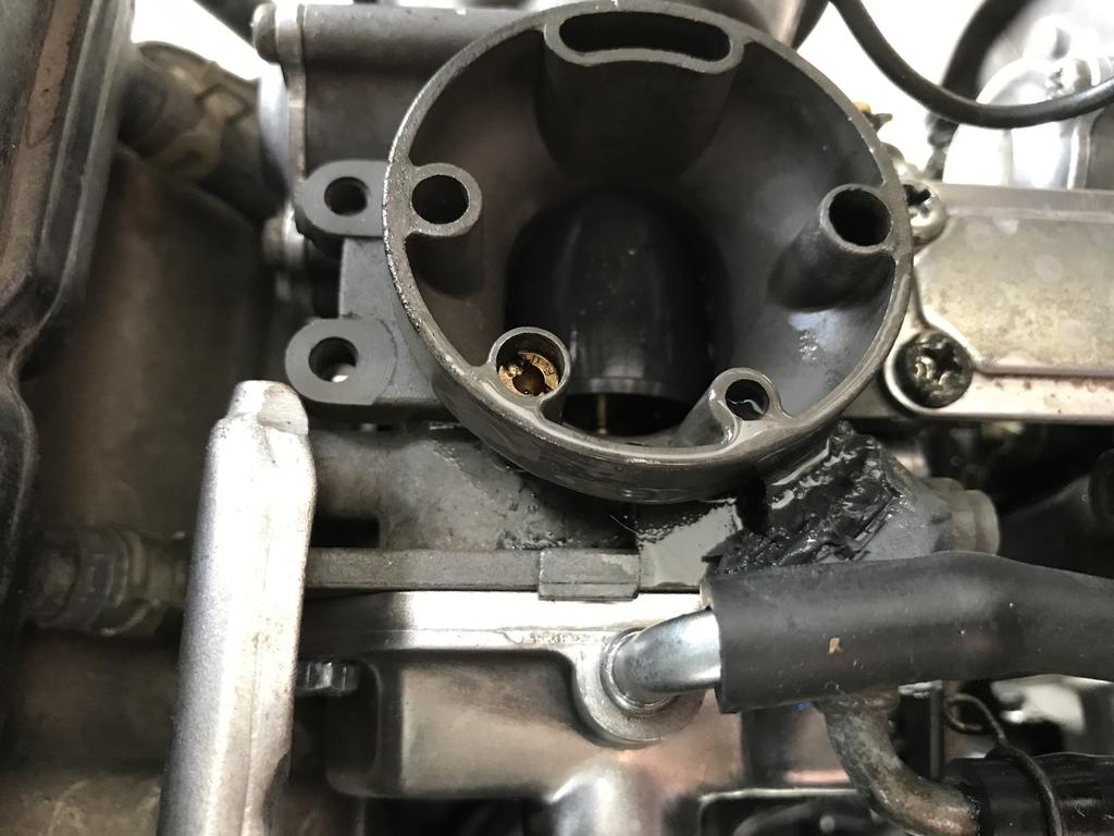

  4. There is a thread on here about setting floats at 1" measuring from the bottom of the bowl to the bottom of the float.
  5. Five miles and a week and a half. I put them on and the pigs started leaking so I sealed them then this gas started spraying.
  6. I rebuilt the carbs a week and a half ago. Set the float with the 1" rule.
  7. These carbs were just rebuilt. Have about 5miles on them!

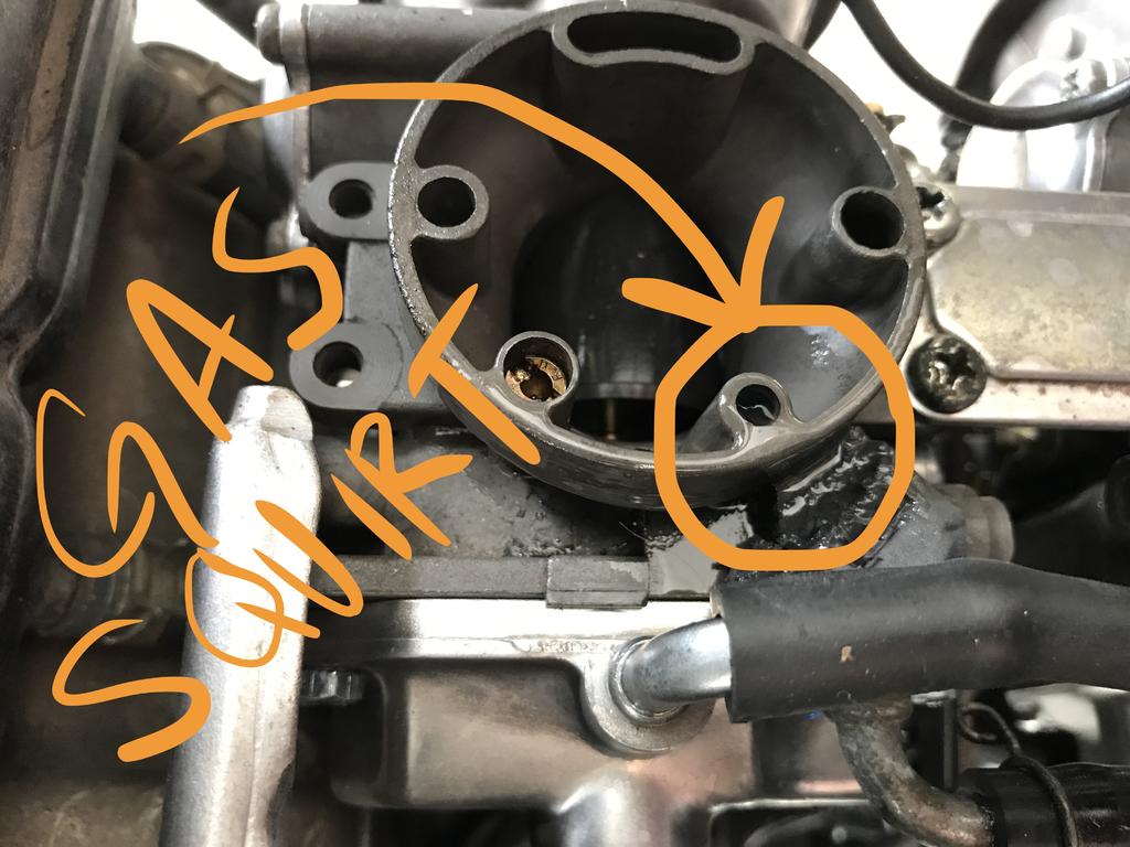

  8. Could this be because of the float not working? And the fuel level maxing out ?? really could use some help!!
  9. I know it's kinda hard to see. When the bike had no fuel pressure and I turned the pump on it started peeing gas like a stream in the air! Lol now the bike has some pressure built up from the other carbs and it only trickles out of that hole. I tried posting a video but it was too large
  10. Haha. No. Don't mind that. My float valve access pugs were leaking. And I used steel stick to seal it.
