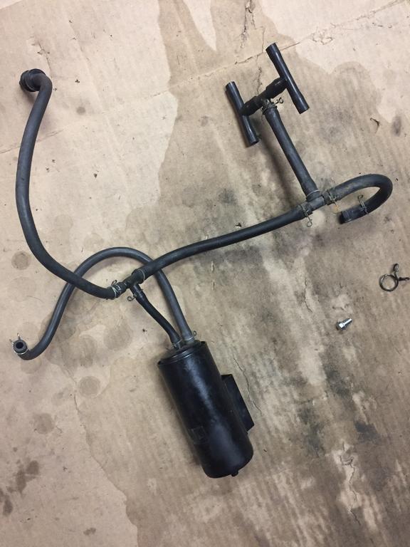

  • Home Country
  • Bike Year and Model

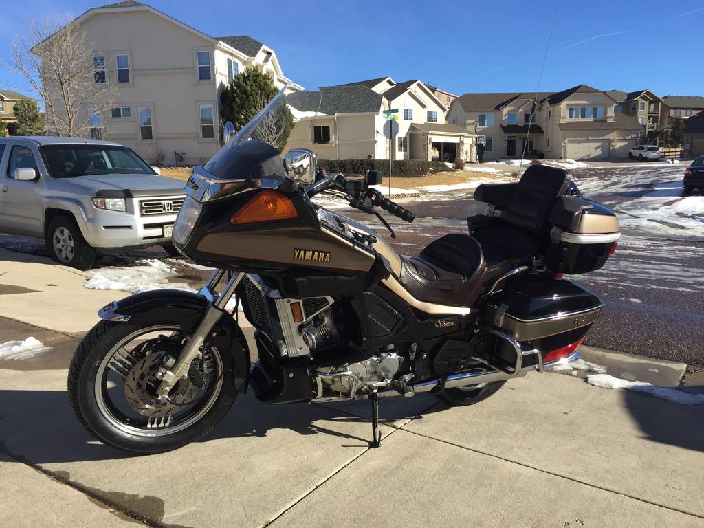

  1. Yep...that's my Venture. I've exhausted all my simple resources on it and gotten to the point where it just isn't fun any more. I'm OCD to a certain extent with my stuff and if it's not working correctly I will obsess about it and I've already lost more sleep than I'd like.. The folks here on the forum have been so awesome in trying to help me and I'd just as soon see it go to a home where someone will appreciate the effort, money and time I've invested in it. It's going to be a great bike for someone that is going to know exactly what to do with it....that just isn't me.

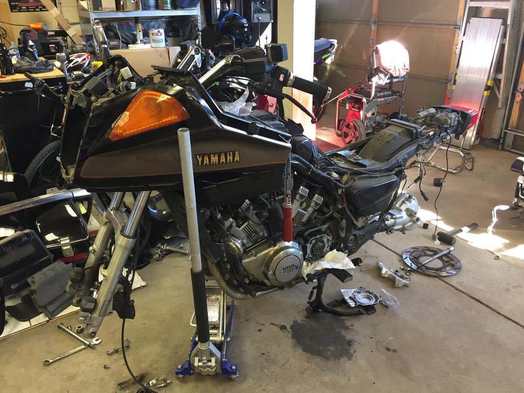

  8. Well...here's your daily update. Pulled the carbs and re-re-reverified float levels. Pulled the jet block rubber plugs and gave them a wintergreen/alcohol refresh bath. Reinstalled everything and.....same results. As the bike sits from being warm, the carb vents leak fuel. Fuel pump cycles but it does start as I guess it's not being restricted by all the crap I've removed from the system (emissions stuff, tank vent) Here's my next theory so let me know your input please: As the bike sits and cools its obviously letting fuel in (and back out thru the vents). When the carbs are inverted and off the bike you can blow into the inlet and air doesn't get by but it MUST be allowing fuel by. The only thing I can figure is that the K&L needles and seats aren't compatible with the bike and I need genuine Yamaha stuff. Maybe the fuel is even getting in AROUND the seat. The seats did have an o ring but they weren't very hard to press into place. Yay I get to pull the carbs for a 5th time!!! Anyone have any thoughts here?
