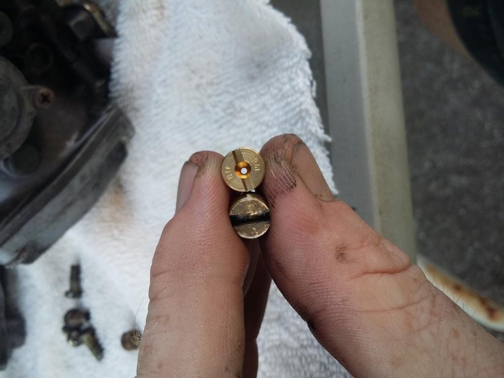

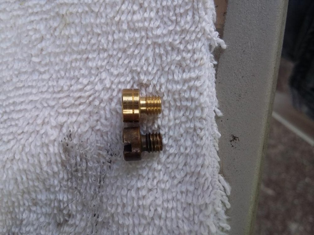

    Uniontown, PA, United States

  4. Im going to chreck into the video mentioned.... I looked around for diaphragms and have not seen any for less than $30 a piece! But they definitely need replaced. Nobody has commented in the jets I replaced and how different they are from the ones that came out? So I'm guessing they are ok?? Would the diaphragms cause the problem I'm having?

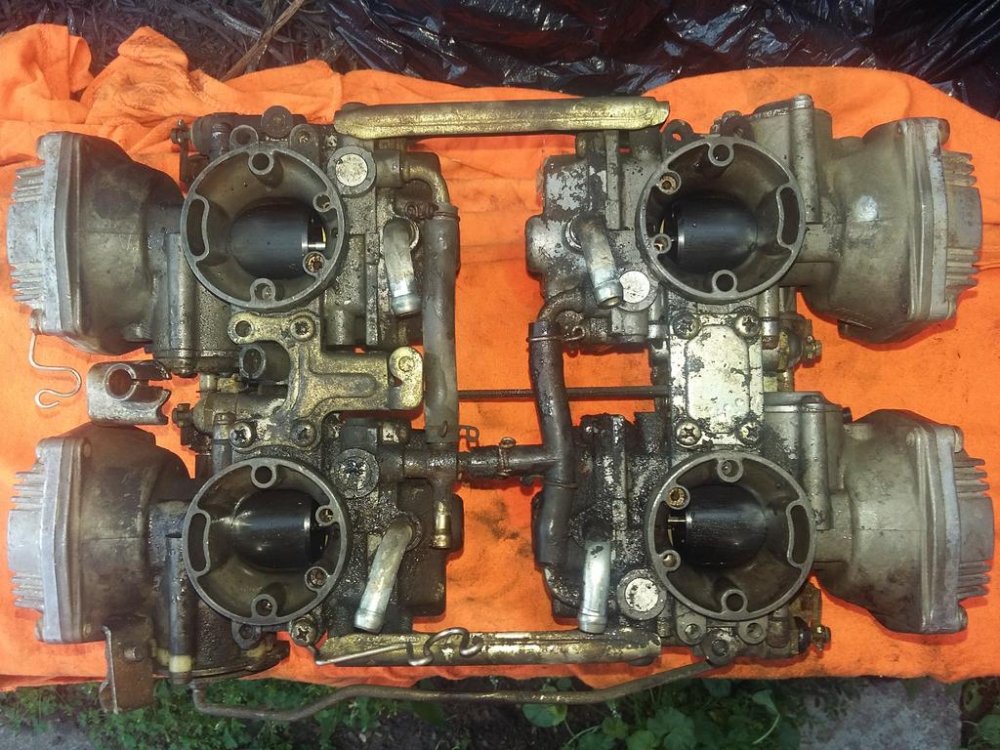

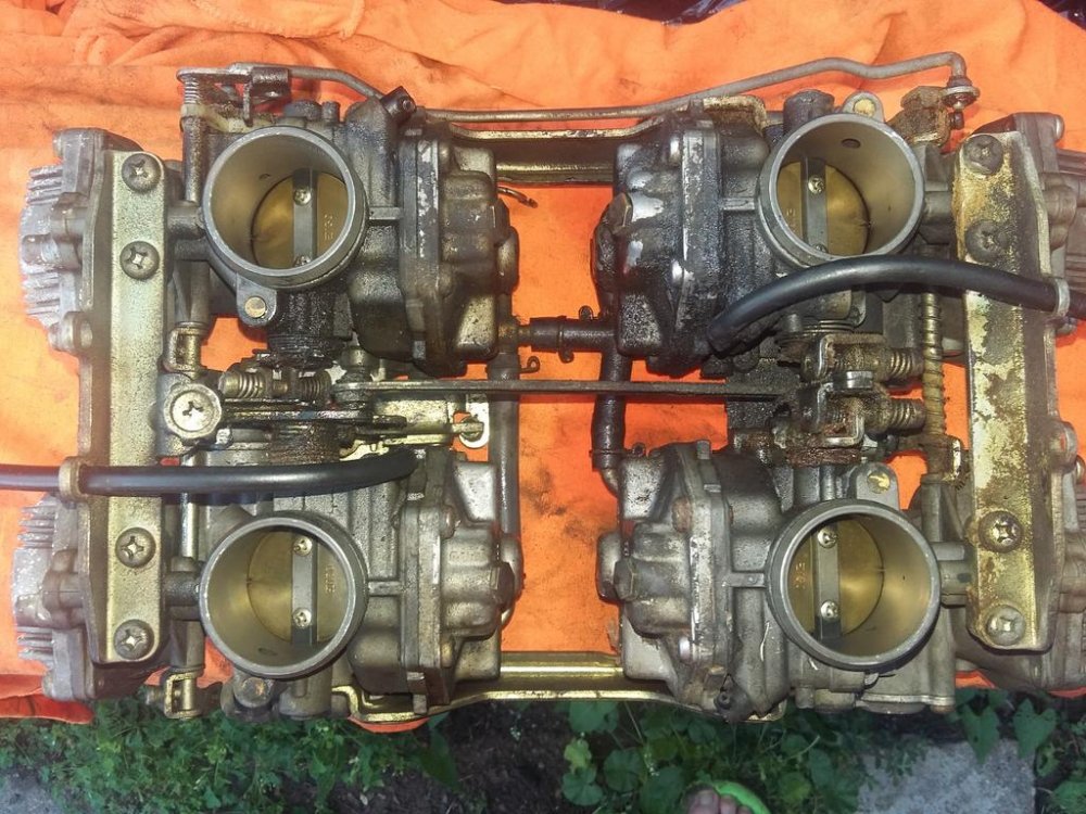

  5. This is after I cleaned them.... before I cleaned them it ran rough but good enough to take a short road test. When the bike is at idle right now the 2 back carb slides are dancing very well, the front right slide is much slower and the front left does not move until throttle is applied. I replaced the O-rings but not the gaskets. The carbs are flat and fully mount to bottom boots. No visible cracks in slides. I will check for the air leaks asap! Any suggestions is appreciated
  6. Air box fully installed.... synced using the no sync guage method showed in YouTube vids from this site.
