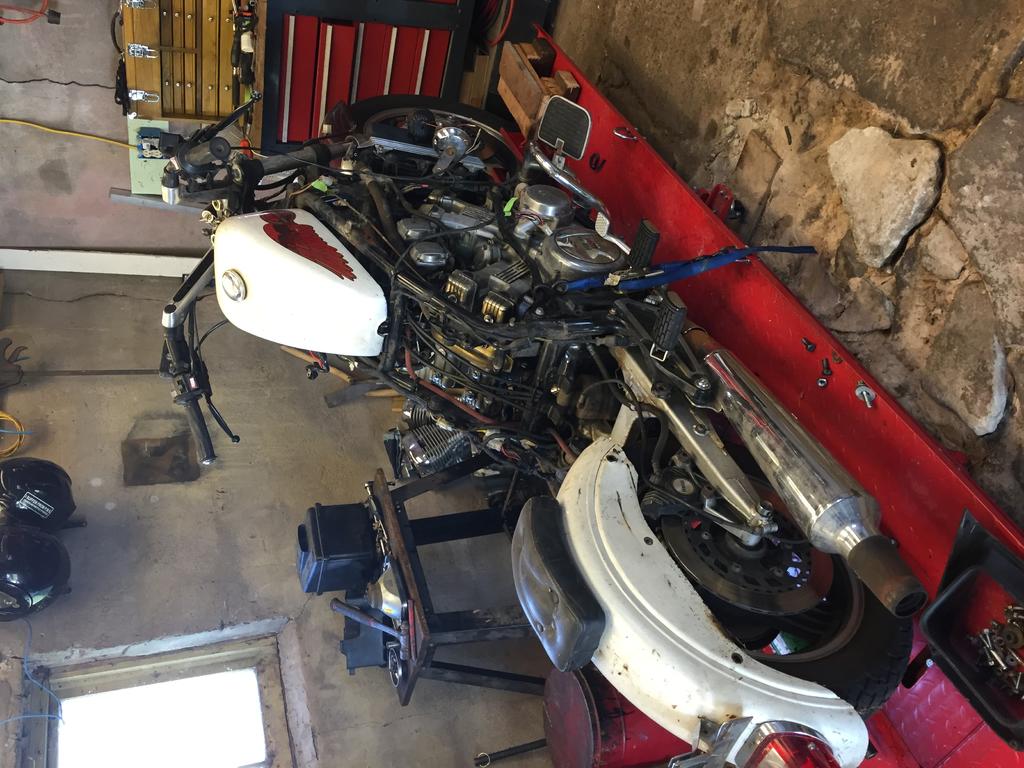

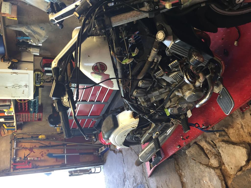

  3. Man! There's a lot to reply to here. For starters, the donor bike in the pictures is (was) a complete, working, running 84 Venture Royale. The only thing I haven't seen work is the radio but in disassembly I found two blown fuses, so who knows. Maybe I'll grab a couple fuses and plug it all back in just to see. The fairings aren't in great condition, but are complete minus one of the side covers. I won't be using or keeping much of anything that's not in the pics so if you're looking for something let me know. I have gotten rid of the original Tci (which was faulty) in favor of the Ignitech replacement and am switching over to COPs. The coils are fine as far as I can tell but I want that space open for other things. I do do have some self taught welding experience and do own my own torches and junk mig welder. It's one of those Swedish things that I tore down and installed a better mig gun and a gas valve so I could run it as a real mig instead of just a wire feed. I also installed power lugs so I can reverse polarity to go back to wire feed as necessary. One of these days I'll pick up a new one. I wouldn't weld a tank with it. I certainly don't have tons of play money laying around, but have been a professional mechanic for some time now and have amassed a fair collection of tools and experience. I've been thinking that a tig would be on my shopping list for sometime now and this just might be the time to splurge on it. I'm talking with a guy that has a Miller thunderbolt ac/dc welder already running a tig gun on it for $350 (no argon tank for that price). That doesn't seem like a terrible deal considering I could make use of the arc welder as well. Buying a tool like that to learn the skills I need is kind of how I am. I decided one day that I wanted to learn how to run a metal lathe. Now I own a 13 inch South Bend and know how to run it. Kinda.
