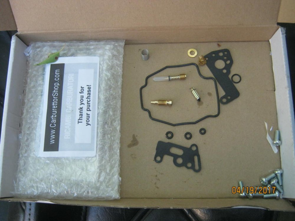

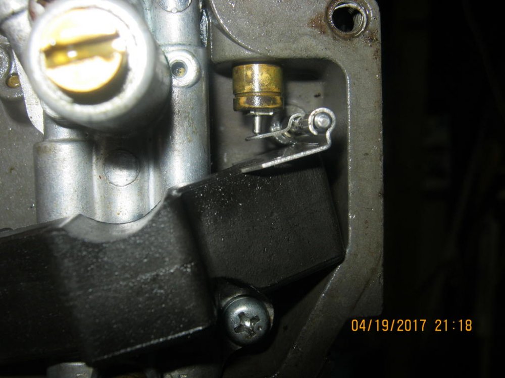

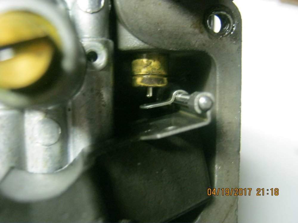

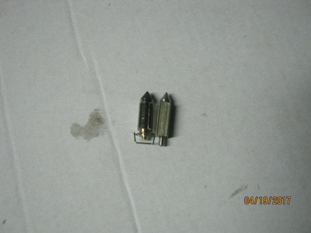

It is too short, I will take the valve out of mine and take a picture of them side by side. I ordered them 4/13/2017 got them today so 6 days is not bad for international shipping I also paid the higher shipping rate. But even with all that it says somewhere in there that the orders could take 21 days to get to your door. But here is a couple of pictures of my 83 carbs, I do wonder because I have the housing for the valves if they could be switched out. But I still don't know how to get the bowl valve and seat out.

Ok I actually ordered this kit, but once again the float valve don't fit, but I like what all comes in the kits. new mixture screw with spring, washer, and oring. new drain screw with oring, this one is slotted not phillips I put it in one of the carbs that desperetly need one. The last set of carsb I got one of the mixture screws is buggered up. 8 screws to replace the existing screws. or in case you have parked near @cowpuc and he snagged one. the brass washer and screw for the jet block. The gaskets for the enrichment valve and the jet block feels and looks kind of like a rubber substance of some sort, the one I got from K&N definatley a different matterial from what I can tell this kit is not a bad deal. O and the spring for inside your slid underneath the plastic screw.

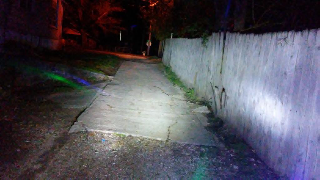

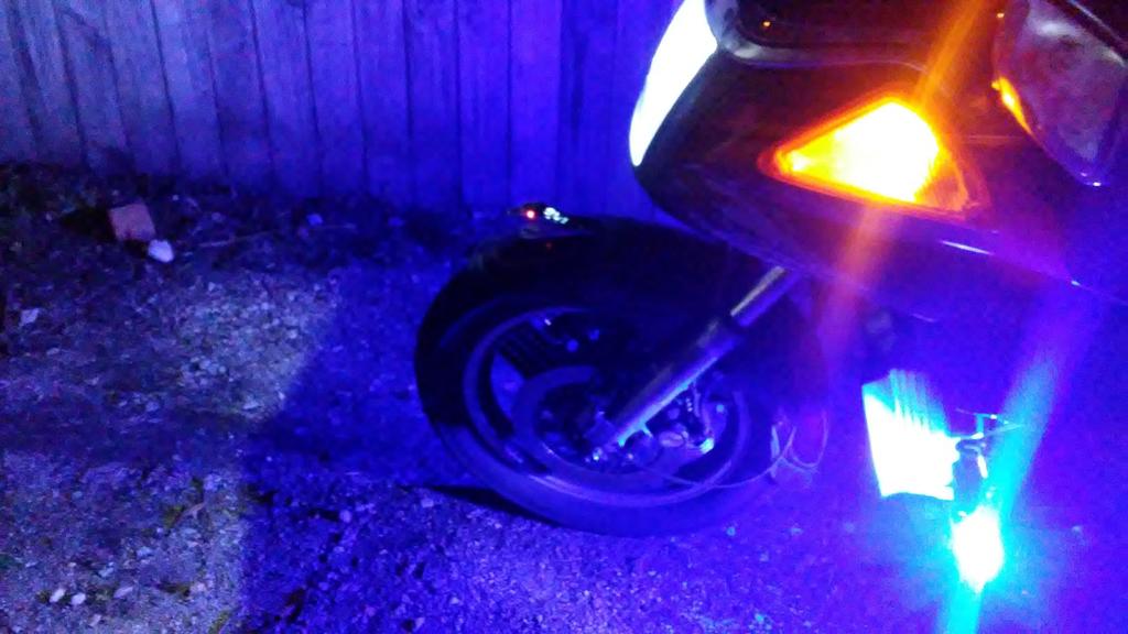

I have the same lights on my bike only I went with bluish halo and I can switch them from bright dim and pulsing. I can also switch out a wire on them where they are red in color, kind of like show light I guess. the beam on the fence is from the spotlight fog light. I have my aimed outward for getting light in the ditch side of the road. Trying to drive for them reindeer. They work somewhat. I have seen the 4 led lights thinking about trying those out to see which I like better. I would like to know where you found the white halo tho. when i got mine all I could find was Red big no no Orange/amber, and the blue.
