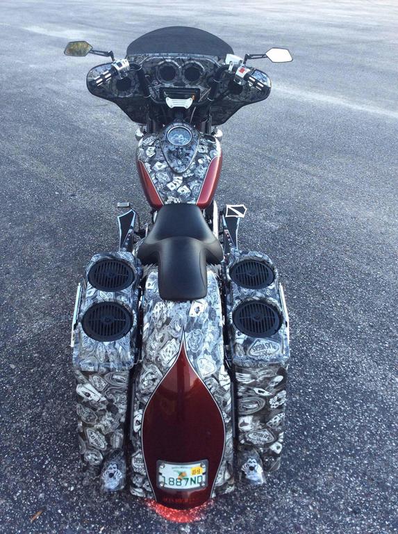

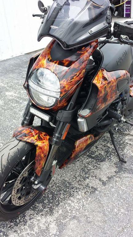

  1. Price starts at $800 for motorcycles and can go up to $2800 for an all out bike/bagger. Customers ducati & and my Road Star bagger.

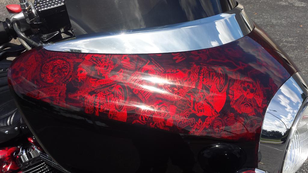

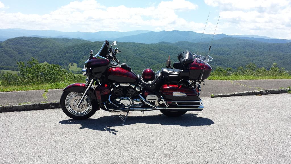

  2. It's hydro dipped. It's what I do for a living. website is:myliquidaddictions.com I love riding this bike. The mountiain picture was from TN/NC ride I did in June.. In Florida we have no mountains.

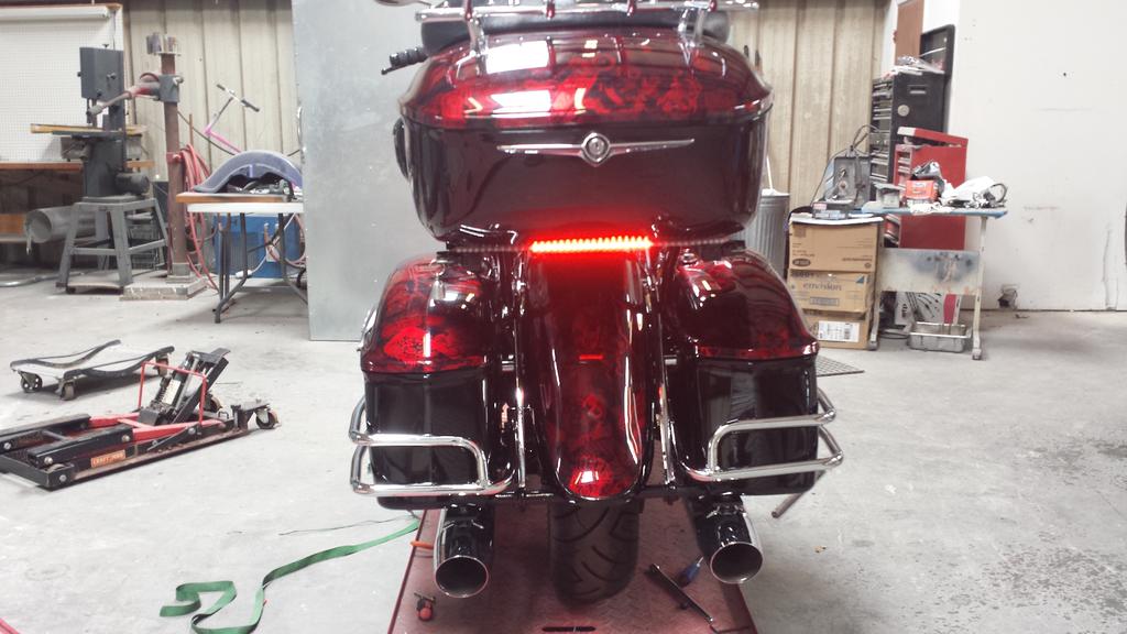

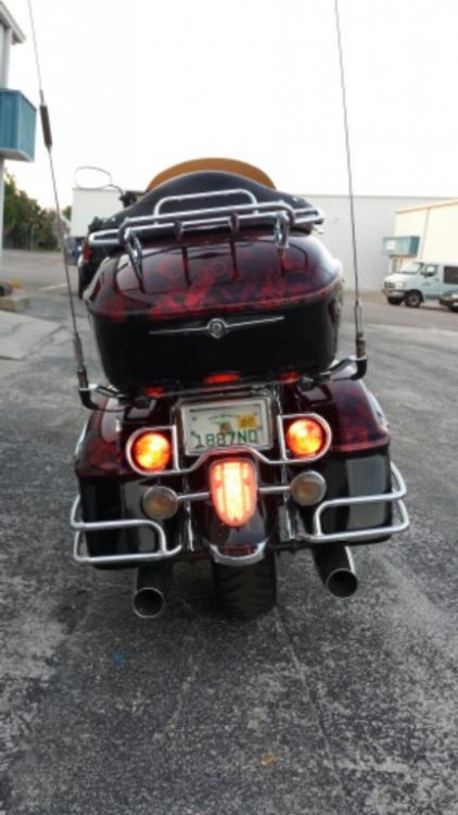

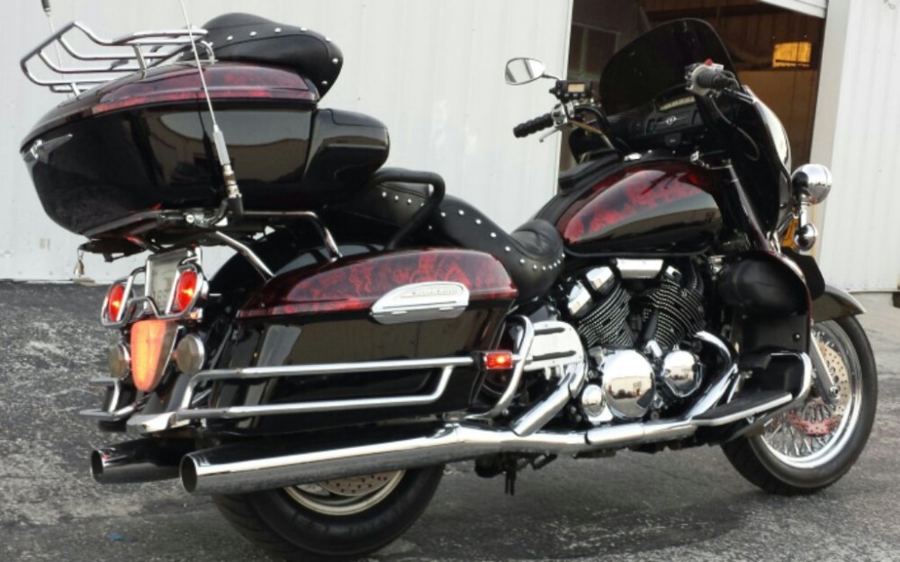

  4. Smoothed rear fender. Brake, run & turn led light strip under tour pack.

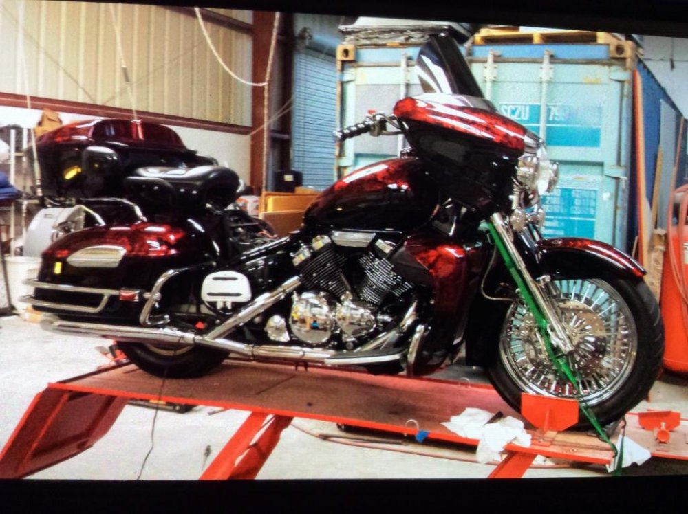

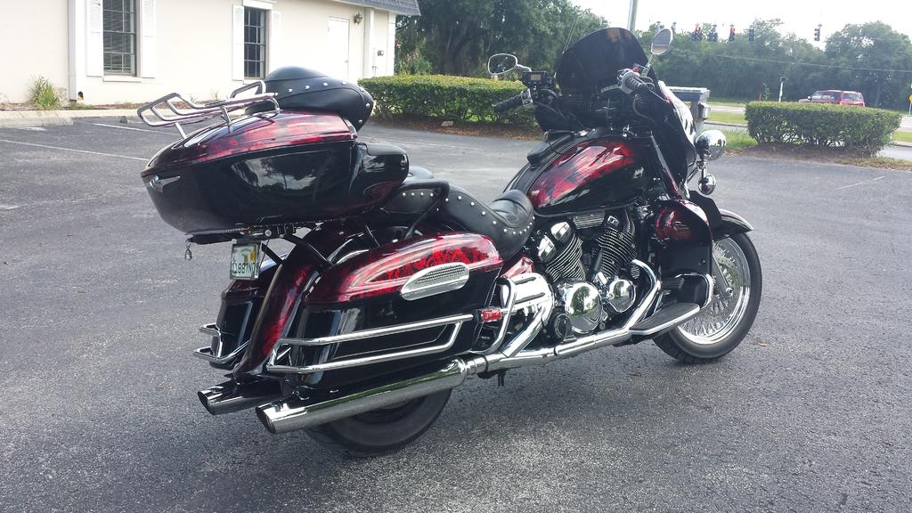

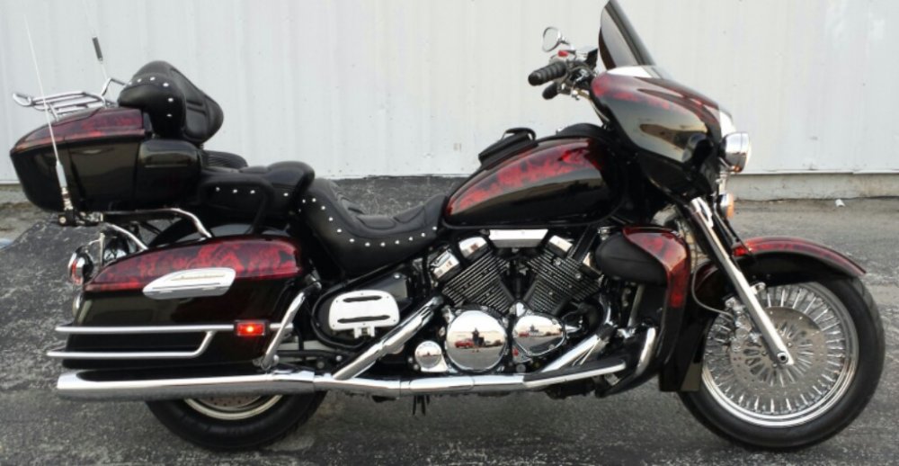

  5. Finally finished my Venture. 18 inch wheel, chrome R1 calipers, diamond cut everything, custom candy brandywine paint with Renegade hydrographic pattern, shaved rear fender and smoothed, led tail, brake and run lights under tour pack, hideaway rear tag.

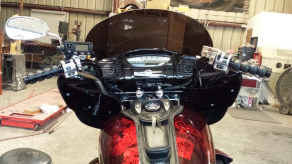

  6. The shield I bought off eBay. Just typed in 10 inch smoke shield for the venture. I didn't like the stock bars. They put my arms down too low. These bars put my arms straight out and in more control. Sorry I don't know what brand the bib is.

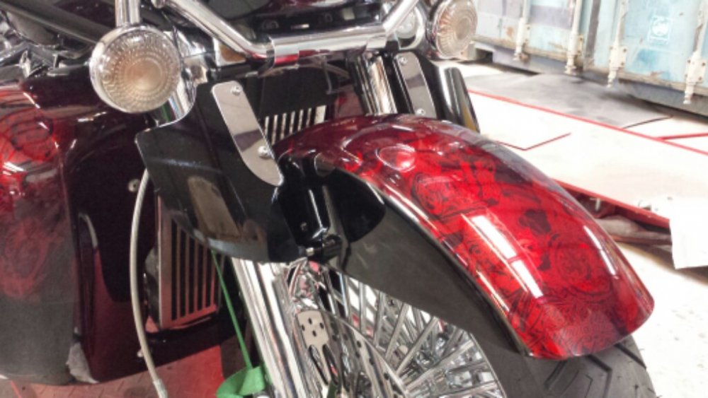

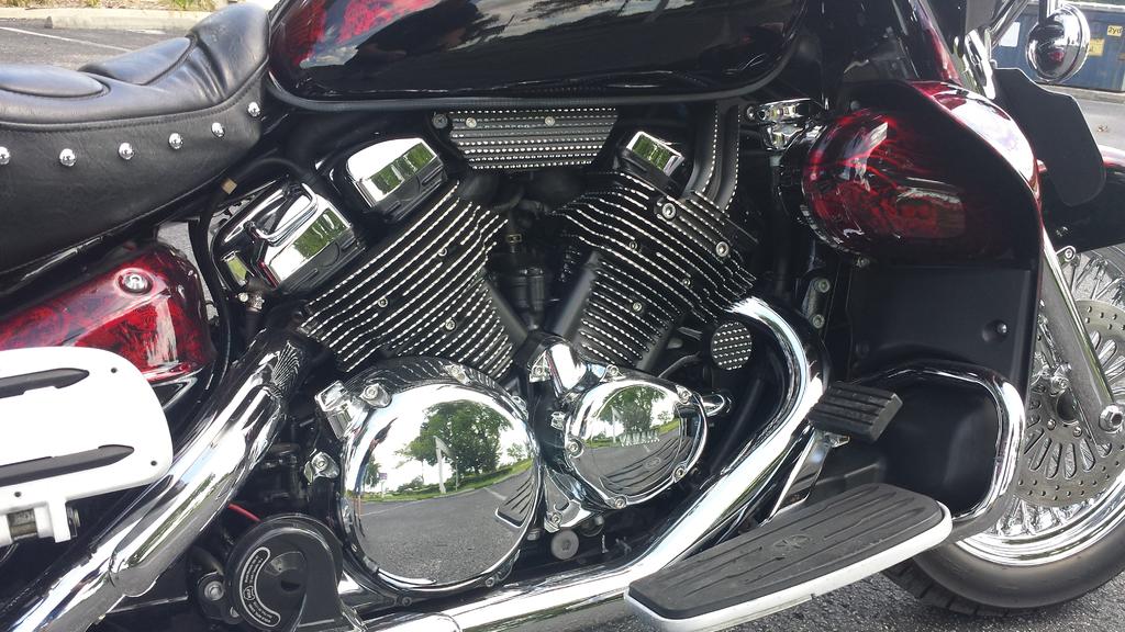

  7. I still have more to do. Painted and dipped the side covers, air intakes today. Also removed the chrome/rust rad cover and painted black and cleared it. Gotta install the new rear tire this weekend before my vacation.
  8. No change for wires, throttle or line. I did install braided brake lines.

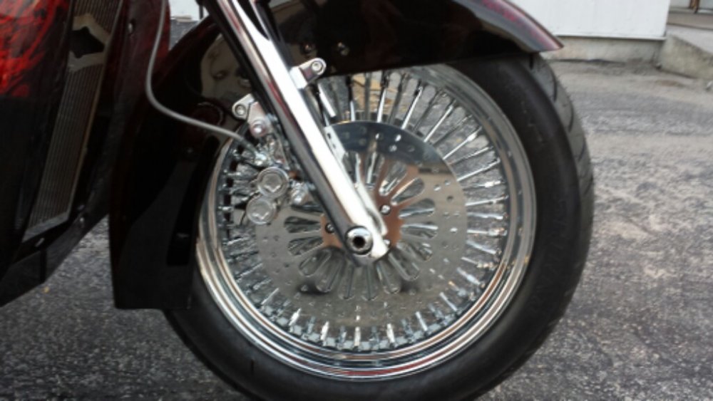

  9. The wheel is from Relentless cycle in fl. 18 inch Harley wheel with 1 inch bearings. Bolts right up using Brian Veney designs spacers. Then move your calipers in with 1/4 inch spacers. Its very easy. I installed a 21 inch wheel on my Road star when I built it. The bars are Krome Werks 10 inch bagger bars off ebay, 1 inch dia. Only $86 and I love them. the stock bars are to low and these put my arms straight out. Perfect fit. Just bolted right up. I'm trying to post more pictures but is not letting me. I'll figure it out.
  10. Yes. The hydrodip pattern is called Renegade. Dipped over candy brandywine. 1/8 inch charcoal grey pinstripe and black to finish it off.

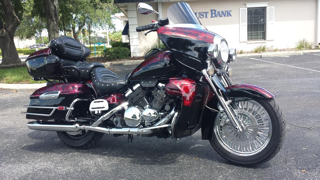

  11. New to the group. Thanks for the add. I just sold my Custom built Road star Bagger and decided to by a venture to customize. I haven't really seen one yet. Purchased this 01 3 weeks ago and it has come a long way in the last 2 weeks. Adding 18 inch 48 mammoth wheel, matching rotors, chrome R1 calipers, steel braided lines, Harley FL front fender, the diamond cut guy head covers, chrome Allen head engine bolt kit, 10 inch Bagger bars, chrome hand controls, new grips, 10 inch tinted shield, and a whole lot of paint/hydrographic work.
