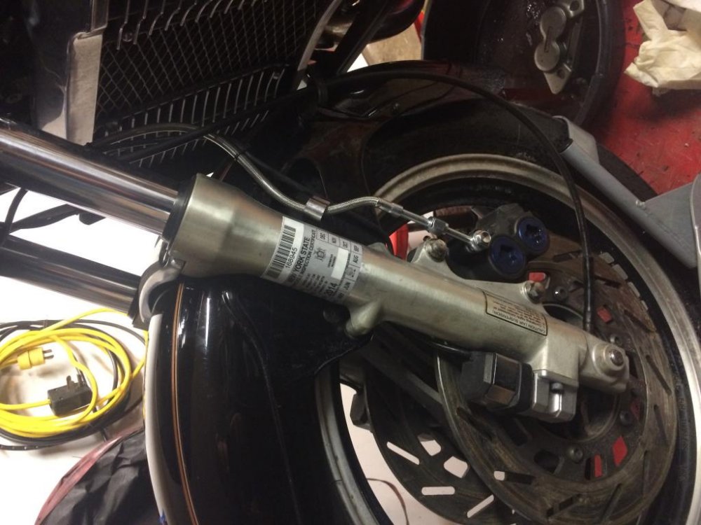

  4. Installed r6 calipers and stainless lines on the front today... Plugged the front line at the rear master and gutted the proportioning valve... Also installed new tires today and drained the coolant as I need to fix the leak at the drain
