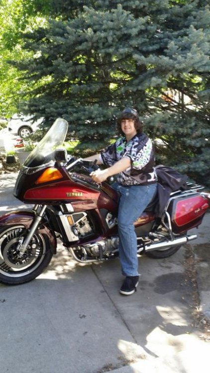

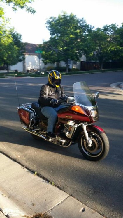

  2. Thanks guys for all the help!! He loves the bike!!
