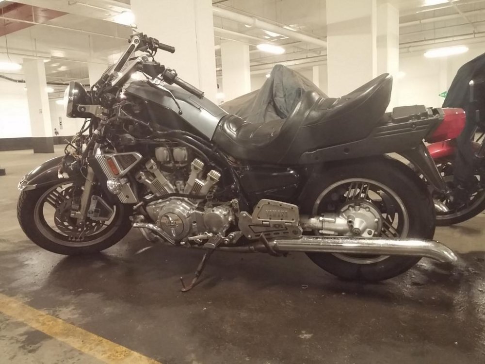

  6. So i am now an owner of a VR 86' 1300 and i am planning on stripping it down and transforming it into my own creation. I am going for a Vmax VR hybrid look and i am seeking some help with a few aspects of getting to the end goal. I have run into some trouble both weird and normal: Taillight, head light, blinkers: These run through the CMU (dash unit) to work correctly, and i have little experience dealing with electronics to come up with a solution in order to bypass this. I guess i can do some splicing but i am wondering if anyone's done anything like this or has other possible solutions in mind. Idles fine but slowly dies (SOLVED) ALSO - i cannot tell if my radiator is working correctly without the CMU connected. The fan doesn't seem to want to work either and i am not sure how i can work around this.. Maybe rig the fan to run 100% of the time? Still have no idea how to figure that out. Currently what she looks like (beautiful): The end result would be chopping that tail end off, shrinking it down, replacing the seat to something more smooth, replacing the headlamp with something meatier and finally obviously replacing the old handlebars with something else that i have not fully decided on.
