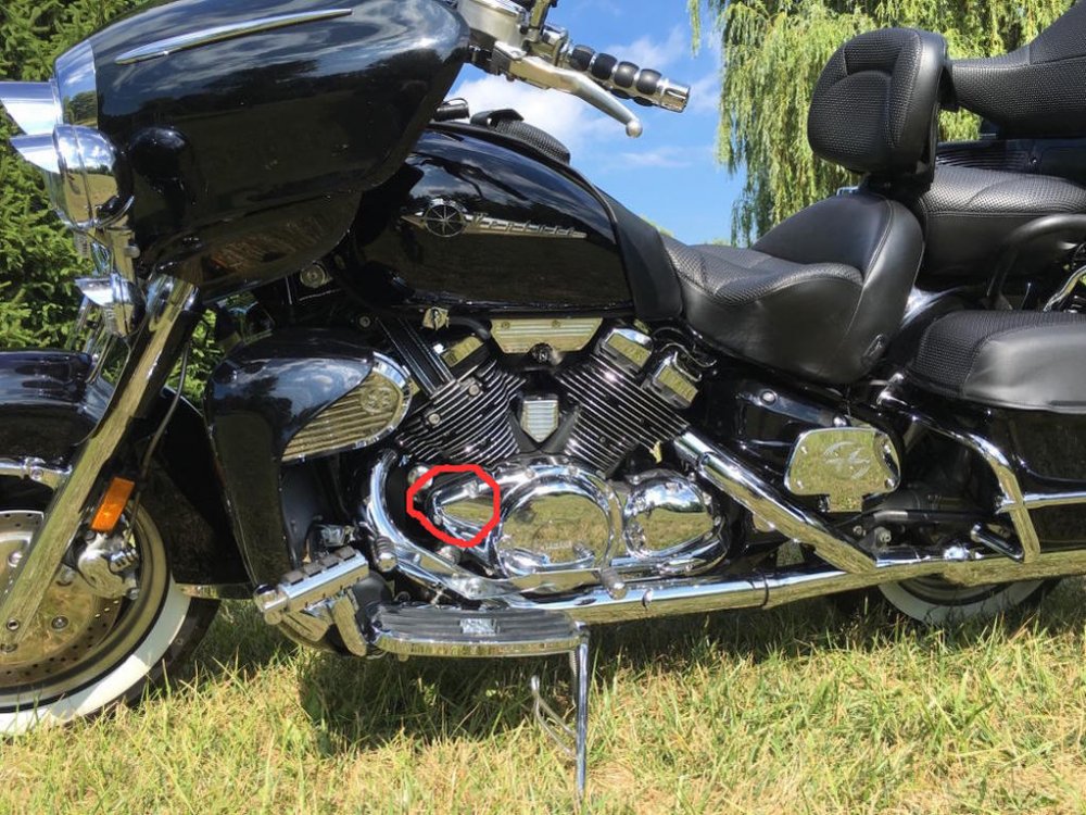

Problems with the Trike.
Flyinfool replied to Brenda H's topic in Royal Star Venture Tech Talk ('99 - '13)
The starter is right on the other side of the top front point of the left side cover. Circled in red. Please ignore all of the Chrome and shiny paint, this pic is Dons bike not mine.................... -
