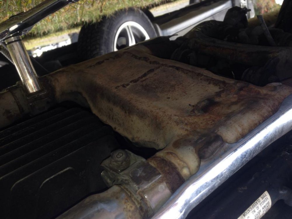

  7. When these start leaking, where the initial leak from most of the time? my exhaust system is in pretty good shape however I have a fluttering when I crack the throttle. I have tried to locate it but it seems to be coming from the top of the collector between the engine and clector. I have a budget of 30$ for this(not kidding) can this be an easy fix or is it a can of worms and should just live with it?

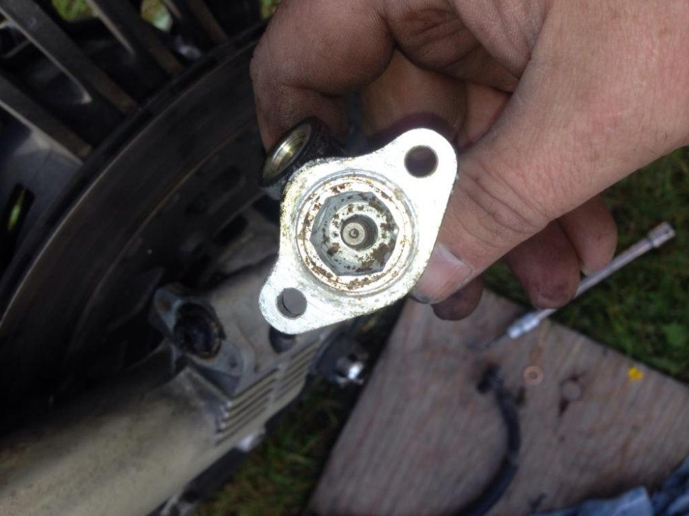

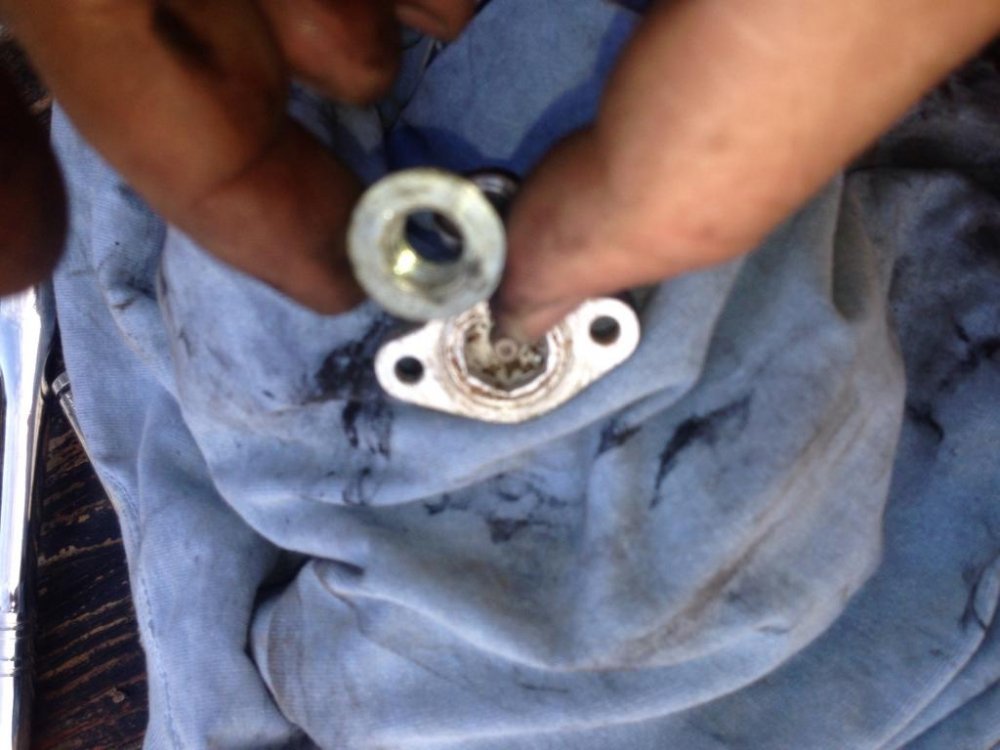

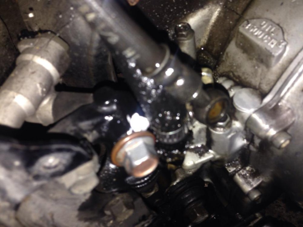

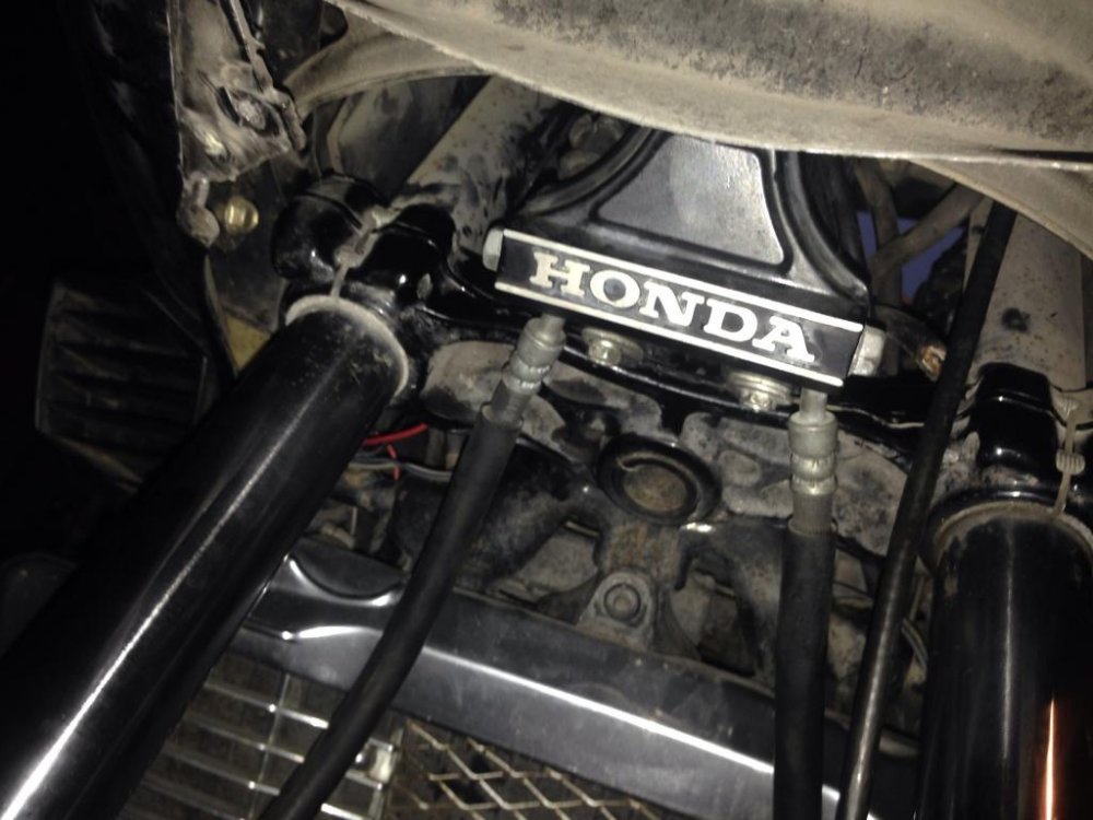

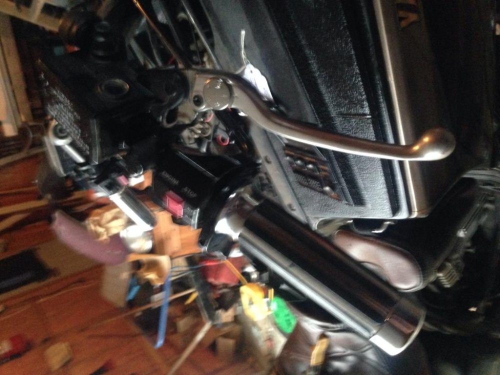

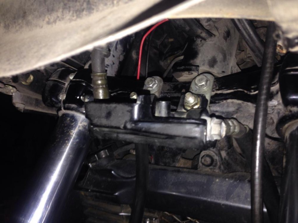

  9. I have brakes! I used the lower brake lines, banjo bolts and split from a Honda Sabre. The I used the main line from a Virago 535 and finally the master and lever from a 2010 fz6r. the upper line is too long so I had to route it west to LA then back East to NYC. I just need to splice the wire going to the brake switch, zip tie the splitter to the lower triple and Ill be done. Anti dive is history btw. No road test becuase of rain but lever feels great. At the rear I used a stubby bolt (with big copper washer stolen from a head bolt) that I stuck into the master to block off the line going to the front. I had to grind off that little nub on the master that the oem line buts up against. Rear brakes feel great as well. Very happy, total cost of Zero dollars on this fix. edit: I juste ordered a set of front brake pads for it 10$
  10. Ok so its normal for the front lever to operate the right caliper only. That is insane! I have an almost brand new front master cylinder from a 2012 Yamaha FZ6z that should be decent. Bad timing however is that I had 9 parts bikes in the back yard and (80s yamahas and suzukis) and I called the metal guy to get them hauled away 2 days ago!!! I bet my brake lines were in the there. I even had a maximX 700 Ok best not to get discouraged. For the rear master. Where and how do I cap it? Does anyone have a photo? Everything is very well hidden on this beast
  11. Work continues to get this beast adventure ready. BRAKES!!! Ok guyz brakes need to be sorted badly. I removed both front calipers to inpect pads. Right side brake pads are worn out. Left side brake pads are almost like new. While riding, front brakes are mushy and rear brakes are... Hummm. AWOL. I decide to bleed front first. Right side bleeds well. Then I move to the left side. There seems to be zero connection between front master and left caliper. Zero squirt on the left even with the banjo bolt removed from the caliper. Now I hit the rear brake pedal and "squirt!!!" fluid comes out from the left front caliper line. What kind of evil manure is this!?!? This is a linked system and I dont understand how its all linked up. Is there an easy(read cheap) way to seperated front and rear to make it normal again?!? I want rear brake action when pedal braking and dual caliper front brake action when squeezing lever. side note: i also need to find metallica black album and kill em all on cassette
