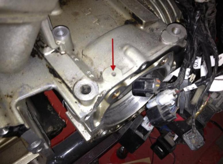

Good price for 1984 Venture?
gaj1917 replied to Lug Nut's topic in Venture and Venture Royale Tech Talk ('83 - '93)
The 2nd gear issue is a big one, and it will happen - very, very expensive if done at a shop; very, very time consuming, but less expensive, if you do it yourself. If this bike has had the 2nd gear issue fixed by a pro there should be a punch mark on the engine case just above the middle gear on the lefthand side (see photo). Then there's the overheating stator issue. And, of course, the plastic water pump impeller. I'm familiar with all these issues - I have an 84. Did I miss anything? -
