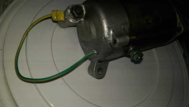

  6. Hi, Since I have the bike almost in parts I decided to make an extra ground wire. The bike is 1984 and starter motor two brush. I was hoping to get bigger wire through but was unable to fit it nicely inside. It ran nicely on the bench but since no deeper understanding of electronics I thought I check this with you. How big a risk is this wire to burn or overheat during cranking ? if any ? make it shorter ? remove insulation ? Thanks, Anssi ps. my next question will be about the starter gears. They fell off when removing the stator cover
