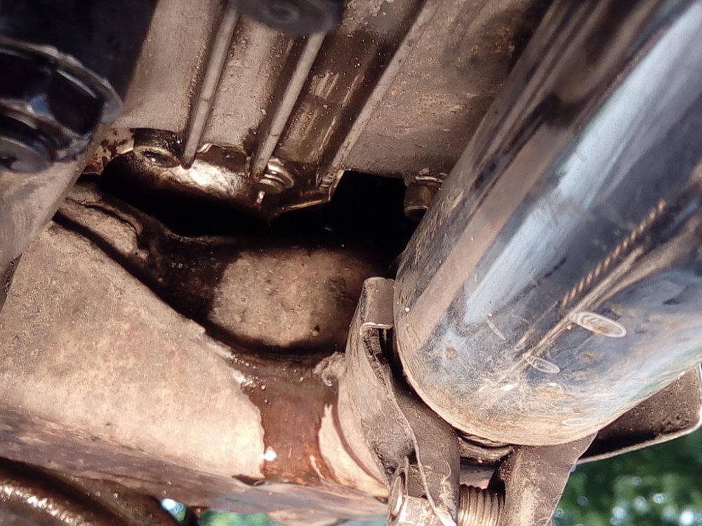

  11. Thank you very much for great advice. Well it seems user error again. Little progress. I was trying to trace back the steps I've done to this bike. A lot of small things, some forgotten. While fighting with the clutch slave I had changed the middle gear cover bolts to shorter ones. Could have not thought that exact lenght is critical. Originals were in bad shape. I changed them again to match the original lengths, not sure whether I got it right. The leak onto collector is away! Still couple of drops on the left side but no smoke when I park. Could it be that the bolts hold also something else than just the middle gear cover. I still get 2 drops when I park. The bottom bolt has new copper seal and that seems to hold, so maybe stator wire thing...or something else. maybe for now I live with this and move on cause there is still whole lot to work on eg. no high beam light, battery warning light etc. Maybe the bolt lenghts are something to remember when leaks occur. I have a habit of replacing old and worn bolts while restoring. Again great support from you, many thanks

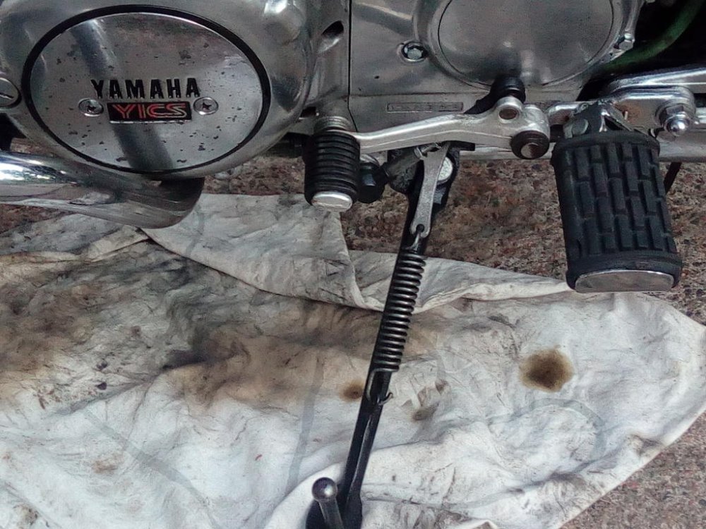

  12. The hunt continues. Cleaned the bike from under and tried to reproduce the leak while on centerstand. Didn't leak much at all. Good news the cooling system is quite effective. it took a long time for the temp to rise. Thinking back maybe I should have had the bike on the side stand tilting left. That's the side where it leaks, still wasn't able to pinpoint. I had some twobyfours under the middle stand to lift the bike little higher so I was able crawl under there while the bike was running. That was little scary. Didn't get burned. I wonder could the middlegear cover leak onto the collector. That cover I have taken off numerous times when fighting with the clutch slave. So tommorw I'll seal the middle gear cover again and hopefully better. If that doesn't fix then it's collectors off. I'll asked about that if needed.
  13. Thanks for quick reply. Good tip. Valve covers felt nice and dry when stick my hand there(engine cold). But it let to think the chain tensioner. Maybe that could leak. It's pretty dirty back there, couldn't tell whether it was recently leaked. So I'm going to ride the bike this evening so i'll check the chain tensioner. I'll get back. Thanks, Anssi

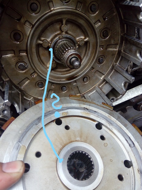

  16. Should there be spacer or something between clutch basket and clutch boss ? I'm asking because the clutch was stuck and only way I could get the clutch to work was loose little the center bolt. Here's background. I've no idea of the history of this bike. It runs but the clutch didn't work. This is how I recall. There was no fluid when I started. Day 1 Put fluids. Bled the clutch. Lever comes only little in. Doesn't work Day 2 Revided the slave cylinder. Bled the clutch. Lever comes only little in. Doesn't work Day 3 opened the clutch cover. push rod was stuck. got it moving. The clutch doesn't work. Day 4 Removed the slave and the clutch cover. The rod was moving. Put the pressure plate back. The clutch doesn't work. The push rod was too far out. Pushed it in. Bled the clutch. The clutch doesn't work. The pressure plate was moving nicely when I pressed clutch Revided the master cylinder. Bled the clutch. The clutch doesn't work. Day 5. I took the friction plates out until the string. wasn't able to move separately the boss and the basket. There were stuck to together. Started to open the big middle bolt holding the boss. Only then the basket and the boss were moving separetly when the middle bolt was loosened. If I tighten the center bolt again isn't that like having the boss and basket bolted together if there's nothing between. By now you might know that this is the first time for to work on xvz clutch. The slave and the master are working properly. I can see the pressure plate moving nicely I tried to look schematics, but didn't understand Thank you in advance, you know these things so well. Anssi
