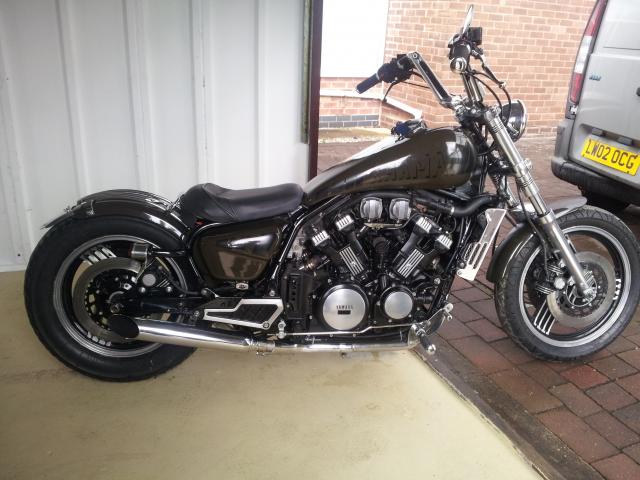

  • Bike Year and Model
    1985 Venture chopper
