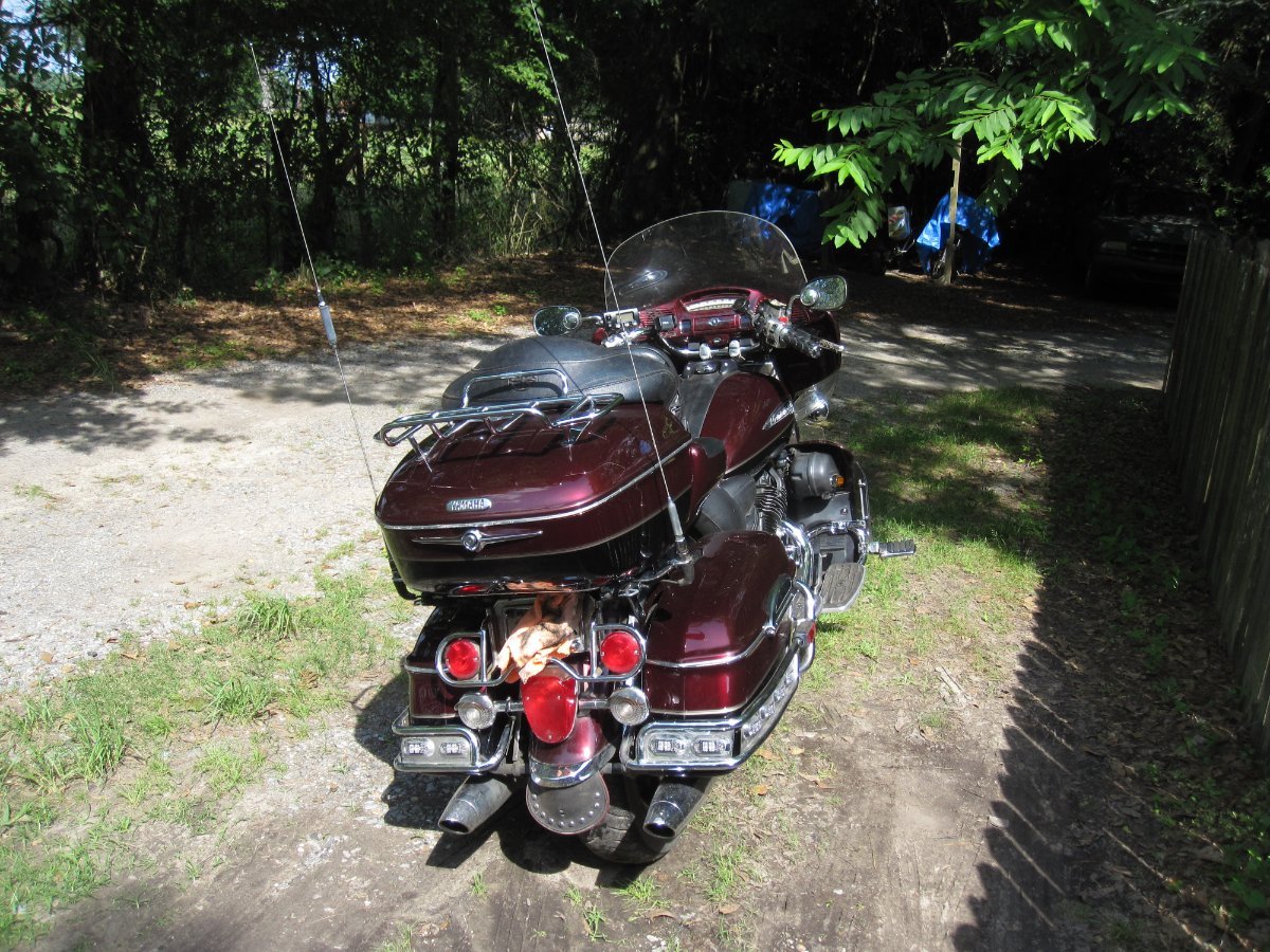

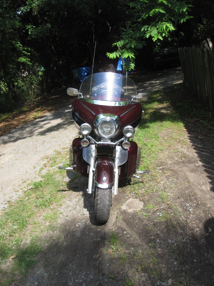

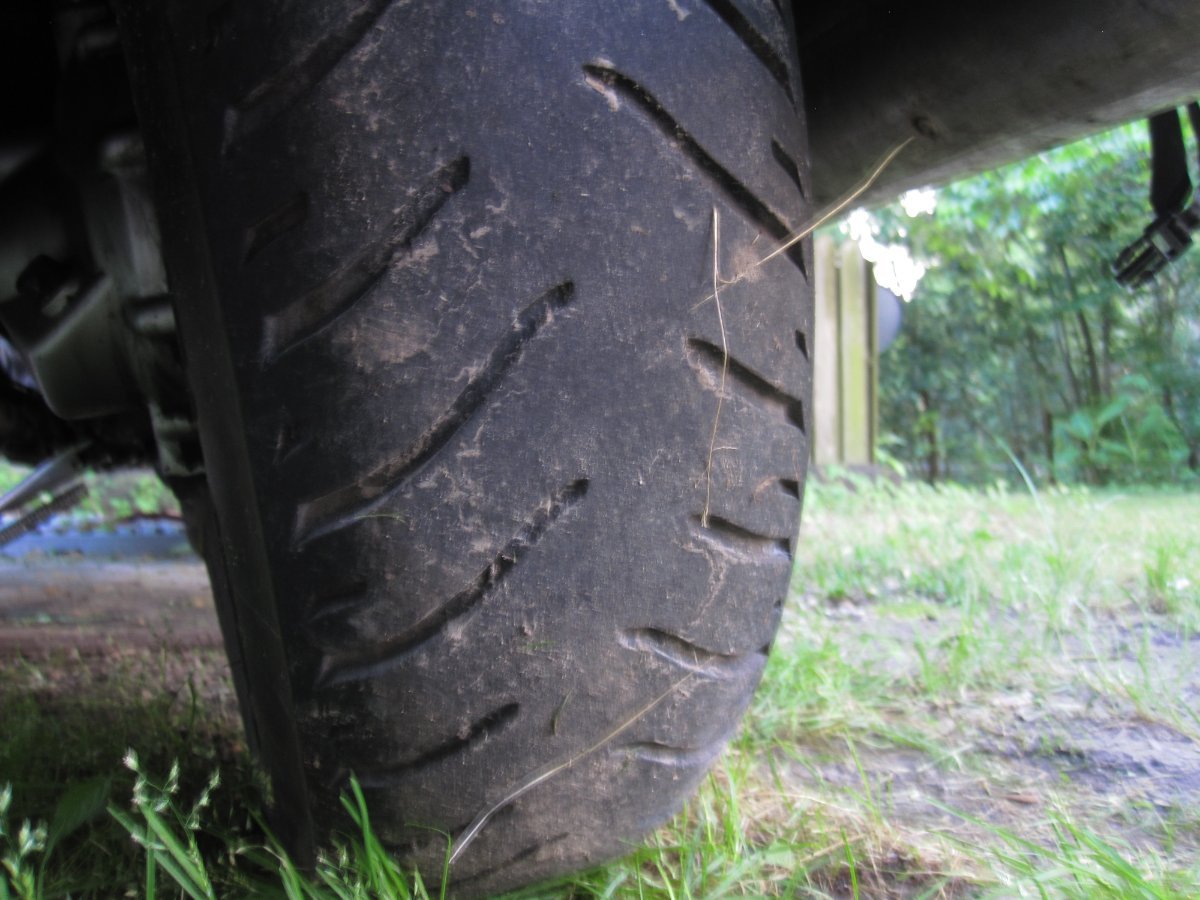

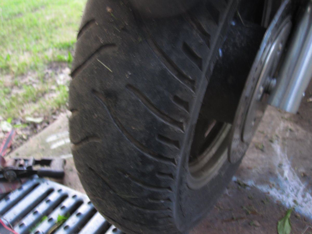

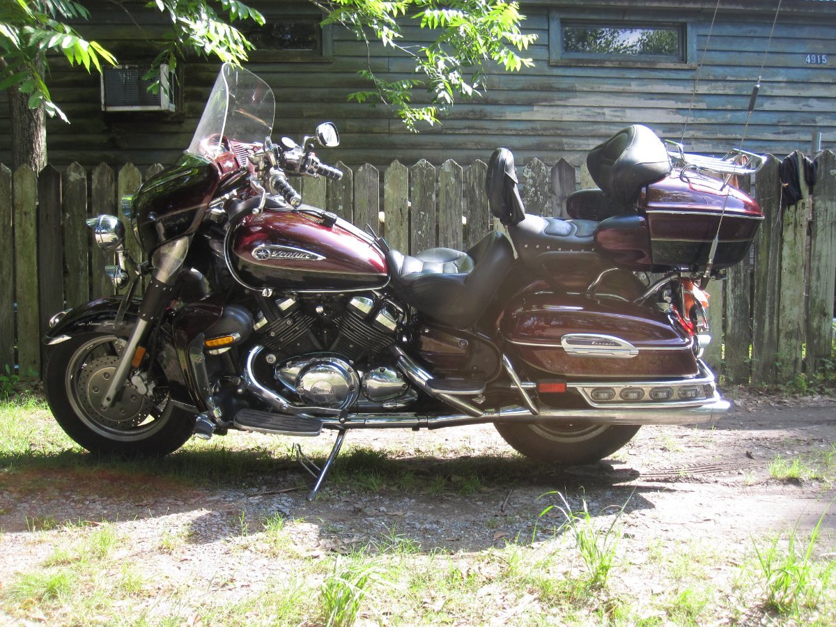

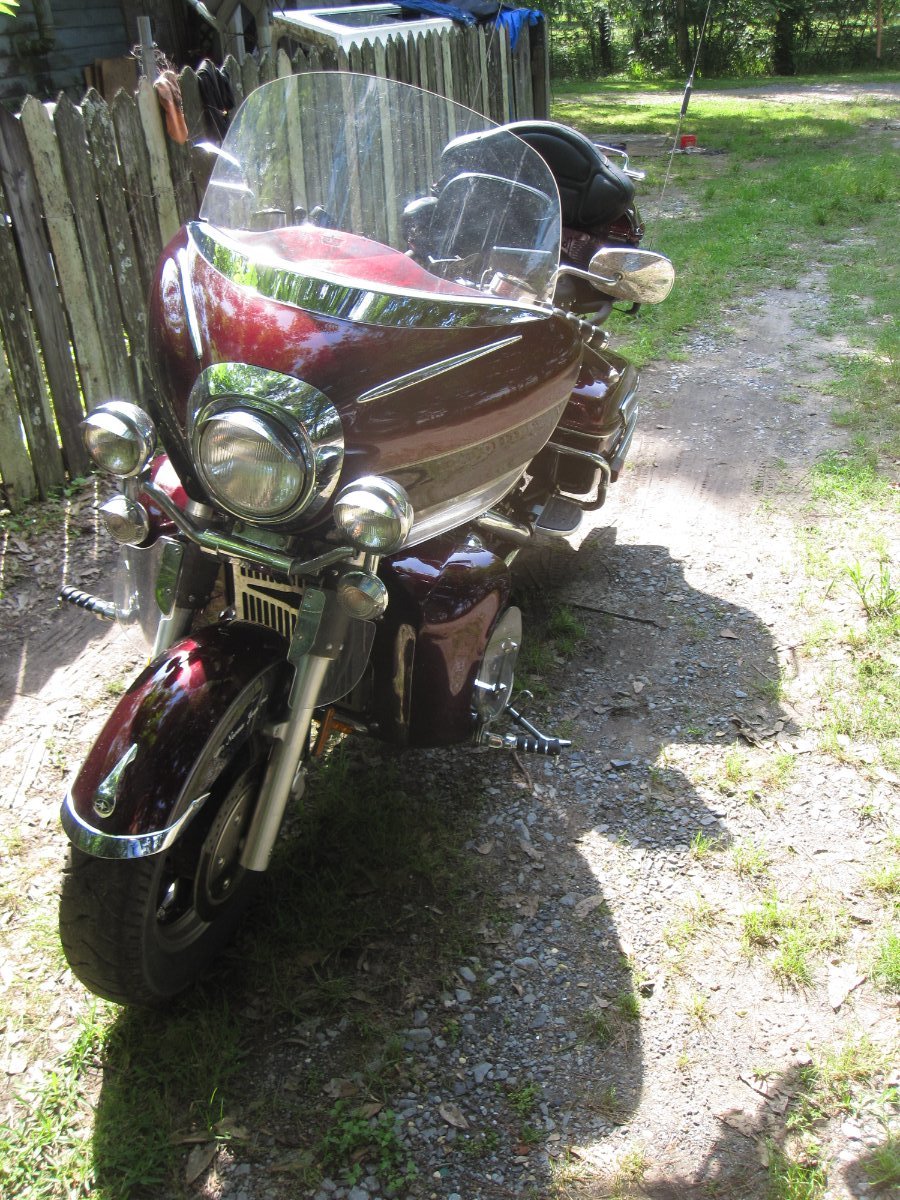

2008 Royal Star Venture 34,000 Miles Located in Port Allen, LA It's been a great bike but I'm moving in a year and need to thin the herd before then. It runs well, starts right up, everything works as it should. It has a brand new battery. No leaks. Tires are E3s with more than half their life left and it comes with another take off rear E3 (if you want it) that is still about half-way there too. Comes with the original tall windshield, alternative muffler tips, extra fuel pump and a few other parts if you want them. Extras: Hagan rear shock Russell Daylong Driver’s seat (tall) Rear Raising links Bag guards Chrome Radiator Protector Barnett Clutch W/heavy duty springs Rick’s Electric high output stator and regulator Crash bar reinforcement (under foot boards) Bar risers (with properly re-situated support for fairing) Running lights adjustable wind guards at lower fairing Highway pegs Kuryakyn Grips Harley triple tail light and tail guard set up Stebel Horn LED’s installed around bag guards and lower fairings. (One red LED is out in back of bag guard) ----------------------- Clean title $4,500 https://www.facebook.com/marketplace/item/610996627758383
