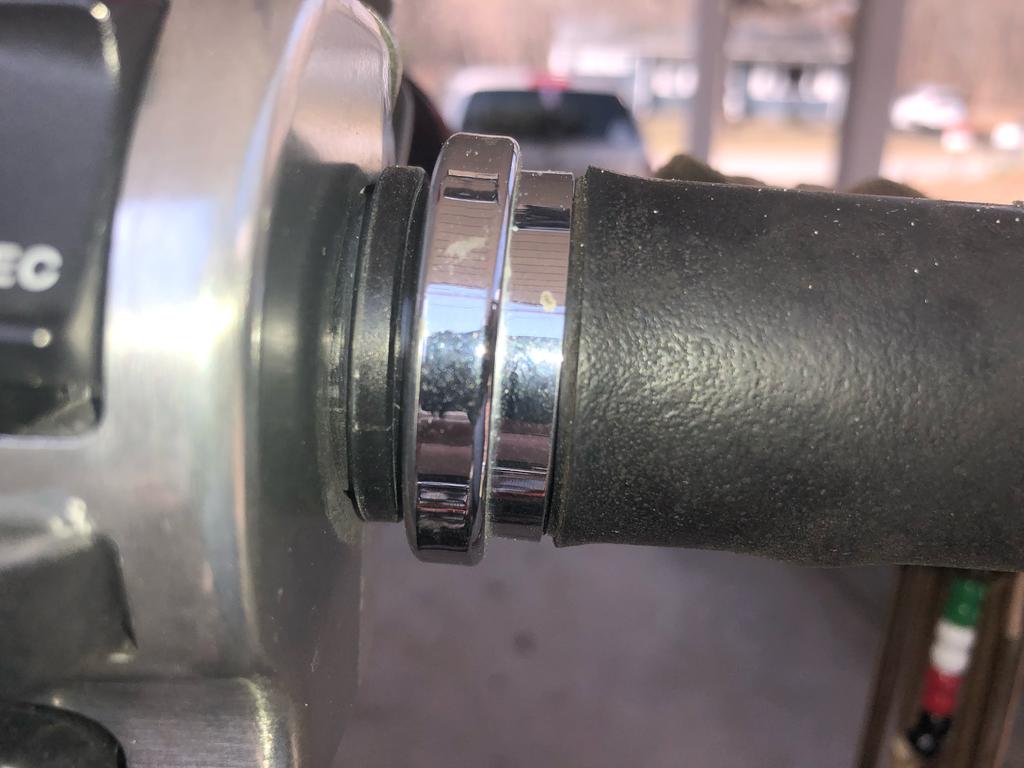

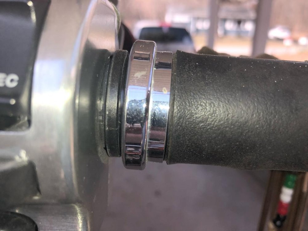

So, as I get my ride ready I found this. Now I hear changing grips is easy, but for some reason I’m pretty concerned about it. This seems to be shot - looks like the black ring - inner holder outer has fallen out of where it belongs. I have no issue with the eOEM grips, so can I just take a knife edge and jam it back in?? Or do I just swap out the grips? With new grips what do I need to look for? Some aftermarket knockoff ISO grips would be fine. Any suggestions?? I’m not fussy. Thanks as always...

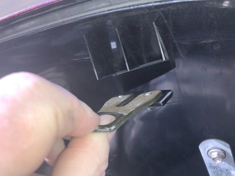

So one of my latches brok off - on the lid. I saw some posts where gluing with ABS cement doesn’t work very well, and it seems the best results were in 2012 with stuff called “Ultra Bond Plastic Epoxy” ( I think), which I cannot locate. Have there been any recent successful results?? Gorilla glue? Maybe another Epoxy? Thanks
So ... really, how easy are they to change? Anything I need to know while shopping? 1" bars?? TIA
