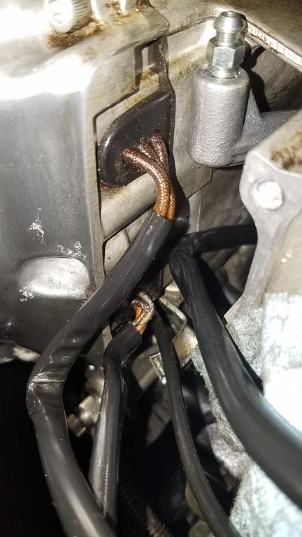

  1. After 2 runs in 2 days, she still leaks. About 260 miles. I'll run her back home after I do some work on the RSV. I need the RSV back up to phoenix by the 6th as we are making a run on the 7th up Schnebly Hill to Prescott. Then 260 to Pine and Payson... Then back to Phoenix. Be a long day but nice if weather cooperates! I'm going to go ahead and check what I did last week, then take stator cover off and clean/ goop both sets of wires. Plus see if I can get to the shift shaft that is under the final drive bearing. Probably should have done this before but my plans got changed for me....I don't like being rushed on a project..... But that's the breaks with an Admiral!

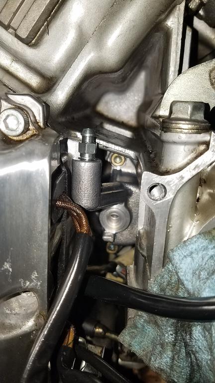

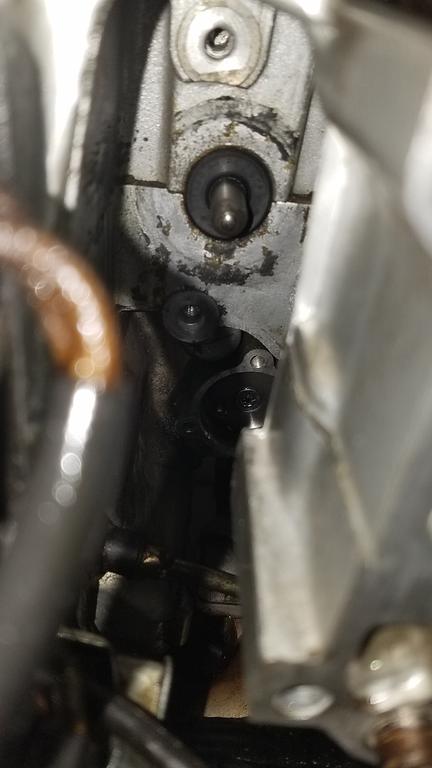

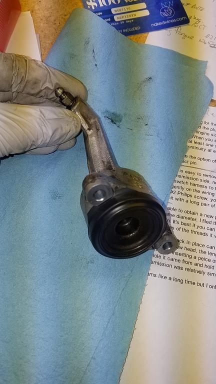

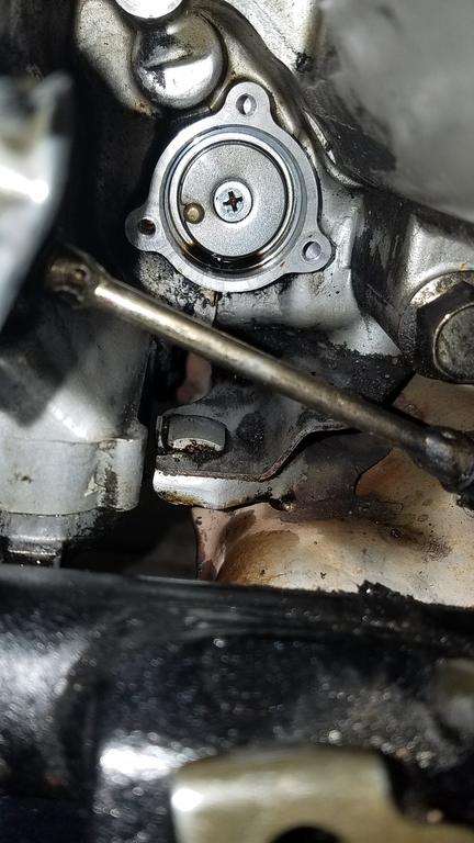

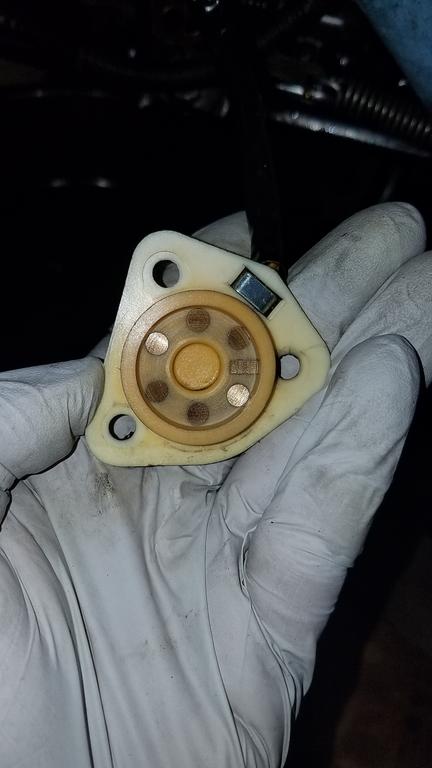

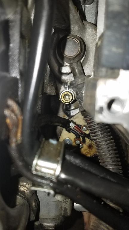

  8. Gentlemen, You will need to take the side cover #2 off. And yes, Yamaha calls it the push comp thingie... You will need that gasket. Plus, get the little washer that goes in the bottom bolt. I would also get the neutral switch gasket, an orange thing, as it tends to leak with age. Be very careful taking it off as the screws should not be tight. Just snug. Same with the hex screws on the cover...snug. I think around 8 ft lbs. 100 inch pounds? It's in the same area as the slave...just below it. The slave comes out with two bolts after taking off the clutch fluid line. My slave came out after I moved the stator wires from their location below the area to above and tied them there. Be gentle as to much horsing around can cause the wires to leak where they come out of case #1 . My slave dropped down into the area where the wires were, I tilted the top forward a bit and out it popped. Just gotta hold your tongue just right?!! I put a new slave in, new switch gasket, and cleaned everything very well. Put new gaskets in...don't go with old. Save old for an emergency. They aren't expensive. Why risk a leak. Oh...torque everything properly... Hope this helps. Pictures available on this site....even a full blown tutorial with pics... I have some too if you want/need.

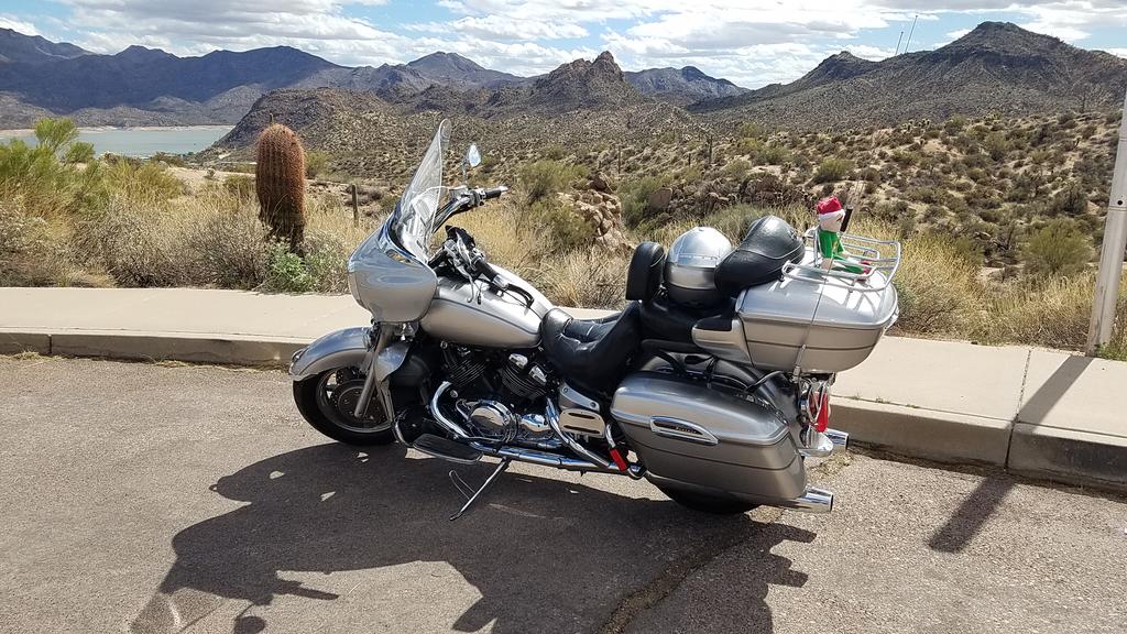

  15. Jumped on the scoots today for a breakfast burrito in Fountain Hills. Then took the back roads to Rio Verde and over to Lake Bartlett. both scoots...We stopped at this overlook just above the lake. Liked the view better... The road from Carefree to the lake is truly fun to ride. Lots of curves and beautiful scenery to boot. Wish i had the Gopro with me...the ride to the lake was nice. We had a warm day with cool wind. 70's. Enjoy! OH...think The Hideaway in Cave Creek was having a party. The bar/restaurant had a gazillion bikes parked all around it and the music was loud enough to be heard out on the street. Wish we could have stopped.... www.hideaway-usa.com Cheers to my ice-bound friends!

  20. Yes....on my 89 it called for around 100 inch pounds...I simply put my hand over the wrench and turned each bolt evenly until I couldn't turn anymore. With my hands, I bet I was around 8 ft lbs. Not much torque using the palm of your hand. IE, just snug them up in a alternaing pattern so they are even. There isn't any high pressure oil there...just oil.

  22. Thanks for the pictures and sorry for the delay... I suspect those broken tabs are sitting there inside the fairing. If you take off the panel that the CLASS system controller resides in, you should be able to find the parts then do the plastic repair thing. There is an inner fairing under all that stuff that catches wayward runaway bolts, nuts and plastic. In fact, you can probably McGiver something with plastic, or weld/epoxy a washer or two and a bolt or something similar. It really isn't rocket science on these bikes. Whatever you can come up with will probably last longer than the original. BTW, if the screw mounts that hold that whole right side panel on are broken, you can cut small square pieces of black ABS plastic and melt them/epoxy them underneath the holes (found that fix on the forum) or even use small washers pressed in the holes in addition to the bottom repair above (did that too). Stronger and looks fine. There are all sorts of tricks I learned from searching this forum. I have the attitude that I'm not the 1st to have this problem, and then see if I can find out who solved it. Fun Stuff, really! Regardless...I'm watching to see what you come up with...maybe I can find some of the posts I was talking about and save you some time...I'll look but heading out of town in morning.... Found one of the posts....here's the link...I found the 1st response to be excellent info on working with plastic. I found the 2nd response easier for me to deal with on my repairs for the panel. This is what I was talking about above.... http://www.venturerider.org/forum/showthread.php?106178-Repairing-RT-side-dash-panel-with-ABS-MEK&highlight=Class+panel+repair

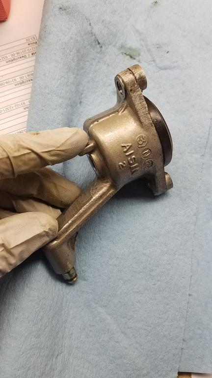

  23. The oil filter O ring around the bolt leaks. So much for Fram putting in the correct O ring. I'll deal with this when I get back in town... Clutch and area around slave is dry after a 5 minute run. So far so good... Now back to your regularly scheduled life! Bartender, set em up for the gang...on me.......
  24. Well events in life have changed again...so much for plan A... The lady says she needs to get back to Phoenix tomorrow (Friday), so I'm putting her (scoot, not Old Lady!) together this afternoon. Took a long time to get the air out of the clutch lines before any fluid made it down to the slave. She pumped up quick after that. No leaks in clutch. But think I may be replacing the master soon as the relief hole keeps getting plugged and I've drained, flushed and replaced to many times. I rebuilt the master sent to me by cowpuc...so it should be ready to go. I know...I should be doing this now, but need to take the tools with me to Phoenix and don't want to leave the old girl naked and apart while I'm gone. Besides, I like working on these scoots...so doing the master again is good experience. That's my story anyway!! Now I'll go put some oil in and see if she fires up and leaks....
