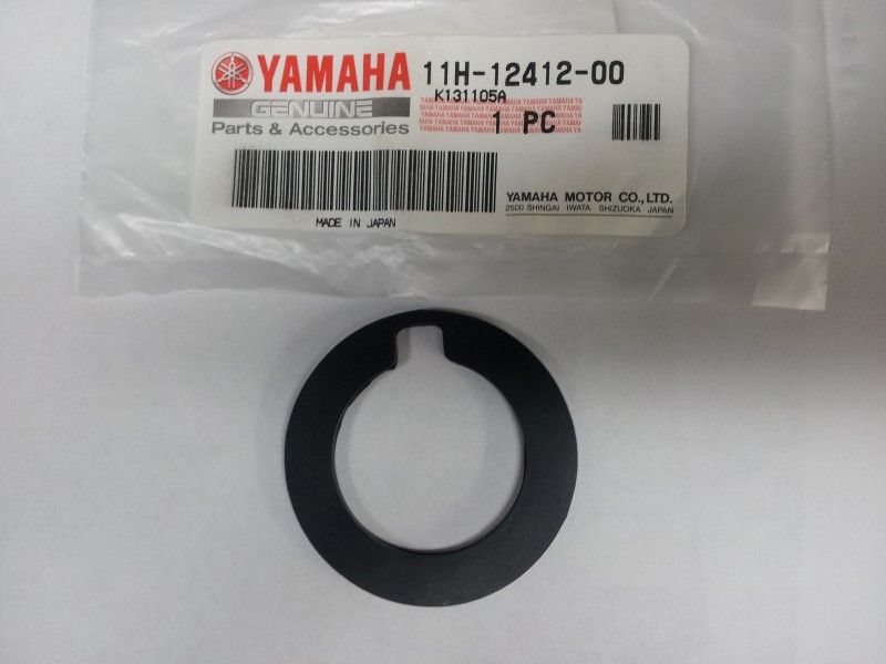

Thermostat seal??
bobber replied to bobber's topic in Venture and Venture Royale Tech Talk ('83 - '93)
The dealer insists that it is the correct gasket so I will go ahead and use it. Not a great fit with the Stant t-stat but it is the correct diameter. Many thanks to those that replied to the post. -
My 93 VR recently started weeping coolant from the thermostat housing. Annoying? Yes, but after researching a little bit it seems this particular problem has been experienced by quite a few fellow Venture owners. So, following their savvy advice I went out and purchased a new Stant #13758 thermostat, new plastic t-stat housing, new housing o-ring and a t-stat seal, all from the stealer. After a little persistence I was able remove the old housing and t-stat, thanks to some good advice found on this site. My issue is this: The new t-stat seal does not look anything like the old one and does not fit very well with either the old t-stat or the new Stant t-stat. The part# is correct and perhaps it is meant to couple with the original thermostat. There is a square notch out of the seal that seems out of place. Can anyone shed some light on this for me? Will this seal work or should I look for something else that fits better? I have provided a picture. Thanks for any assistance.
