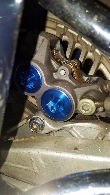

What's a "Blue Dot" caliper? I'm not brake system modifier UNLESS I use the master cylinder that was used with the different calipers. I'm too chicken. I don't ride hard or push the limits of the machine; I just ride. I have a passenger (2up) from time to time. I like the system as Yamaha designed it, I know that when your going to operate a vehicle off road the mod world is a much larger place than if you were going to remain on the road. Most engineers build something to suit most expected operating parameters for most people/loads. I imagine at least 60% of the members here ride that way. Making your own brake lines is a tricky thing, it's easy to kink the pipe with the right tools much less without them. I would like to put the stainless lines on my bike, they are expensive, but I hope to get mine this winter, not because I want/need the performance of stainless, it's because the rubber lines are 40 years old! They GOT TO GO and I don't know if anyone makes brake lines for our bike, I have heard of eBay sellers offering brake lines in X length, I'm not interested in generic brake lines or ones you have to turn at funny angles... I want t stainless we can get from one of the long term guys here. I have a pair or R-1 calipers and the master cylinder that came with an R-1. I have a fork off a 1300 bike. I just bought this '88, I'm not sure if changing the calipers out to the R-1s is going to be any better, I mean the 88 has 4 pistons per caliper as do the R-1s, the brake pads seem to be about the same size so I'm not sure if I should go through all that with my riding style, we MAY get a trailer one day, but we figure if we NEED a trailer we should take the truck! Any advice (as always) is appreciated! IS THIS A BLUE DOT CALIPER? What if the blue dots are red, is it still considered a blue dot caliper? -

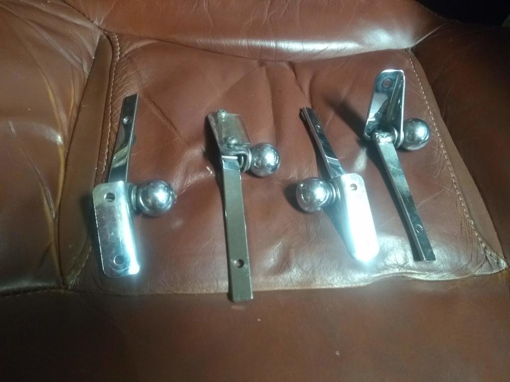

Nope! I think the windshield because the piece of plastic between bolted parts... look at the 2nd from right, we got the same idea, just a different location... -
I found these in the saddle bags on my '88. I think they are used to hold windshield extensions that can pivot. If you look closely you can see a piece of clear plastic on the one that is 2nd from the left.
