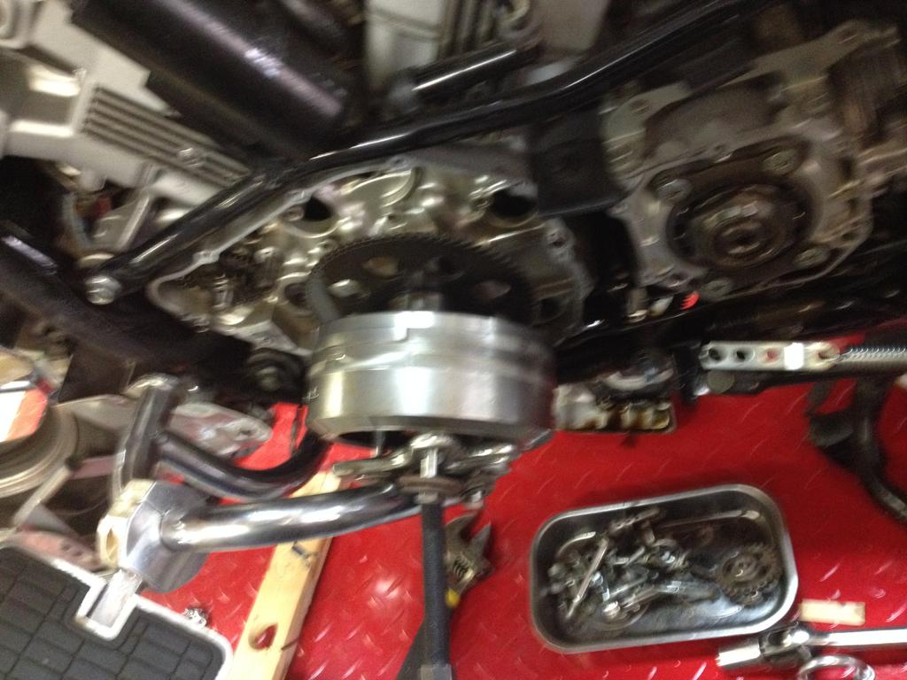

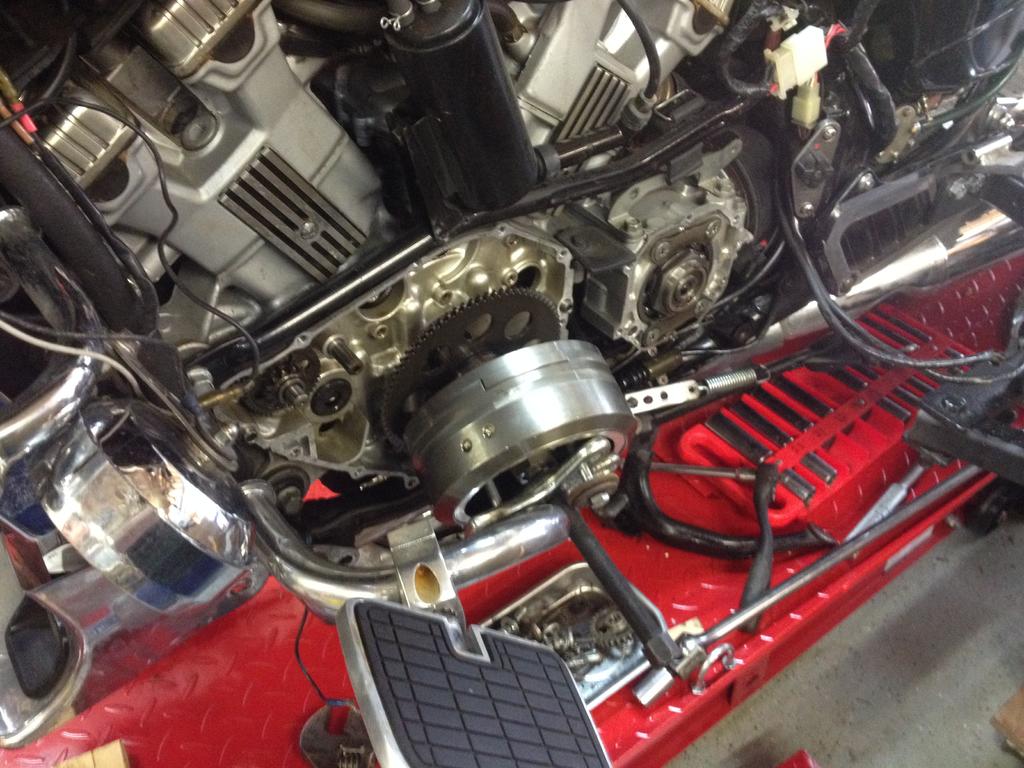

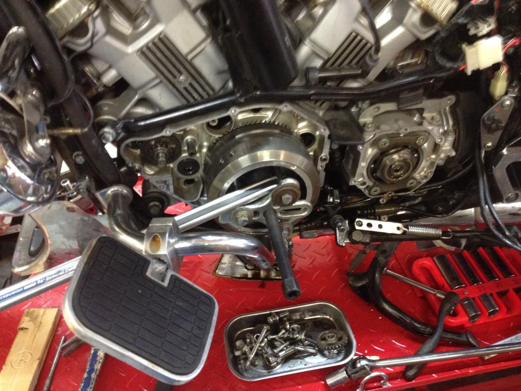

So the first pic is of the bike taken by the PO. the 2nd is the starter clutch under tension from the puller. It was left all night with tension on it but it was still VERY WELL IN PLACE in the AM when I ck'ed it. 3rd and 4th are of the starter clutch loose off the crank shaft. BAM it came loose after a couple dozen taps with a BFH.
