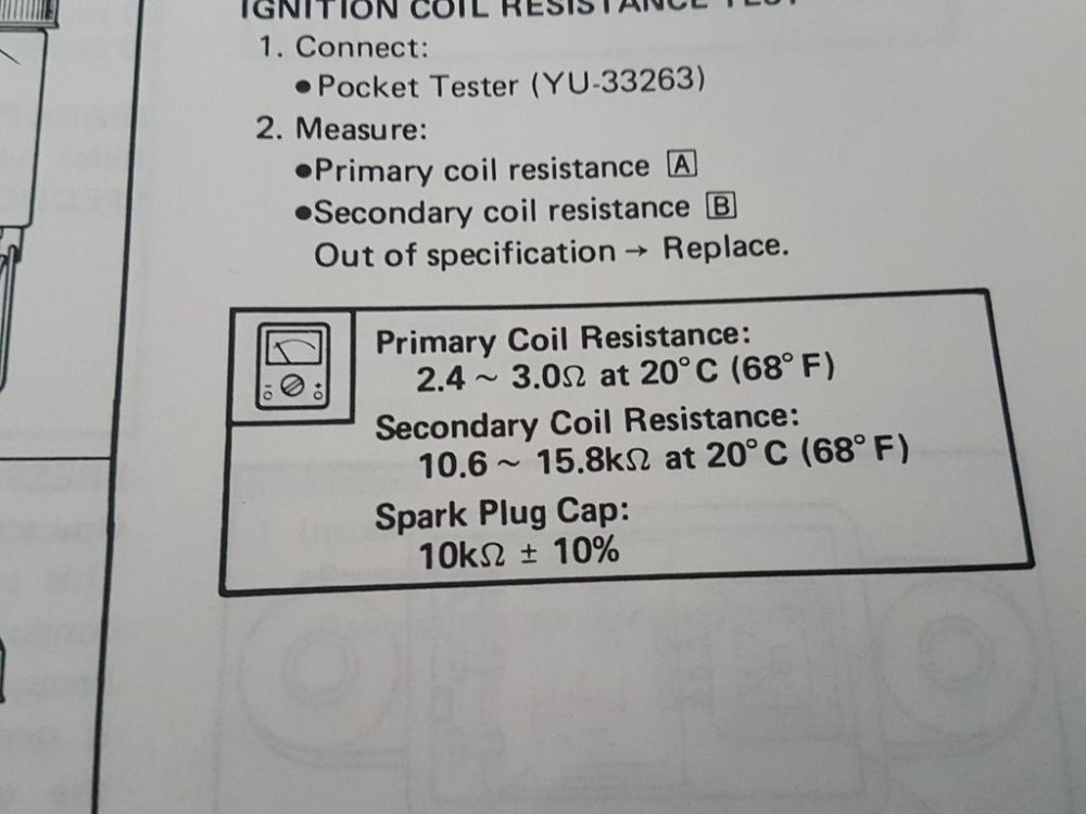

I've been kicking this around much of the day.. Not sure why we haven't asked yet? (likely Carl's fault tho) What is the voltage at the coils? need house voltage to compare Now seems obvious we would like to do a gap test for the secondaries, right? But I got to think about your ride, and wondered if the plugs are bridging to much air? Know what I mean... So have a look if you will because weak coils have little reserve and can miss even with a hot plug. Blue & Video, not sure if there is a question attached to the 5 verses 10? But might be best to start a thread and not distract from OP..

Not sure what temperature they were at when tested? Anyways, these are just part of a check list, but the ing. coils are 34 years old and likely they have lost there ability to charge quick enough. They too need to be hot to get an good idea
