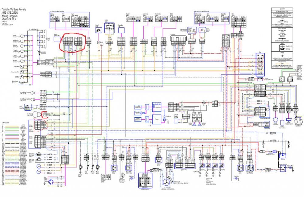

	  Another Dim Headlight PostPatch replied to Vickersguy's topic in Venture and Venture Royale Tech Talk ('83 - '93) You are not wasting time by opening, cleaning and checking contacts, weather they be connector or switch;) You can plan a new circuit to the lighting but, you should consider how to tie in the existing switches and monitor. I would use a relay if I were to do so. You mentioned earlier that the lamp is fed after.... in such a case you just keep probing till you get to the end of the circuit. If you have questions keep asking for answers, we enjoy watching others labor;) but, it is best to directly answer each question or the club may think we're overloading you. Flyinfool: asked "The blue/black wire is the one that is supplying power to the switch. It should show pretty close (within .5V) to battery voltage at all times that the key is on."? Marcarl: asked about the fuse box? By diving the harness at each connector and measuring drop you will eventually find the cause. Contacts you can restore and, if it proves to be wiring then you replace/jumper just the length required. Its not an unrewarding experience and truly expands your independence should chit happen out there somewhere.
	  Another Dim Headlight PostPatch replied to Vickersguy's topic in Venture and Venture Royale Tech Talk ('83 - '93) [quote=Vickersguy;1054142 I am loosing 1.4 volts through that run From where to where? Separate each connector then measure - reconnect - measure further along that harness, note down any additional losses. The worst offender is the kill switch but the key switch is not far behind. Separate circuit & issue I will clean the kill switch anyway. There is a forum post on that, which I downloaded. It gets complicated at the RLU. The dim switch is not directly connected to the headlight. One output from the RLU goes to the dim switch, then goes to the computer on the hi/lo wires. If there is a test I could do that would solve this I'm all ears. Just take it one step at a time and, one circuit at a time, answering Jeff's post clearly. I'm attaching a diagram the thicker circles are where you need to report voltage reading and please state the color of wire you read and voltage. The thinner red mark is after the bulb. Measure from switch, at each end of connector high and low beam wires Voltage loss can be from: switch contacts, connectors and the wire itself
	  Another Dim Headlight PostPatch replied to Vickersguy's topic in Venture and Venture Royale Tech Talk ('83 - '93) here's how to check this circuit 7-28 https://www.venturerider.org/wiring/83%20Yamaha%20Venture%20electrical%20info.pdf

	A couple of thoughts for you to keep in mind when you get back at it. What you will be attempting is best described as chasing ghosts; the reason is that you may find one obvious fail, get distracted by it, believe you’ve solved the problem but, more often than not on a 40 year old harness there’s a lot more going wrong then obvious. DuRon and Jeff are on to the same issue, and they are both right. But because you are sure its DC volts then safe to assume the rectifier is working!? The regulator seems to be hit and miss. Getting back to the front lamp circuit, if it has more than battery voltage metered at the head lamp then it has the same throughout that circuit green & yellow wires! There can be an exception to this only but if the factory harness has been altered then it is possible to have more voltage pertaining to one end of a circuit verse the other end. Example a broken green or yellow wire somewhere before the front lamp but still good further back so, one might just run a separate feed to the front lamp say from the relay and allow the rest of the circuit (flashers, tail light…) to be left as is! Opening the harness is common on old bikes. Cleaning every harness connector, switch and ground is in most cases a necessity. Not much information on your bike but I did read stator outputs from 30 to 50 volts. The rectifier & regulator or RR: The circuit I trace is the RR, the stator feeds it,(skipping over exciter..) when you turn the key on you feed battery voltage to the RR, the RR MUST see an accurate voltage, this means a clean zero volt loss, in other words true battery voltage! This on an old system is a lot to expect, so, every contact point must be cleaned and this includes harness connectors! Also this RR needs to switch open/closed constantly, it does so thru the ground/earth and again this ground MUST be checked for impedance. These are the connectors I circled in green at the RR, so if you read no voltage loss there, you may be able to skip the ing. Switch cleaning; same for the ground check it there for impedance. Anyways checking the complete harness is the best way to get the bike to be more reliable.
