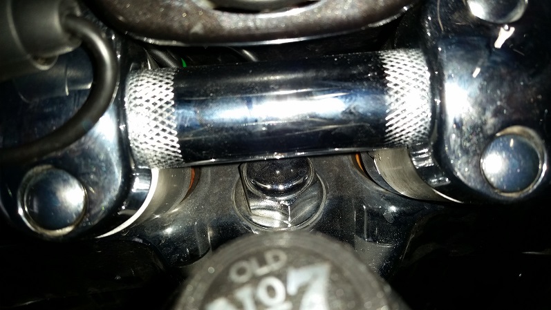

You are right the knurls on HD bars aren't as wide as the metric bars. But you can add more if you like. Majority of the knurls are under the riser clamps. I have tighten them to spec and they do not move. I have shaken them, turned the bars lock to lock, and no movement. Now I am sure if you slam into something or get hit holding on tight they would move just like any other bars. Here is a picture for you.

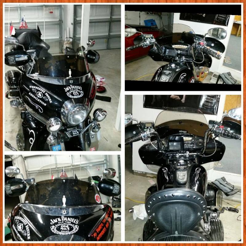

So I have posted a few times in years past of wanting to put ape hangers on my 2nd gen venture. I have owned bikes with apes before and always liked the feel and look. Well time finally came around...I found a shop that had a few different styles and makes of bagger apes. I tried a few different ones. I wanted to go with the Fat Apes but the 1.25" diameter reduced to 1" in middle for risers did not work. The width of the reduction was just a smidgen to small. Results are that any 1" diameter bar will fit. I went with the 12" Paul Yaffe Classic Bagger Apes. I already had the 1.5" riser extension so I left them as well. If he would have had the 14" I may would have gone that route, but glad I didn't because then the radio control wouldn't have fit I had already switch all my hoses and cables to SS from the Tour Deluxe back a while when I went to the TD bars. The throttle cables and clutch hose were long enough to keep. I had to go to a 24" SS upper front brake hose though. You will also have to extend all the wires for the switch housings. The radio controller fits but you have to go inside the fairing and reroute the cable to make it stretch enough. Put new ISO grips and DONE. Now it is time to put many many miles on these bars.
