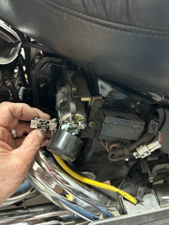

Fuel pump question
VentureFar replied to mike042's topic in Royal Star Venture Tech Talk ('99 - '13)
Bought the points off amazon. Replaced the fuel pump points at about 16,000 miles and now at 60,000. I don’t get many miles to points on my 2007 RS Venture. this is why I remain subscribed even though o only ride my Venture a few times per year. -
Fuel pump question
Just want to pop my head up and say thanks for this thread. I used to be active on this forum but now my Venture has pretty much sat for 4 years as I play with a Tenere 700. Went to go for a ride with the wife today and all I got was a slow idle and no clicking. I took off the side cover and tapped the fuel pump and voila ! gas. This isn't my first rodeo with replacing the points but didn't remember the part number. Thanks @Du-Rron -

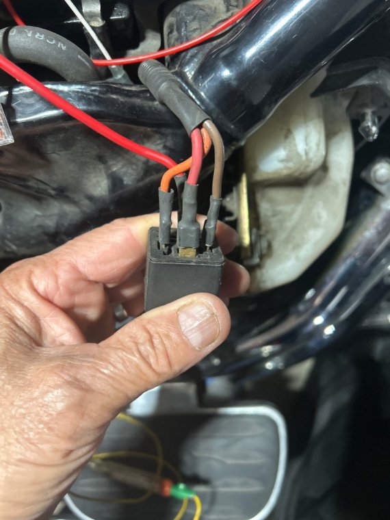

Help with Horn relay - do I have a story... :-)
VentureFar replied to VentureFar's topic in General Tech Talk
Given enough time I figure things out. The power fuse was blown and the relay was defective. Replaced the fuse and relay and I have power back to the air horns. -
Horn wiring help Please
VentureFar replied to Long Tall's topic in Royal Star Venture Tech Talk ('99 - '13)
@wes0778 if you are still watching, I have three oem wires going to my relay brown orange and red. My compressor died and blew the power fuse and “something else”. I just want to plug the oem side horn back in. How do I do that with 3 wires? I don’t remember what I did 11 years ago to wire my relay -
Which two contact or between which colors? Brown red or orange? also how do remove the relay and plug everything back in to just make the side horn work again? thanks -
Hello all, haven't been around for a few years. I was really active from 2012 to about 2018. Love the group and enjoyed giving and receiving technical assistance. I got lucky and fell into a "volunteer" side gig doing reviews for Ultimate Motorcycling since 2018. In 2021 Yamaha provided me a project bike - 2021 Yam Tenere 700 and that has kept be very busy when not doing my day job.I have posted about 155 motorcycle related reviews since 2018. I have barely ridden my 2007 RSV since 2021. Now I am taking 500-800 mile day rides and the only bike to do that on is my RSV. Did 2 Saddle Sore 1000's in 2008 on it. I mounted 1969 air horns on my RSV with RELAY and wiring help from this forum. On my last ride, the compressor pulled way to many amps and blew the 30A fuse from the battery to the relay. With replacing the fuse, I can't get power to the + and - where the old compressor lived. I installed that wiring about 11 years ago when I was 61. I am 72 now and don't remember what I did. Some of the wiring is in the OEM loom. The relay does click when I press the horn button - and the front horn honks, but not power to the end leads. Here is what I have: Brown, Red and Orange OEM wires going to the relay. Good power direct from the battery going to the Relay. ( relay wiring has worked for 11 years so it is wired correctly) The Brown Red and Orange leave the Relay in an OEM wire loom and go down to the side horn. ( side horn is not connected) I have two wires that plug into the Side horn connector and go to where I mounted the air horn. I have no power at the air horn wires ( old air horn is in the trash now). The relay does click when I hit the horn button. Question 1: Could the relay just be blown? Question 2:. What do I connect to return to just the OEM side horn function ? Thanks all. VentureFar Neil Scanned Documents.pdf
