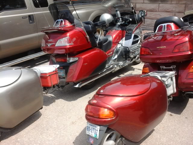

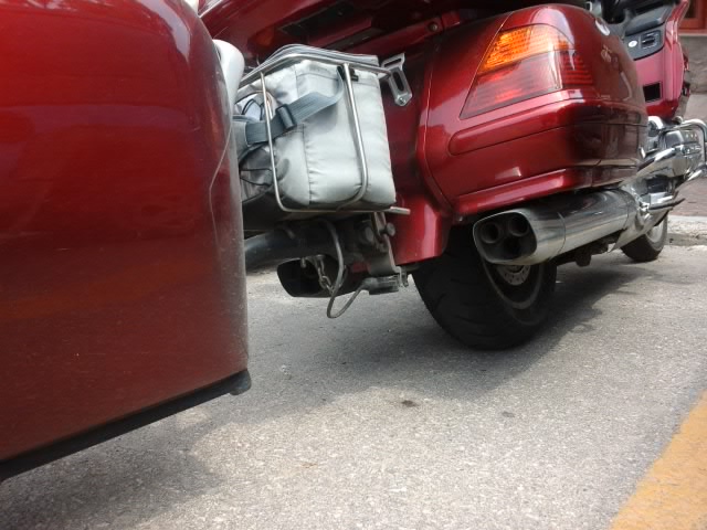

cowpuc Posted July 12, 2014 #17 Posted July 12, 2014 Dont know nuttin about pulling no trailer with a bike BUT everybody and their brother has been hounding me to give it try.. TxSturgis suggested trying a single wheel trailer and that got my attention.. He also mentioned a different apparatus replacing the traditional ball on that setup.. Because of this, I started watching for such an arrangement as such and got a chance to see one in Dead Wood this year.. I snapped a few photo's and tried to get one of the attaching device,, it appears as TX had mentioned,, to be along the order of a Universal Joint connector.. Might,, or might not, be something to consider even for a two wheeled trailer..

Guest tx2sturgis Posted July 13, 2014 #19 Posted July 13, 2014 cowpuc said: I snapped a few photo's and tried to get one of the attaching device,, it appears as TX had mentioned,, to be along the order of a Universal Joint connector.. Might,, or might not, be something to consider even for a two wheeled trailer.. A universal joint hitch is for single wheel trailers only....it won't work with a 2wheel trailer...

Flyinfool Posted July 13, 2014 #21 Posted July 13, 2014 (edited) cowpuc said: Dont know nuttin about pulling no trailer with a bike BUT everybody and their brother has been hounding me to give it try.. TxSturgis suggested trying a single wheel trailer and that got my attention.. He also mentioned a different apparatus replacing the traditional ball on that setup.. Because of this, I started watching for such an arrangement as such and got a chance to see one in Dead Wood this year.. I snapped a few photo's and tried to get one of the attaching device,, it appears as TX had mentioned,, to be along the order of a Universal Joint connector.. Might,, or might not, be something to consider even for a two wheeled trailer.. As mentioned the universal joint type is for single wheel trailers only. The purpose of the U-joint is so that the trailer will always have the same lean as the bike. This would prevent you from leaning into a corner. I have the one from MC Hitch. It has pulled with no issues for 3 years now. I even got to try out the swivel feature a couple of weeks ago at Orlins MD. It had recently rained A LOT. When I parked the bike upon arrival, before I could get my side stand plate out the stand sunk and over she went. The swivel did its job and allowed the bike to lay down with no stress to the hitch or the tongue. I am not sure if I also tried it out a couple of years ago when I dragged the foot pegs in an emergency maneuver. IronMike said: The one from open road outfitters is the only one I can find too. The other link shows sold out. I'm wondering if that is the recalled version. I kind of wish this was on the drawbar so that anything you towed had the feature. This way you have to buy one for every trailer. Seeing how it is made, It would not be very difficult to incorporate a swivel into a 1-1/4 stinger. The stinger will just end up about 6 inches longer. OK, now your in trouble, my gears are grinding.......... Edited July 13, 2014 by Flyinfool
