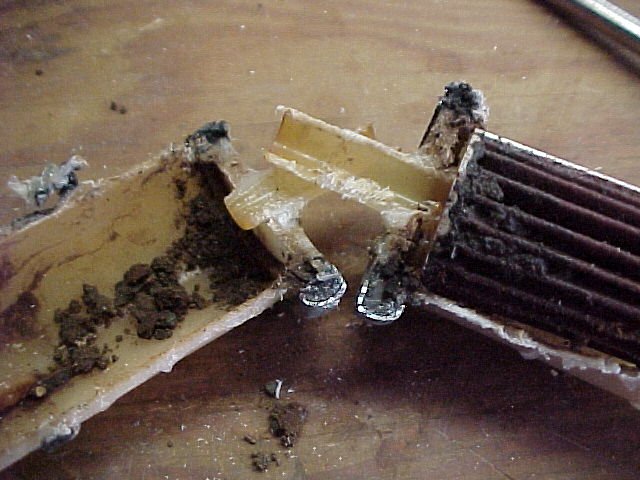

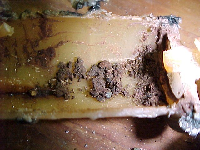

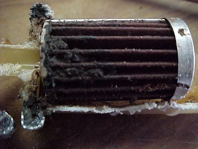

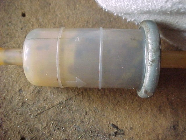

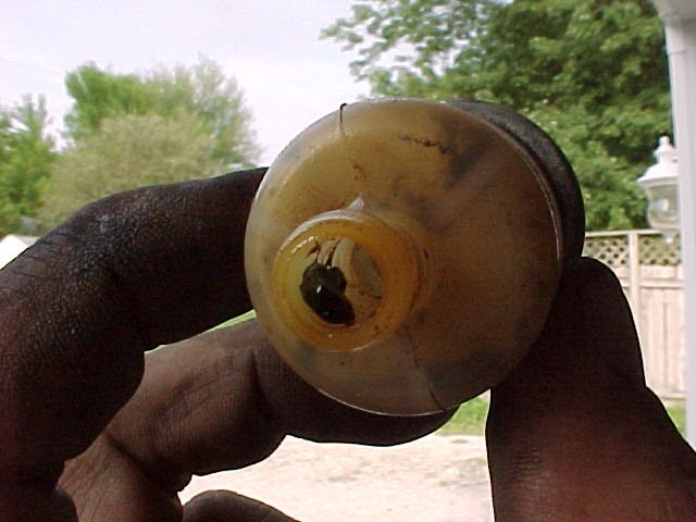

Here is a picture of my first Filter change about 4 months
Before the ETCH Process http://www.venturerider.org/kreem/thumbnails/1.jpg http://www.venturerider.org/kreem/thumbnails/2.jpg
http://www.venturerider.org/kreem/thumbnails/3.jpg http://www.venturerider.org/kreem/thumbnails/4.jpg http://www.venturerider.org/kreem/thumbnails/5.jpg

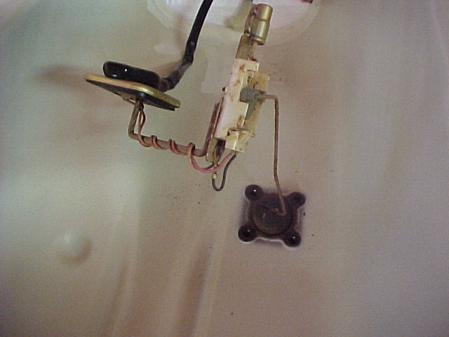

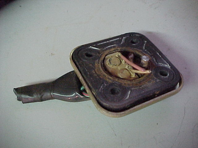

#5- Remove the Sender
(most likely it will be rusty) http://www.venturerider.org/kreem/thumbnails/6.jpg
Mine was always reading (NOT FULL) every time I filled
it up.... should have been my first sign! So I order a new
one at Yamaha the part # is 4XY-85752-00 and the cost is around $56.00 .

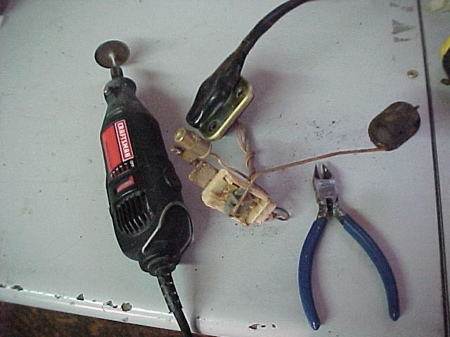

#6- Take that old sending unit and HACK it up!
with a dermal and a pair of cutters http://www.venturerider.org/kreem/thumbnails/7.jpg what you want to end up with is this

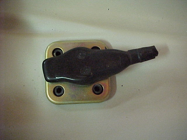

http://www.venturerider.org/kreem/thumbnails/8.jpg this will be your first (PLUG)

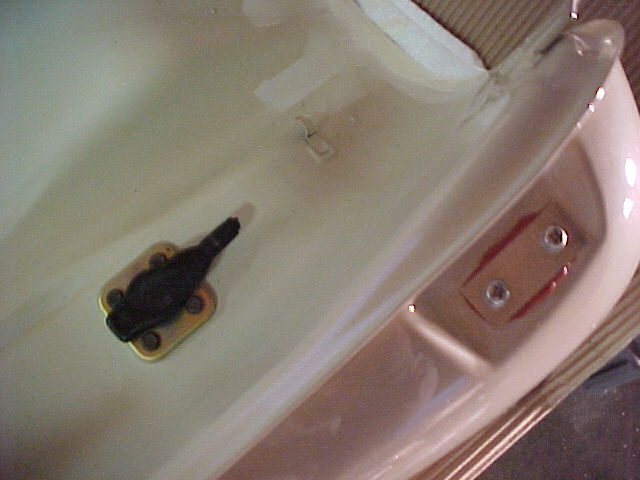

Then you will place that part (the old sender) over
the hole http://www.venturerider.org/kreem/thumbnails/9.jpg and bolt it on!

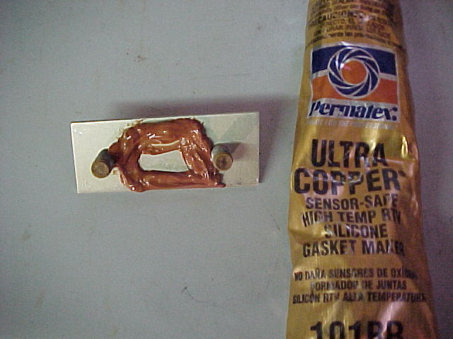

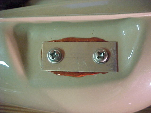

#7- Now remove the fuel pet-cock and make a plate and bolt that on
with the same screws that hold the pet-cock on. Use some gasket
sealer or make a rubber gasket.. http://www.venturerider.org/kreem/thumbnails/10.jpg http://www.venturerider.org/kreem/thumbnails/11.jpg
