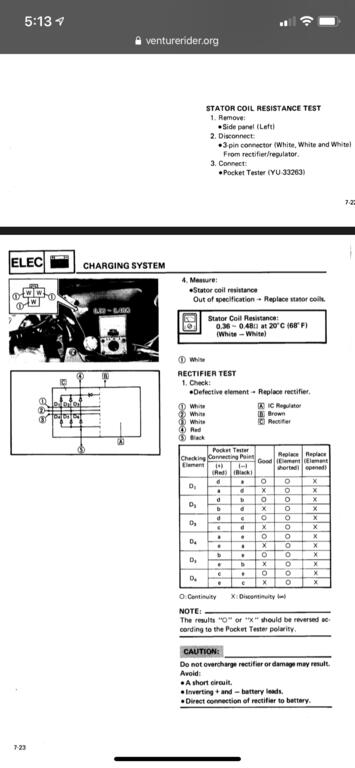

Pasta Burner Posted May 16, 2020 Posted May 16, 2020 (edited) so I can’t make heads or tails of what the service manual wants me to test. Those connections don’t seem to exist. I used the testing method described in this thread https://www.venturerider.org/forum/showthread.php?37884-rectifier-bench-test&highlight=Rectifier+test and everything checks out mostly ok. Using a digital meter in the diode mode two wires consistently measure the same and the other is .003 off. Is that enough to make a difference? Also the connector gets too hot to handle, is that normal? Here is a pic from the service manual, If someone can explain where connection a-e is that might help. As far as I see there are only three white wires. Edited May 16, 2020 by Pasta Burner

cimmer Posted May 18, 2020 Posted May 18, 2020 so I can’t make heads or tails of what the service manual wants me to test. Those connections don’t seem to exist. I used the testing method described in this thread https://www.venturerider.org/forum/showthread.php?37884-rectifier-bench-test&highlight=Rectifier+test and everything checks out mostly ok. Using a digital meter in the diode mode two wires consistently measure the same and the other is .003 off. Is that enough to make a difference? Also the connector gets too hot to handle, is that normal? Here is a pic from the service manual, If someone can explain where connection a-e is that might help. As far as I see there are only three white wires. the manual doesnt give the proper location to test the diodes. Looking at the drawing and the chart it should be.. d = Red Wire a = White wire 1 b = White wire 2 c = White wire 3 e = Black wire. What that test does it to verify that the diodes in the rectifier are good. If the connector is getting too hot to hold then there is corrosion in the connector and it either needs to have the terminals cleaned or the connector replaced. Some of us here have replaced the regulator with a more modern one that does a better job of charging the battery and supplying current to the electrical system also. Hope this helps.. Rick F.
