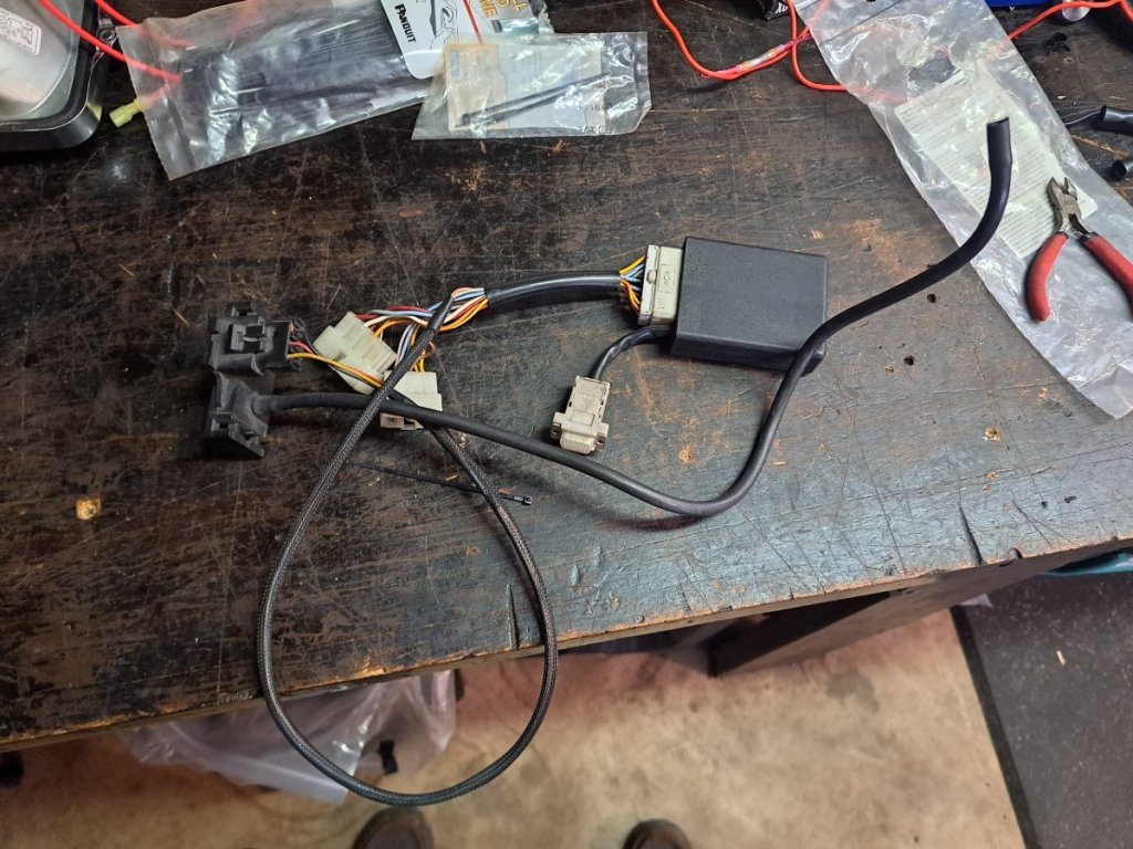

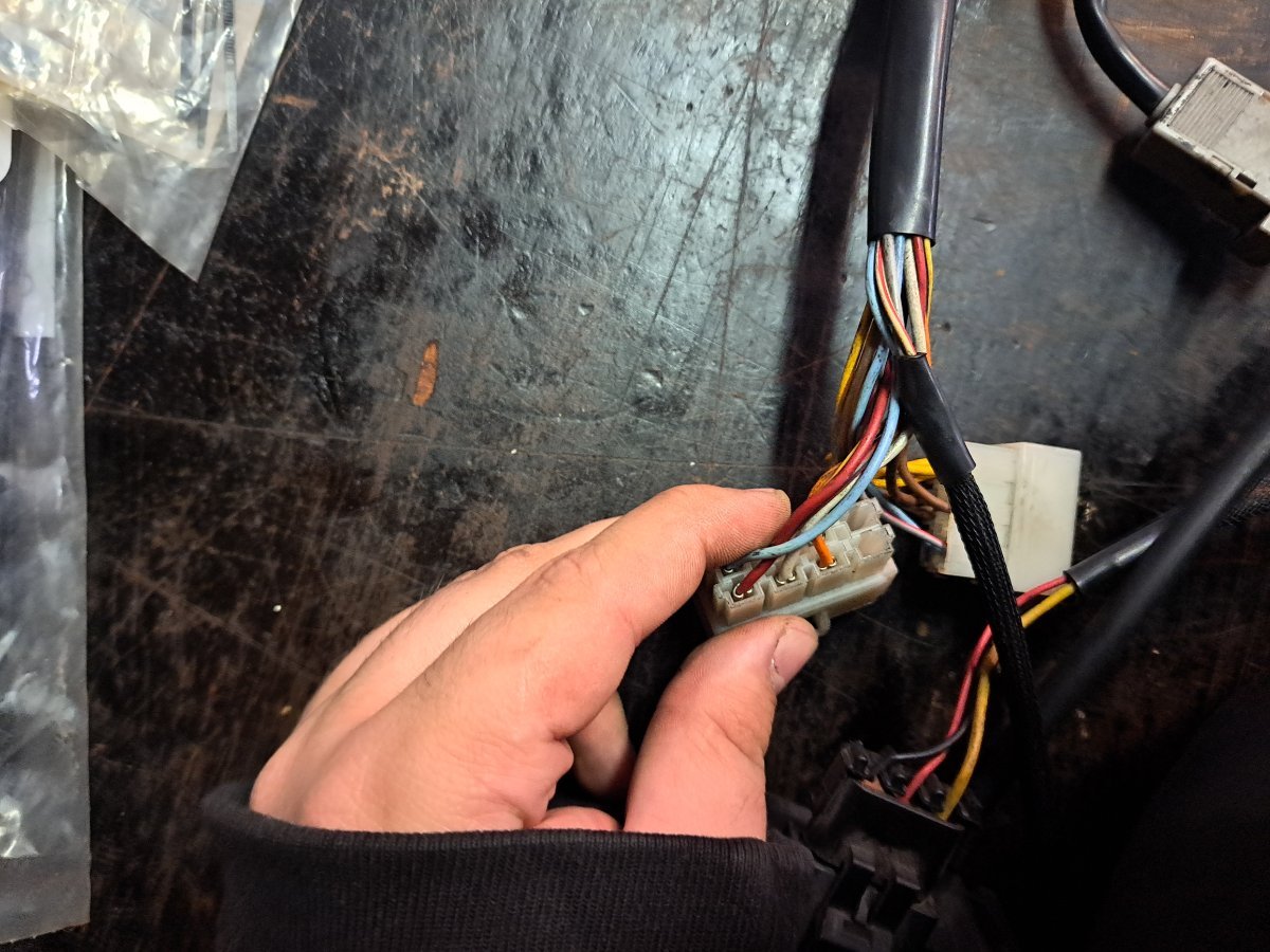

saddlebum Posted April 2 #3 Posted April 2 (edited) Post a pic of the ignitech box. The unit is more or less universal within reason It also depends what bike it came off of and therefore requires the correct programing for the bike involved. If you have the complete kit it should include a harness to connect to a laptop so it can be programmed for your bike. You should be able to download the correct file from ignitech. If not I may still have the files on my computer. With regards to testing your coils, there are shop manuals downloaded to the tech section on this site. Check and clean all the connections even if they look clean and make sure there is good drag and tension on your connector terminals by using a terminal of the correct size. I almost replaced a perfectly good cdi unit once and ended up not needing to after cleaning all the connections. Also check the harness connections going to your stator on the left side of the bike. Edited April 2 by saddlebum
NotAliasing Posted April 3 Author #4 Posted April 3 On 4/2/2025 at 1:26 PM, saddlebum said: pic of the ignitech box Expand See attached. All connectioms are clean and steady to the stator and to the pickup coils and to the ignition coils. I get 9.8V to the ICM while cranking, my pickup coils generate a good voltage signal and ohm out fine. My spark plug wires all ohm within spec. I think im pretty much narrowed down to the ICM. Ill try and see if i cant reprogram the one i have. I also dont know if spending a long time off the bike could kill these ignitech units, either.
