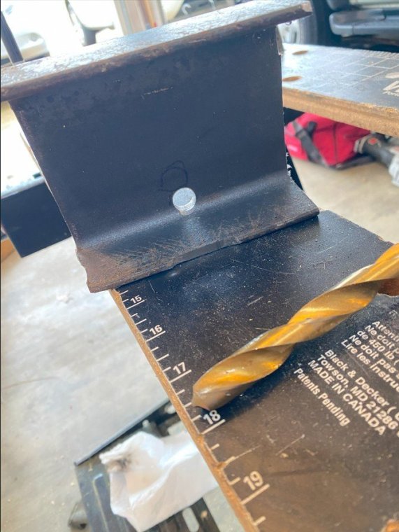

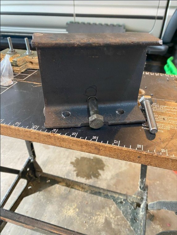

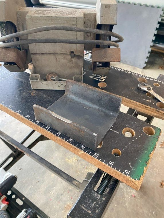

Fabricating the expansion tool.  So this piece of steel channel stock was cut from a 6 foot length I found laying in the middle of a street about 15 - 20  years ago.  You never know when you might need a chunk of channel stock, right?
Shock bolt will go thru this hole.
Pusher bolts will go thru the two smaller holes.

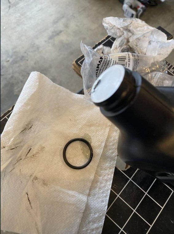

Lube the new O ring.
Carefully slip the new O ring over the clevis and down onto the collar at the base of the shock.

Old O ring.
